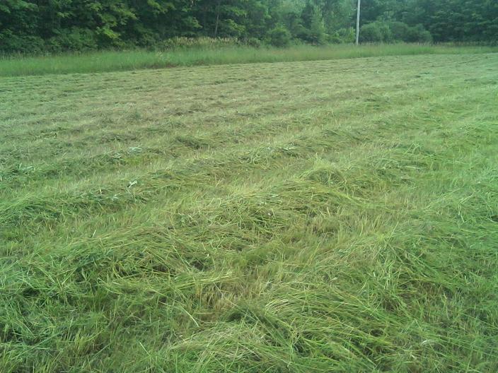

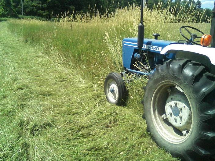

Here is some pics of what I mowed outside of the pasture. You can see the hay is much heavier. In the one pic it is clearly 6-7' tall in some spots.
Also a pic of the windrows from brushhogging the thicker hay outside of the pasture.

Drying times will be much slower outside of the pasture too. Being much thicker I can tell just feeling it that it's going to take probably an extra day to dry.
