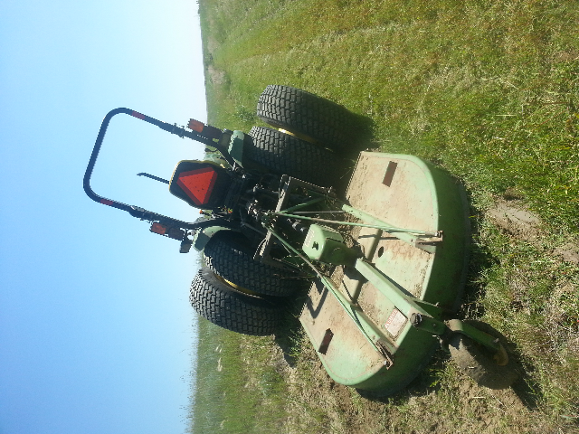

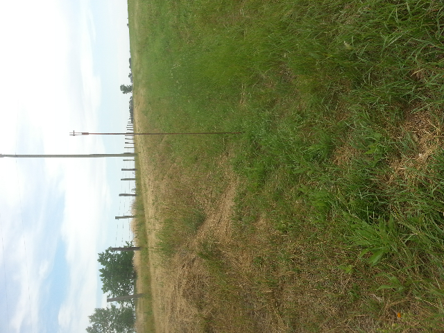

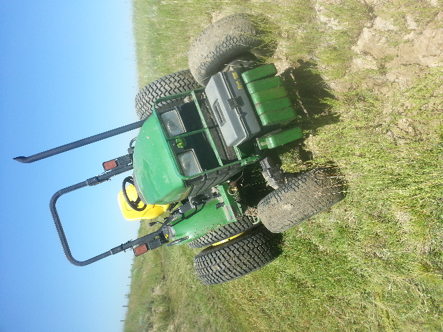

ForumRunner_20140728_180345.pngForumRunner_20140728_180254.pngForumRunner_20140728_173704.png
I'm not sure how to get the pictures to sit right side up but this is how I mow ditches, The last picture is of a rod poked into the ground to give an idea of how steep a slope that can be safely mowed.
It works quite well and wasn't expensive. With freight the duals were about $600.
Every couple of years I get paid to mow about 5 miles of ditch with this setup.

Cool machine, but I dont see how that solves the problem of the banks of the ditch. Seems like it might be even more top heavy than a push mower.
The main advantage is that the mower sickle sticks out far enough in front that I can mow down the bank a ways while standing on the lawn and the sickle will cut cleanly through woody stuff where a regular mower just chowders it up and a string trimmer gets all wrapped up in it.
The large diameter wheels make it easy to manage too.
Perfect it's not, but it's WAY better than nothing and the price was right. :p

View attachment 433533View attachment 433534View attachment 433535

   / Mowing Ditch Banks #57
Interesting, where did you buy them?
I bought the tires and rims on eBay. The spacers were metal I had bought for something else and never used. The bolts to hold them on were about $75. I just use a large one inch bolt in the center to hold them on. I did have to eventually go to a reverse thread bolt on the right side as it was difficult to keep tight.
Please describe your setup. From the pics, I can't tell what the machine is.
