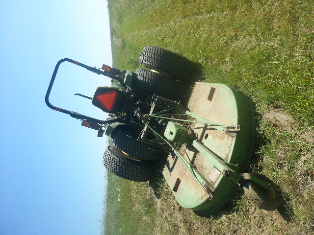

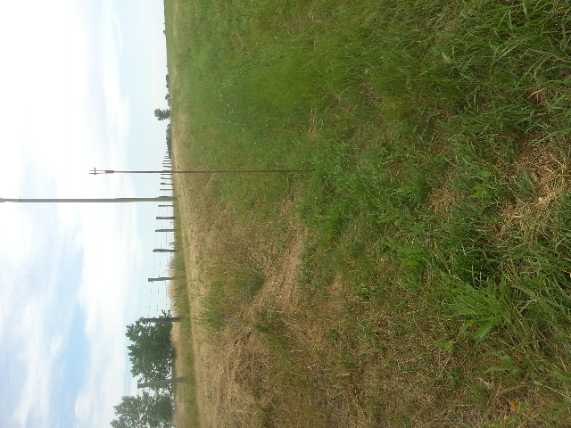

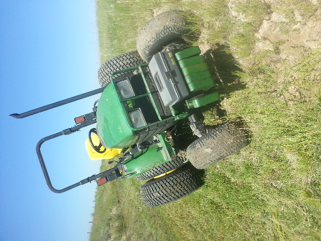

ForumRunner_20140728_180345.pngForumRunner_20140728_180254.pngForumRunner_20140728_173704.png
I'm not sure how to get the pictures to sit right side up but this is how I mow ditches, The last picture is of a rod poked into the ground to give an idea of how steep a slope that can be safely mowed.
It works quite well and wasn't expensive. With freight the duals were about $600.
Every couple of years I get paid to mow about 5 miles of ditch with this setup.

Nice Rig!
Around here, we wouldn't call that a ditch tho. That's a swale.
My ditch banks are all well over 50% grade and near vertical in spots.

Interesting, where did you buy them?
I bought the tires and rims on eBay. The spacers were metal I had bought for something else and never used. The bolts to hold them on were about $75. I just use a large one inch bolt in the center to hold them on. I did have to eventually go to a reverse thread bolt on the right side as it was difficult to keep tight.

Please describe your setup. From the pics, I can't tell what the machine is.
