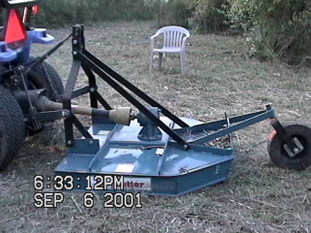

Your right! King Kutter is better value for the buck. I have the 48" model. It has I beam constuction on the sides and is very strong. I beat mine and its holding up well. It even came through painted blue...now thats a real plus as far as im concerned. Its heavey too. works great for rear weight when i use the loader.

I had to cut 2" off my shaft and the same with the shield. I took it to work and used our power hack saw.....BUTTER. It went on without cutting it, but when i came onto hilly ground it wanted to bottom out with it self.
