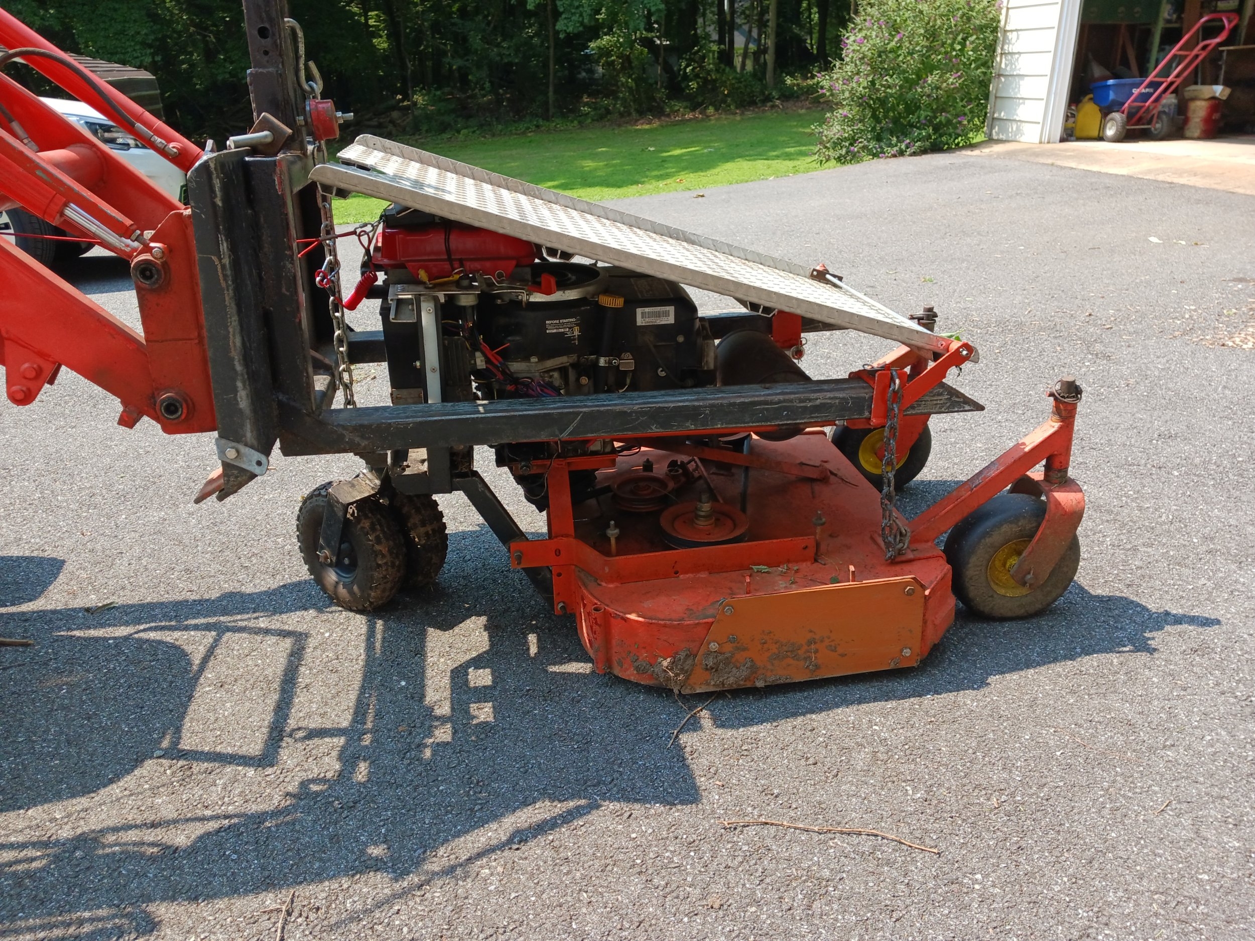

I built a mini brush hog mounted on the fel of my Kubota. It is a Toro 36 inch 2 blade deck, driven by a Kawasaki FC420v engine. It works great except sometimes it "squeals like a stuck pig" when the blades are engaged. All moving parts are fine on the mower. I spun the spindles up with a drill, tried a new electric clutch and the idler pulley bearing is smooth and quiet. The strange part is it will be fine for a while, then squeal for a while. Nothing ever gets hot, just makes an awful sound. Sure would like to fix it!

So the question is what is seizing I'd guess. It would be interesting to see a pic of your set up here.

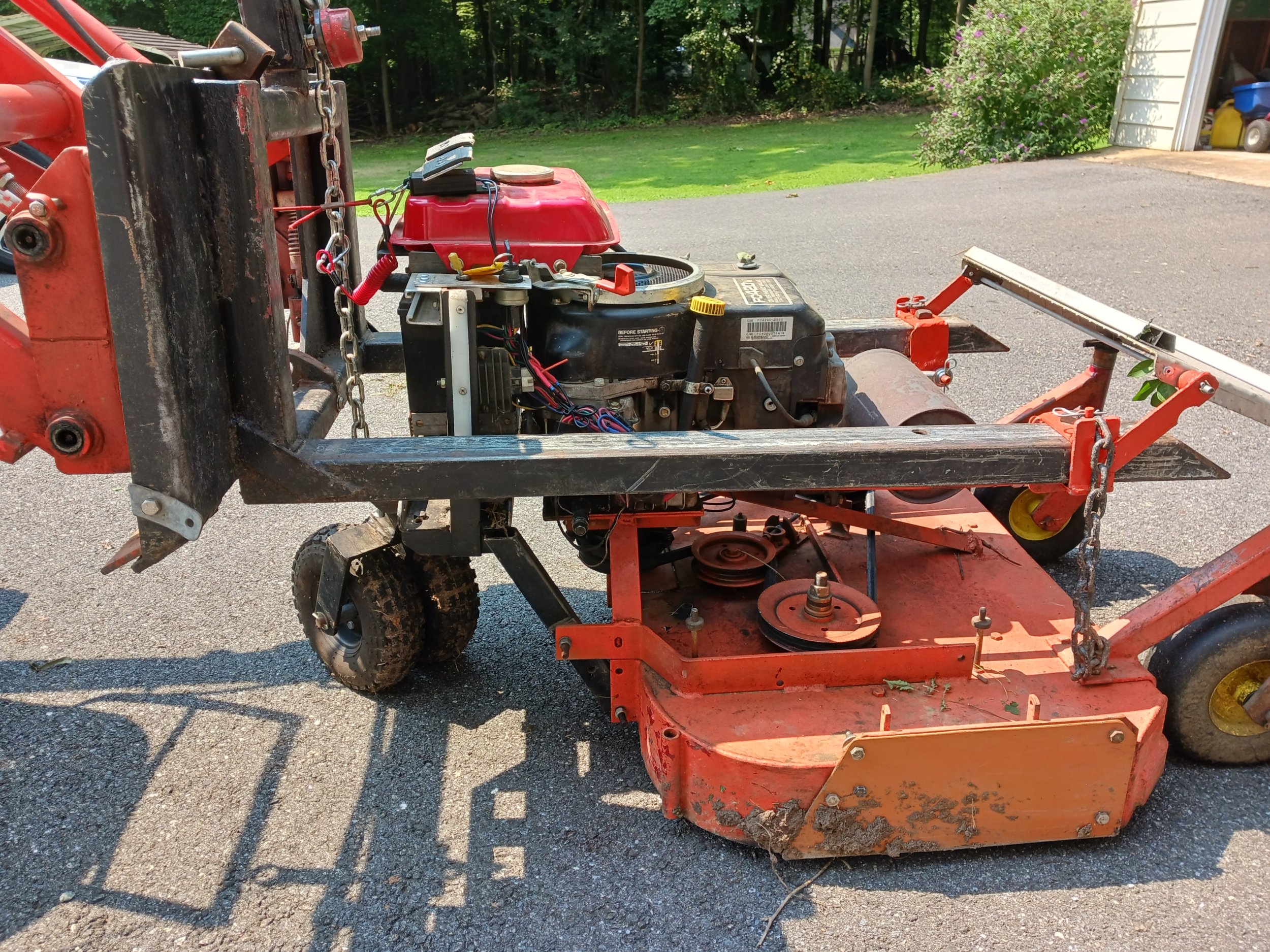

Is the belt the right size for all your pulleys? from the pics, it looks like only half the belt is engaging, & that looks shiny like it's been slipping. PTO clutch pulley smaller than deck pulleys?

What are the size of the blades? Could it be the blade tips syncing and rubbing then unsyncing again?
Even if the right size, a non-concentric center hole, or slop in the hole or spindle would also allow it to happen.
The spindle pulley we can see doesn't look mounted normally.

The blades are the correct size and not interfering with each other. The spacers stored on top are for setting the blade height.

Any good pics of the belt drive from the top? From here, the location of your tension / adjuster pulley doesn't seem ideal to me. It is very close to both the spindle and drive pulley. Your only option this way is to stress the belt and draw it too deep into the vee. Do you also have a spring tension pulley in the drive?

Because of the layout of engine and pulleys I can't get a good picture. Anyway the sound it makes is not belt slippage, it sounds like metal to metal. Next time it does it I might let it run and see what fails!
