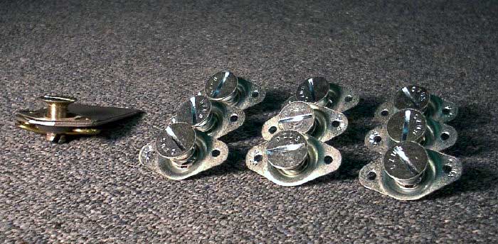

Aircraft Spruce carries Dzus fasteners
Leaving my covers off,
Sedgewood
/ Mower deck spindle #10
I've attached a photo of some Dzus fasteners.
-Rob /forums/images/graemlins/grin.gif

Here's a link to the manufacturer's website. Dzus Fasteners
They have a nice little 'calculator' that will help you pick the right fastener/retainer. Does anyone know the correct information for the PT425? If so, you can run the calculator and let the rest know what sized fasteners we should get! I've already done the maintenance 3x, and think this would be a GREAT mod!

The dzus fasteners that I would like to someday put in will be slotted head like a standard screw(see Smartguyz attached picture). All it will take is a 1/4 turn with a stubby screwdriver and they will release. I became familiar with them when I worked at the airport. They are popular on aircraft engine cowlings. But they can be a little pricey. Still, just click, click and click and the inspection plate is off! Pretty cool fasteners. /forums/images/graemlins/grin.gif
/ Mower deck spindle #15
mr, the only thing wrong with the dzus fasteners is they have to go into a open area plus the large hole for the receptacle.this area is the deck and is exposed to grass ond dirt and flying stones,i don't think they where made for this.

<font color="blue"> the only thing wrong with the dzus fasteners is they have to go into a open area plus the large hole for the receptacle.this area is the deck and is exposed to grass ond dirt and flying stones,i don't think they where made for this </font>
I agree that the deck would be a bad location for Dzus fasteners. What I was speaking of was the inspection covers on the tunnel between the operators' legs to get to the treadle pedal grease points /forums/images/graemlins/smile.gif
