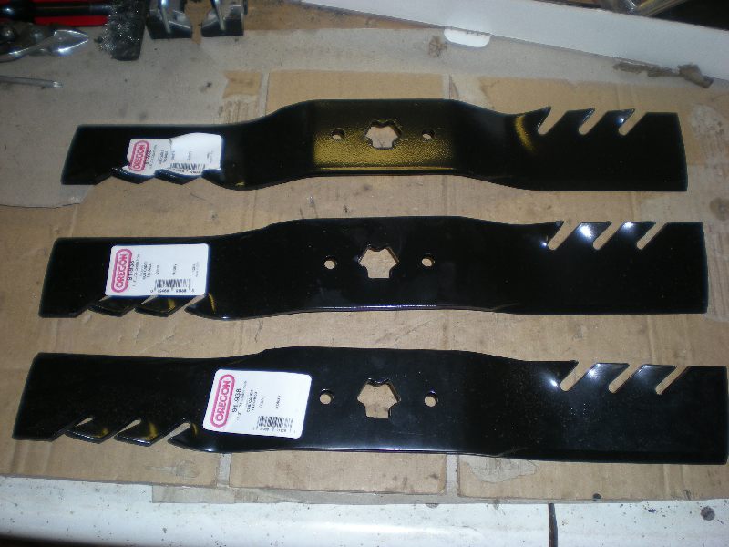

Carl, personally I don't think a socket head would work better than a standard hex-head bolt. At least with a hex-head you can try to use open end wrenches to remove them once they get buggered up from hitting things. Once you bugger up a socket head, you're left with no flat sides to get a grip on, and have to use something like vicegrips or pipewrenches to take them out...
I think the only real long term solution would be a "gull-wing" type of blade where the cutting surfaces of the blades are lower than the stumpjumper hub and bolts that hold the blades on...
I couldn't agree more. Now somebody find a gull wing blade that will fit, and I will buy it in a heartbeat. JJ?

I think the only real long term solution would be a "gull-wing" type of blade where the cutting surfaces of the blades are lower than the stumpjumper hub and bolts that hold the blades on...[/QUOTE]
I wonder if a blacksmith could modify a blade to turn in into a "gull-wing". It would shorten the blade a little, but it might be worth it. Also you would have to make them identical to minimize vibration. You could lengthen the blade back out by thinning the end a little.

   / Mower Bolt Idea #10
Could something like this be cut down and made to work?
