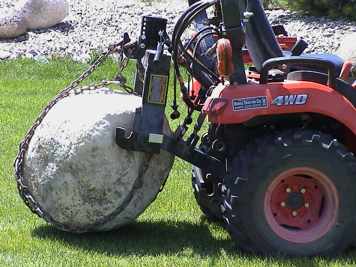

I have moved many rocks that weighed to much for the loader by using using the 3 point
Using the 3 point to lift and drag the rock can flip the tractor over backwards. The ROPS would stop it from fully flipping but that rock would end up where your back, neck and head should be. I would not try it.
