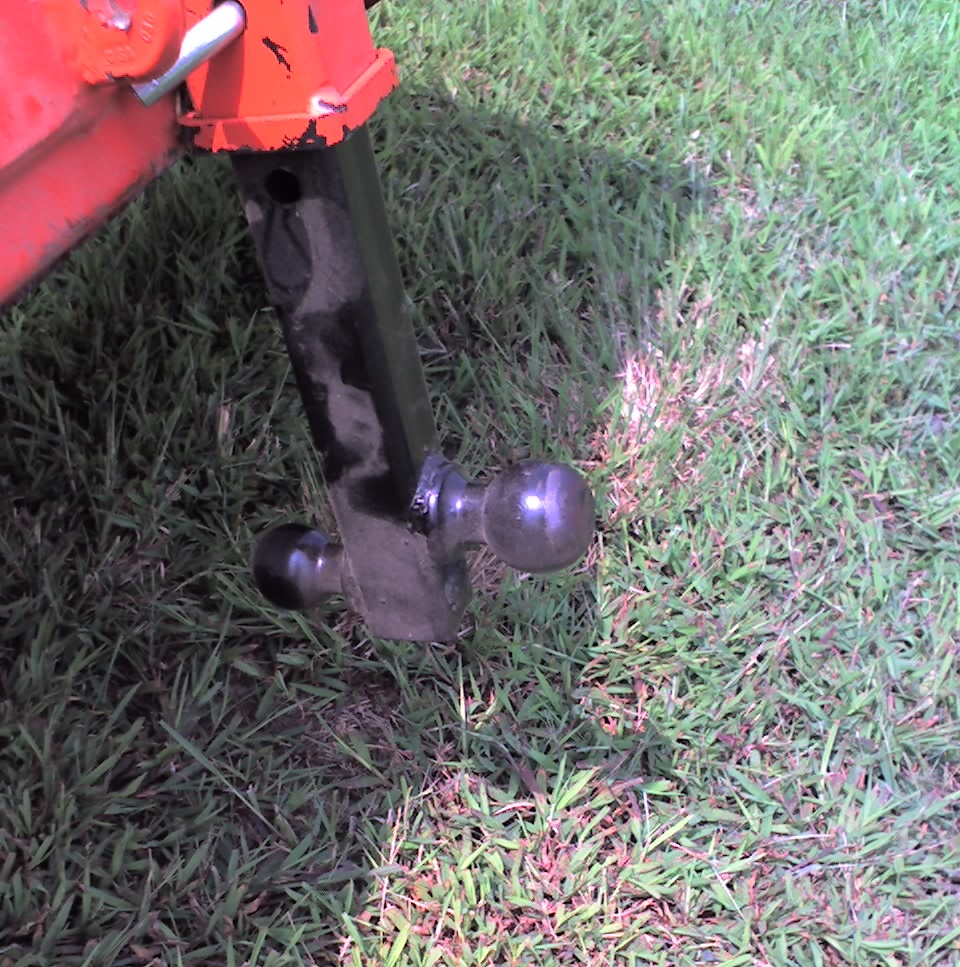

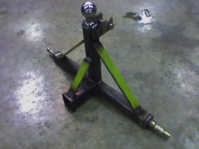

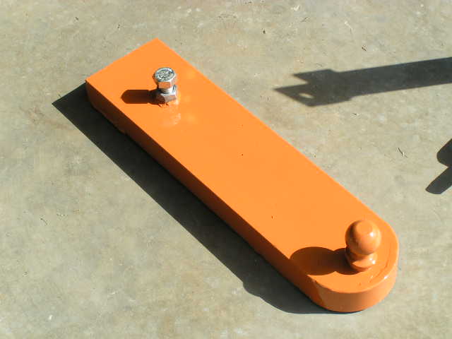

When in one of the barns I use an attachment I made for my forklifts to move GN trailers. Outside and off concrete areas I use the hitch I put on my loader bucket. As long as you don't get in a hurry and leave your landing gear down I don't think you'll have a problem. Here is just something I did. Maybe it will give you some ideas. It works for me. The last picture is what I made to clamp on the forks of my forklifts. I didn't want to burn a hole in the forks like I've seen people do.
I almost forgot. It's not as convenient using the 3 pt. hitch, but it's certainly easier than using your truck; at least in my opinion. Here is what I built to use if I have to do the 3 pt. hitch method in the 5th picture.

If you get a 3 pt hitch like Dargo has (pic) that should work fine for moving your trailer just put some counterweight in your loader bucket.
