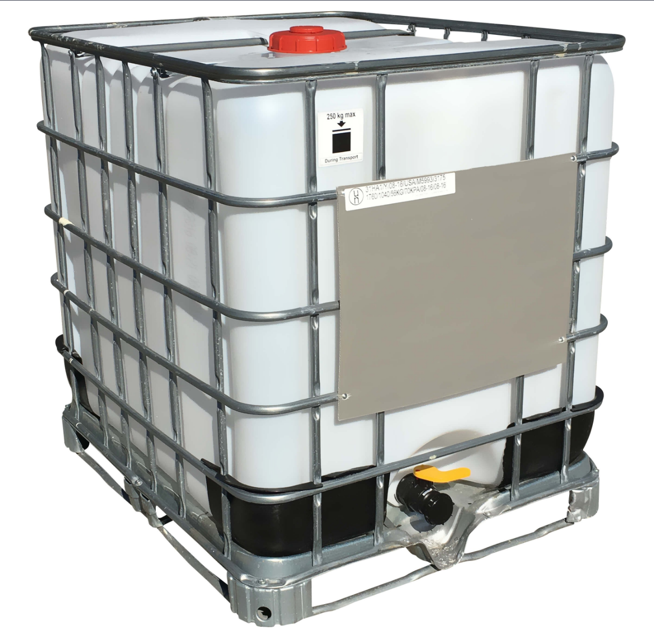

I've got a Kioti DK6010Se (60kp) and happened to find several plants, we wanted to eventually plant, for 50% off at Home Depot. Now, they are going to be planted on land we are clearing. No well or water source yet on the property. I was thinking I could get something like this which would be easy enough to move around with pallet forks for watering but what would be the best way to get that water out of the tank? They must make something that would do the job. Thoughts?

They make plenty of pumps, usually 12v.
But if your going to lift it with a FEL you might get by with a thick hose and off a spigot.

My friend gravity. It's free. Hadn't thought about that but you are probably right. That's why I ask the questions here. I usually miss something that is obvious. I guess if I had to disperse water over a large area then I would need a pump/sprayer of some sort but that is not what I am looking to do.

Yeah just get yourself a 25-50' garden hose, and then bush down fittings from the bottom valve port until you can attach the hose. Drive tractor close but uphill from where you need to water, then the hose allows you to reach a bit without having to reposition the tractor a bunch of times. Just watch for tipping from all that weight. Keep it on the flat or point straight up hill, never cross the slope, when you raise the tub up.
