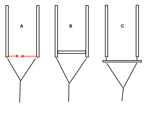

You need a brace between skids, or a spreader bar, to keep them from being pulled together.

I dragged my 6x10 foot chicken coop 1/4 mile on 2 skids, each made of (2) 2x6's nailed together. I nailed 2x6 cleats between the skids on front and back of the building similar to what BCP shows above, except that mine were on top to keep the building from sliding forward or backward.
If you have the material and skills you might weld a couple of brackets to go between the skids.
Then just take it slow and easy. If something doesn't look right, stop and reassess.

As bcb already said you’ll need a spreader bar to prevent the skids from getting ripped off.

Good call on spreader bar. I forgot about that.
This shed has double 2x8 or 2x10s on each skid and has 4 of those. There is one on the outsides and then one like 18"s inboard of those.

Yeah that's wife and or neighbor will be the roller recyclers. This is the plan I think I will use. It was my first thought. I am glad the spreader bar was mentioned, as I had not thought about that but seen it done before. My neighbor has some piles of stuff laying around, he may have some old fence posts even.

View attachment 595175 One of my out buildings is a log cabin. 16' x 24'. It was constructed in 1955 down at the far end of my little lake. When we moved down here from AK - we wanted to relocate it up near the house. I tried a skid system like bcp shows in post #2. It would not budge - even using the neighbors big IHCase monster.
