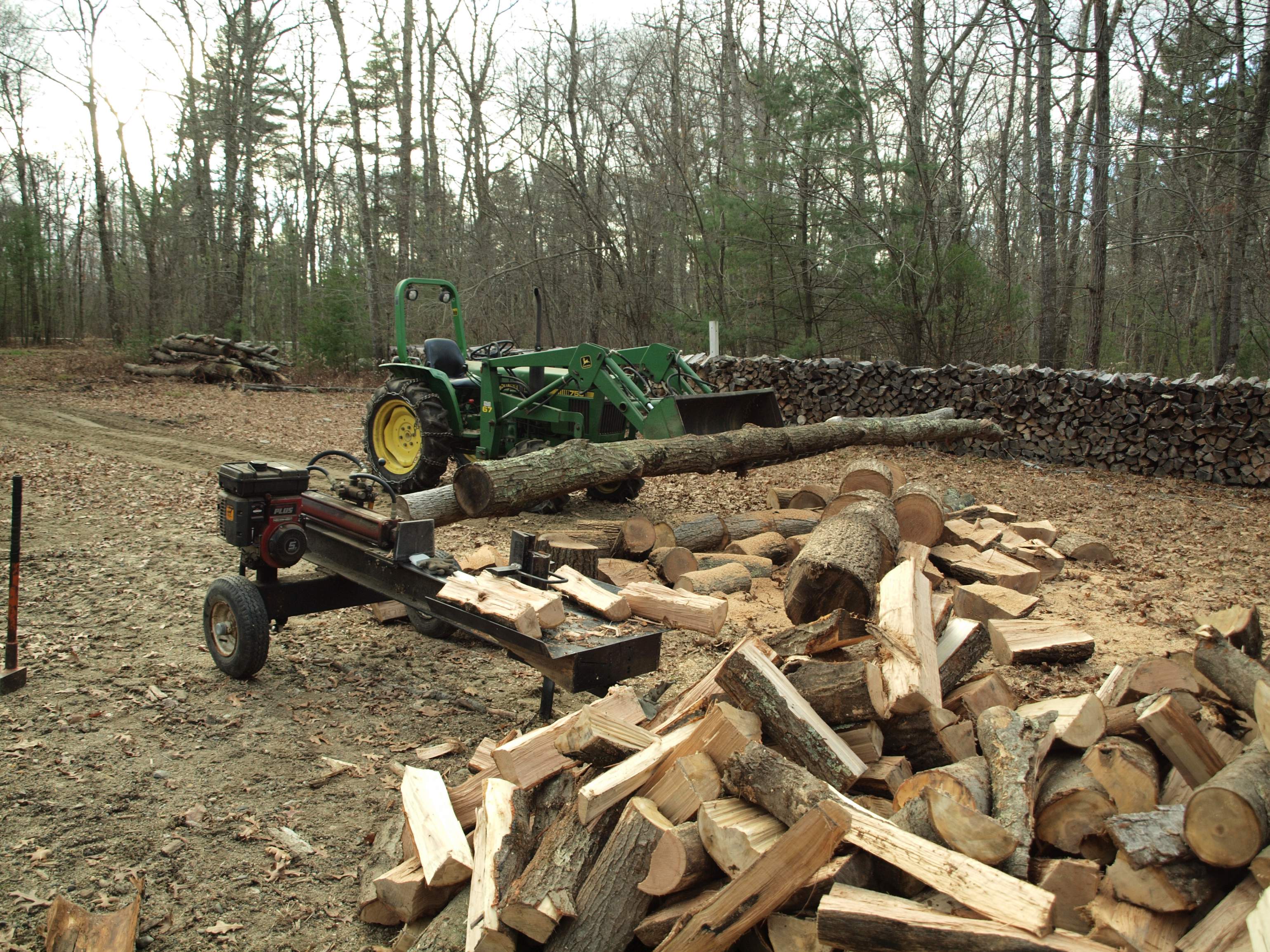

Your machine negates all the bad things I am doing to my tractor in this photo. I need to stop moving wood this way to the processing area and use a 3 pt carrier or something for the back of the tractor as that is where its strength is much like where your machine has its strength.
