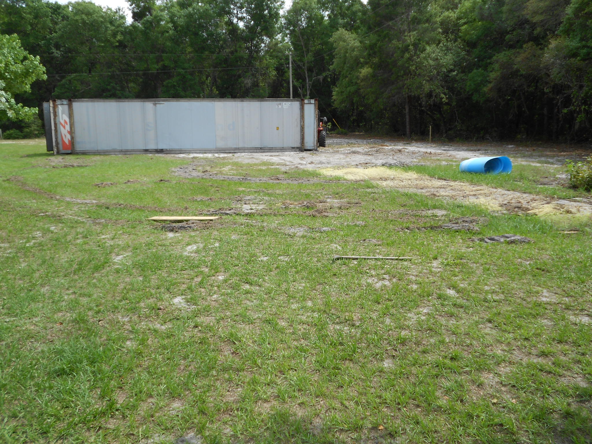

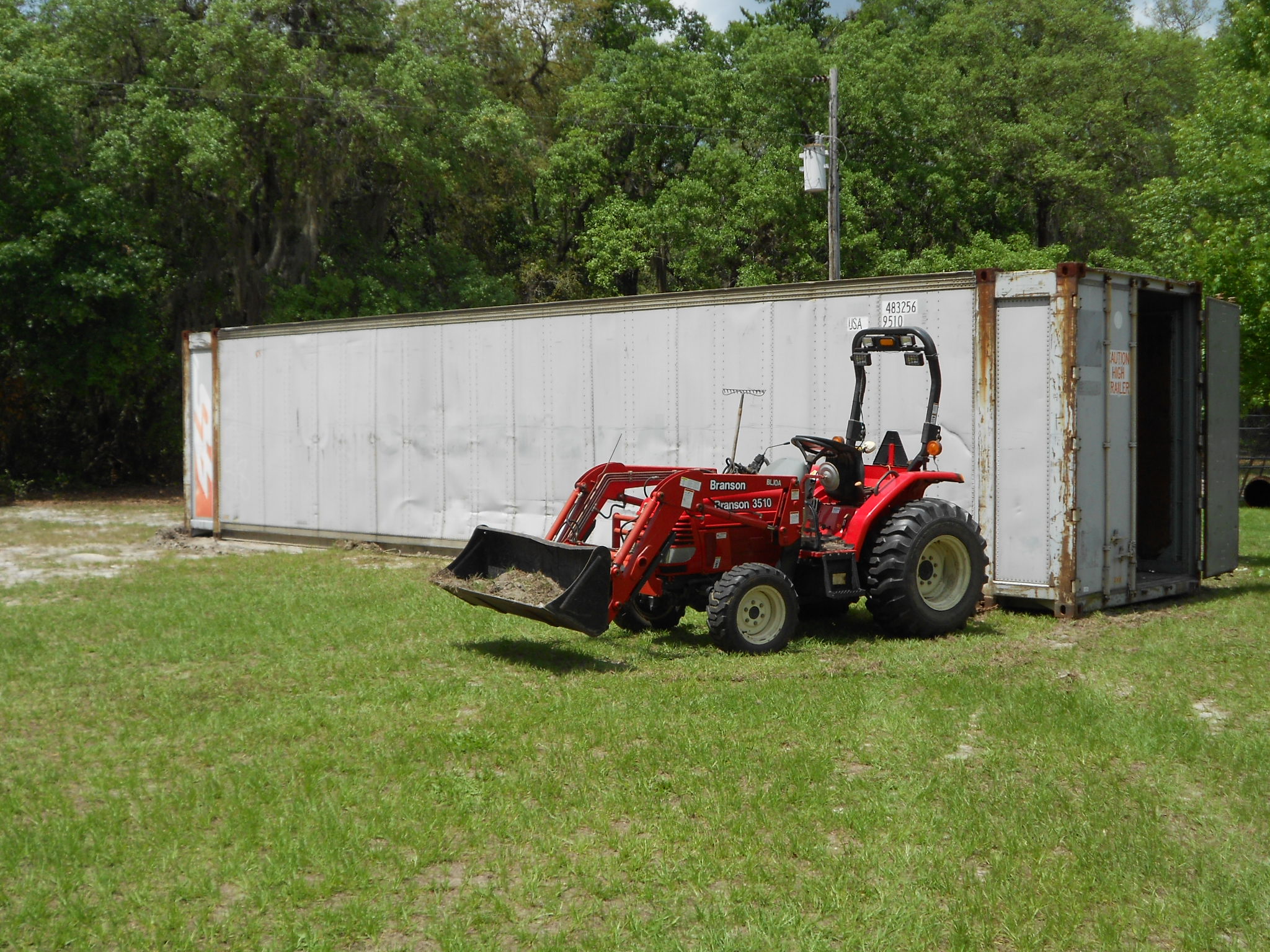

I moved my 45' container about 60' and turned it 90* so I could put my new 40' X 60' building where it sat.
I hooked onto a corner pocket with a chain and lifted with the 3 pt then dragged it going from corner to corner with my 35 hp Branson.
It was almost empty.

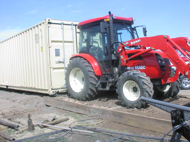

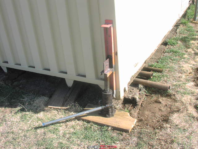

This is how I moved my 40' container.
First I built this tool to lift it.
Then I lifted the front and pulled in position.
