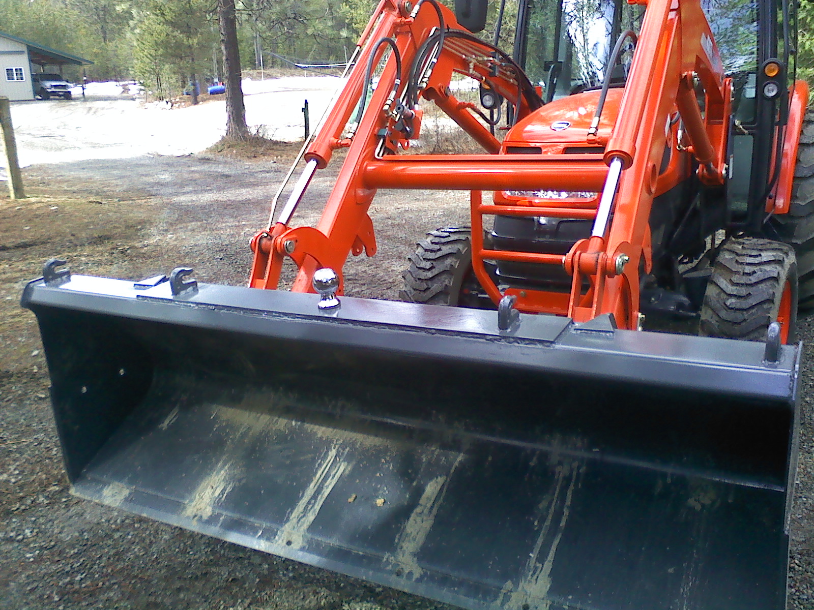

I just mounted a ball on top of bucket

on mine i added a welded on 1/4” plate so i can add some stronger hook points for chain attachments, then i drilled a 1” hole and added a 2-5/16 ball. I can move my 30 foot horse trailer very easily and maneuver it into shed.
the shed is only 5” wider than trailer, so have to be precise.

5th wheel trailers use a "kingpin" similar to a semi trailer. You may be able to fabricate a mount for the top of your loader bucket using a piece of flat steel with a piece of pipe welded to it as a socket for the "kingpin" to set in.

I move my 25' 5th wheel with my GC2610TLB frequently and use some dollies on the wheels to be able to park it close to a wall for winter storage inside. I have some adapters I made with a "cup" near the top edge of the bucket similar to the picture in post #12. but without the locking bolt. My trailer has pin weight of about 800# and my loader will lift it. I'm on level ground so don't worry about brakes. A neighbour needed to move his 5th after building a residence and didn't leave enough room to get a pickup attached. His was a 30' model and my tractor wouldn't lift the front until two men stood on the rear bumper and I was able to move it to a position where the truck could attach,
