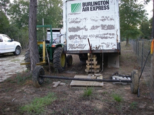

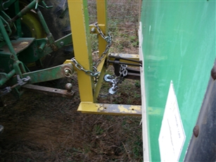

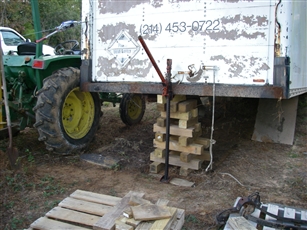

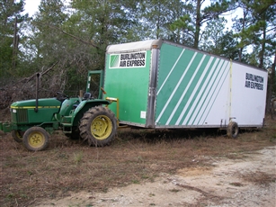

I just moved 4 of them...
Jacked them up, slid a mobile home axle under and strapped it on with a cargo strap, secured the towed end to my carryall with chains run thru some c-clamps...my little tractor had no problem...make sure you set the axle a little aft of the center of balance so you have a little weight on the tractor end...
Reverse the process at the receiving end...
Make sure you place a good baseplate under your jack, use cribbing to catch the load in case your jack slips (Lift and add blocks every time there is room to do so...), secure the side of the trailer to the tractor to keep it stable during the lift/lower process....ask me how I know.....
Be Safe-
T

The mobile home axle sounds great for containers. We've moved all kinds of small buildings up to 16 x 24 around by just jacking them up, putting 2 logs 8 - 10 " dia. slightly longer than the building, lagging or chaining spreaders tight to the front and rear of the building, then just dragging and pushing them around to wherever they had to go.
