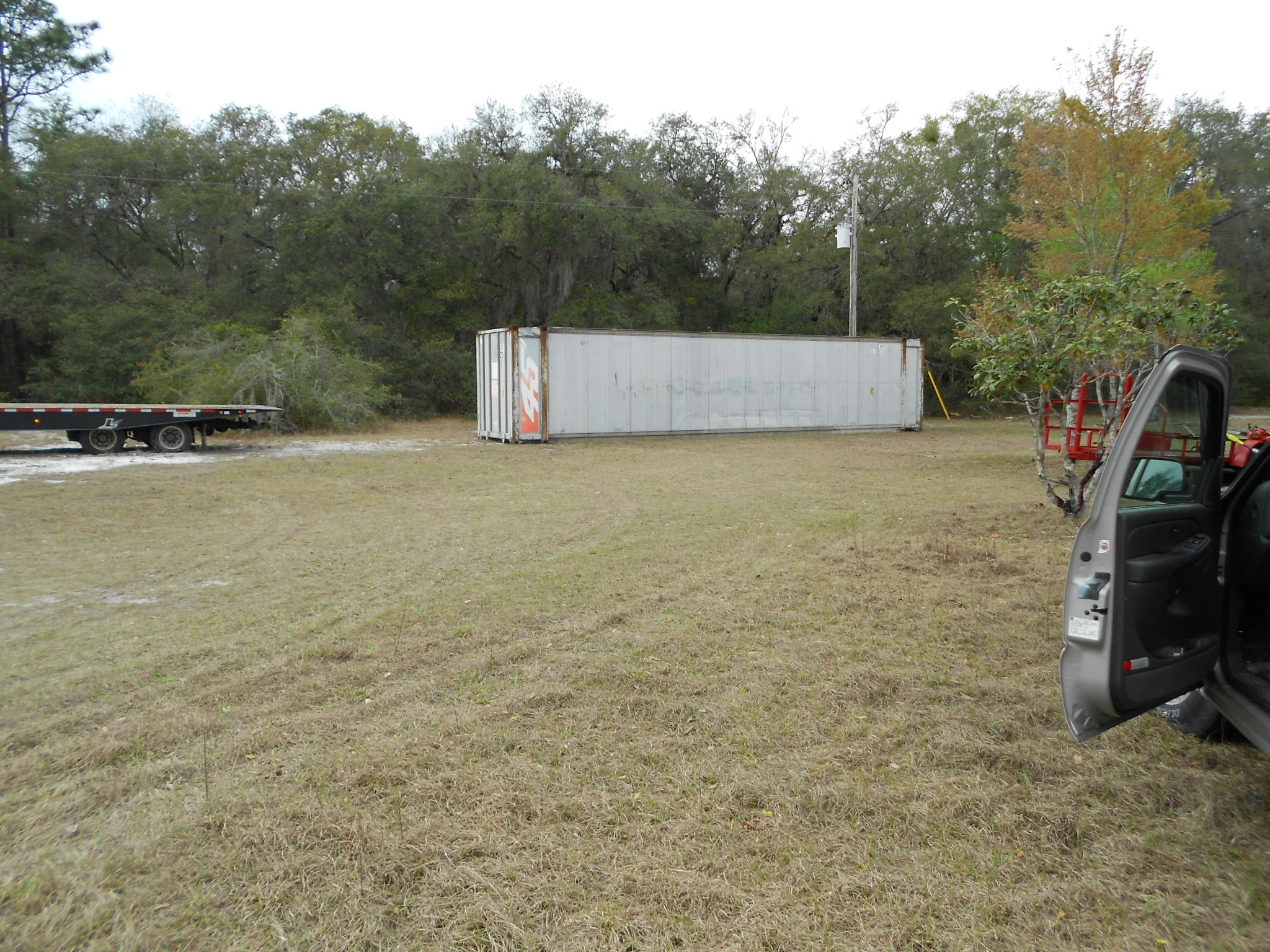

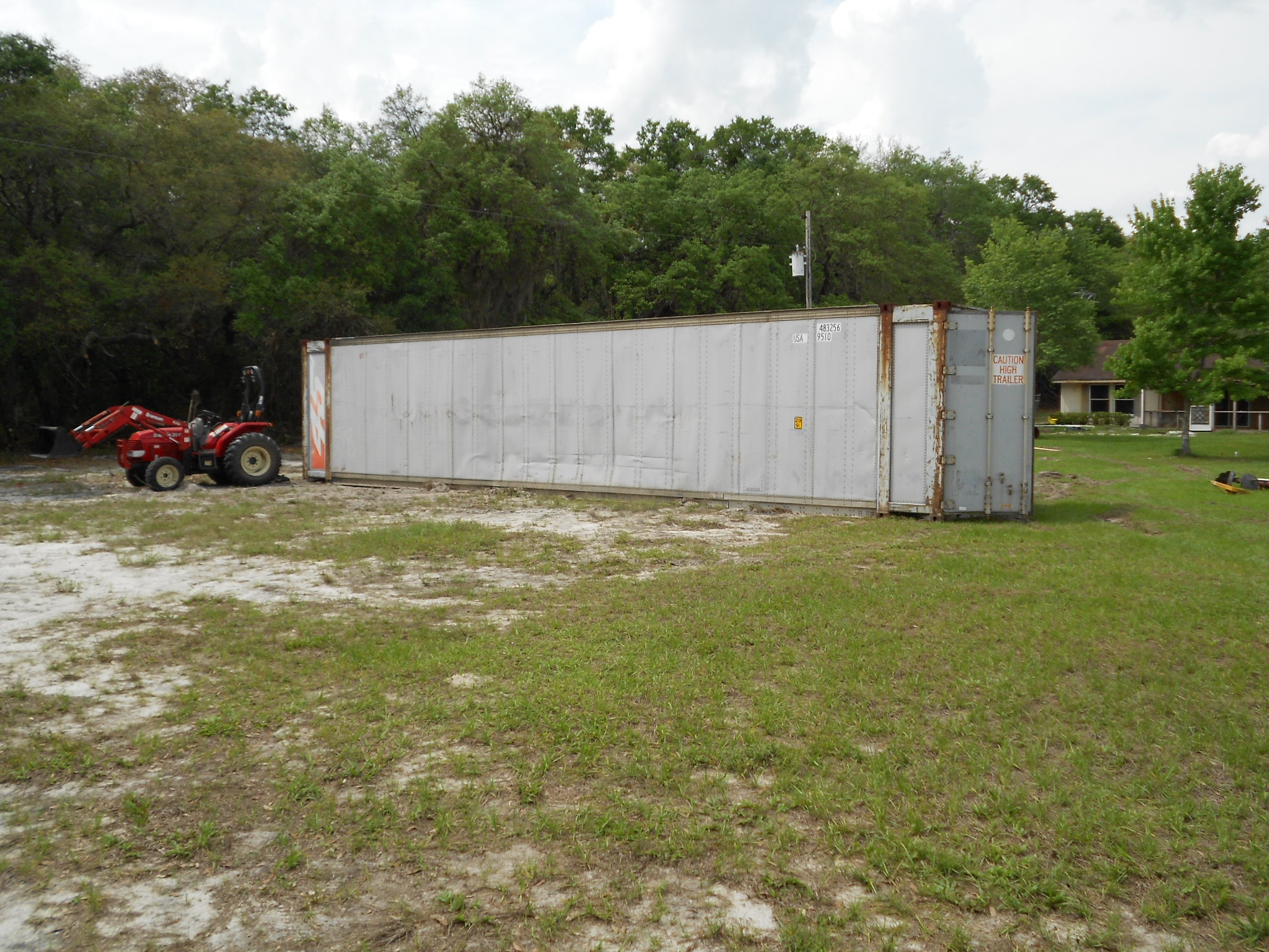

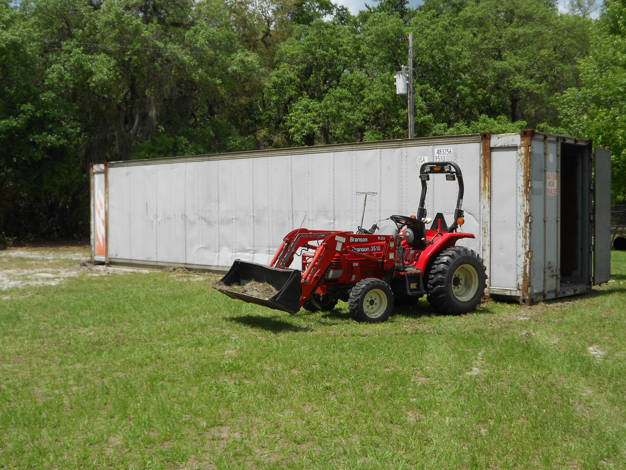

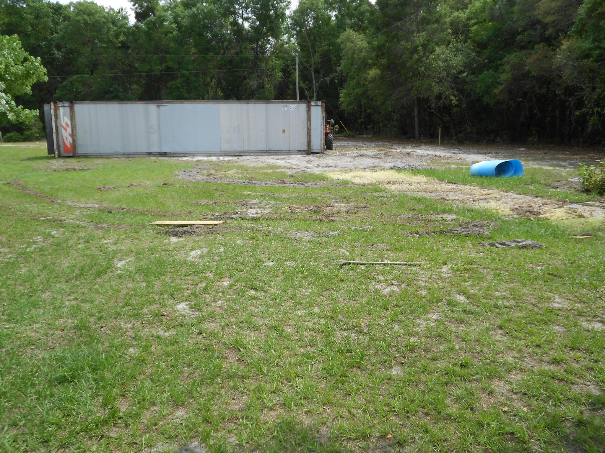

I ordered a Red Iron Building (40' X 60') and I need to put it where I had my 45' container dropped.
So I hooked a chain to a pocket on the rear and then on the front and dragged the container about 10' each time. I moved it about 70' and turned it sideways from how it was sitting. After each move I had to remove the dirt piled up with the bottom rail.
You can see in the second pic the dead grass where it used to sit.
I needed Low/low gear, 4 WD and I ran the chain over the trailer ball bar on the three point and to the drawbar.

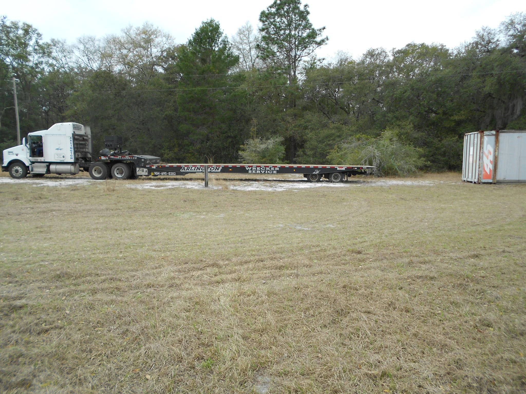

How do they drop the container when it is delivered?
   / Moved a 45' Container with my Branson 35 hp Tractor
Here is how they delivered mine.
On a Landall and they tilt the bed and pull out from under it.
