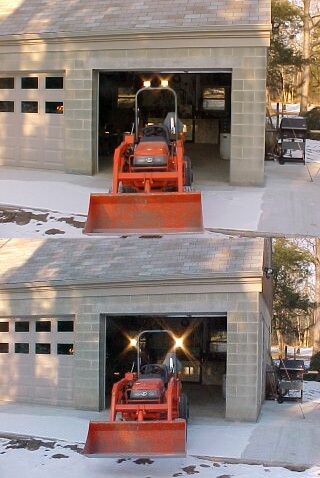

After using my loader at night I knew I needed some additional lights, but just could not come up with the setup that I liked. After much reading TBN I realized there are several ways to skin a cat and mount lights.
I used arc welding magnetic grounding blocks and mounted my lights to them and used coil cords to wire them up. Front,back,high,low,out on the loader and put them on the shelf when mowing under trees.
Works for me and they don't fall off and point them where you need them.

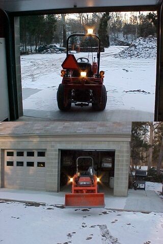

And more

Nice job, so are they hooked into a cigarette lighter socket for power?

Hi Spencer:
For now they tap into the power under the seat.
Furture plans are for a waterproof switch in the dash
with a disconnect under the seat for other 12 volt
attachments (sprayer).

I like the idea of magnetic mounts for the lights.
What type of lights did you use? Where did you buy them?
Where did you get the coil cord?
