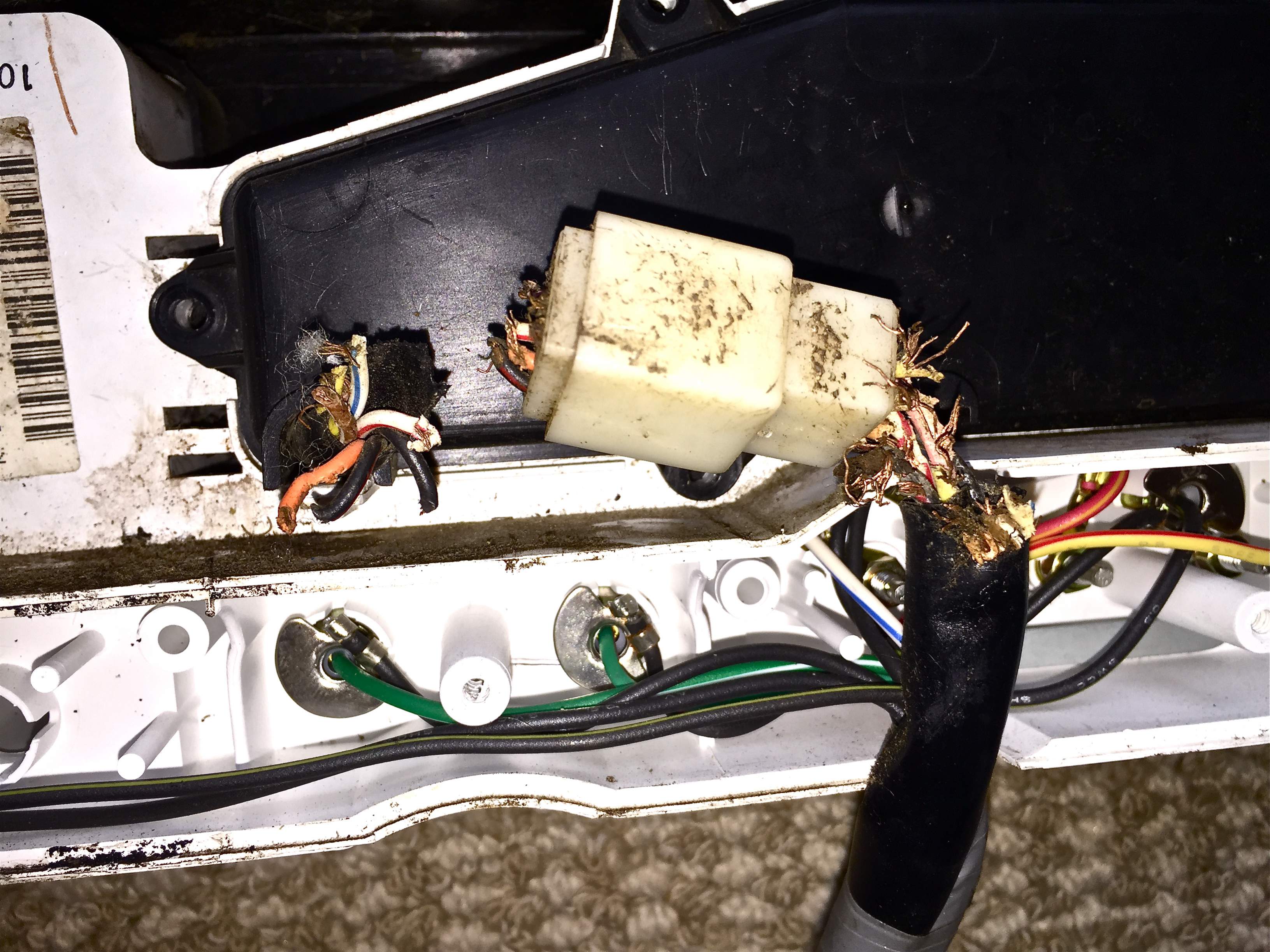

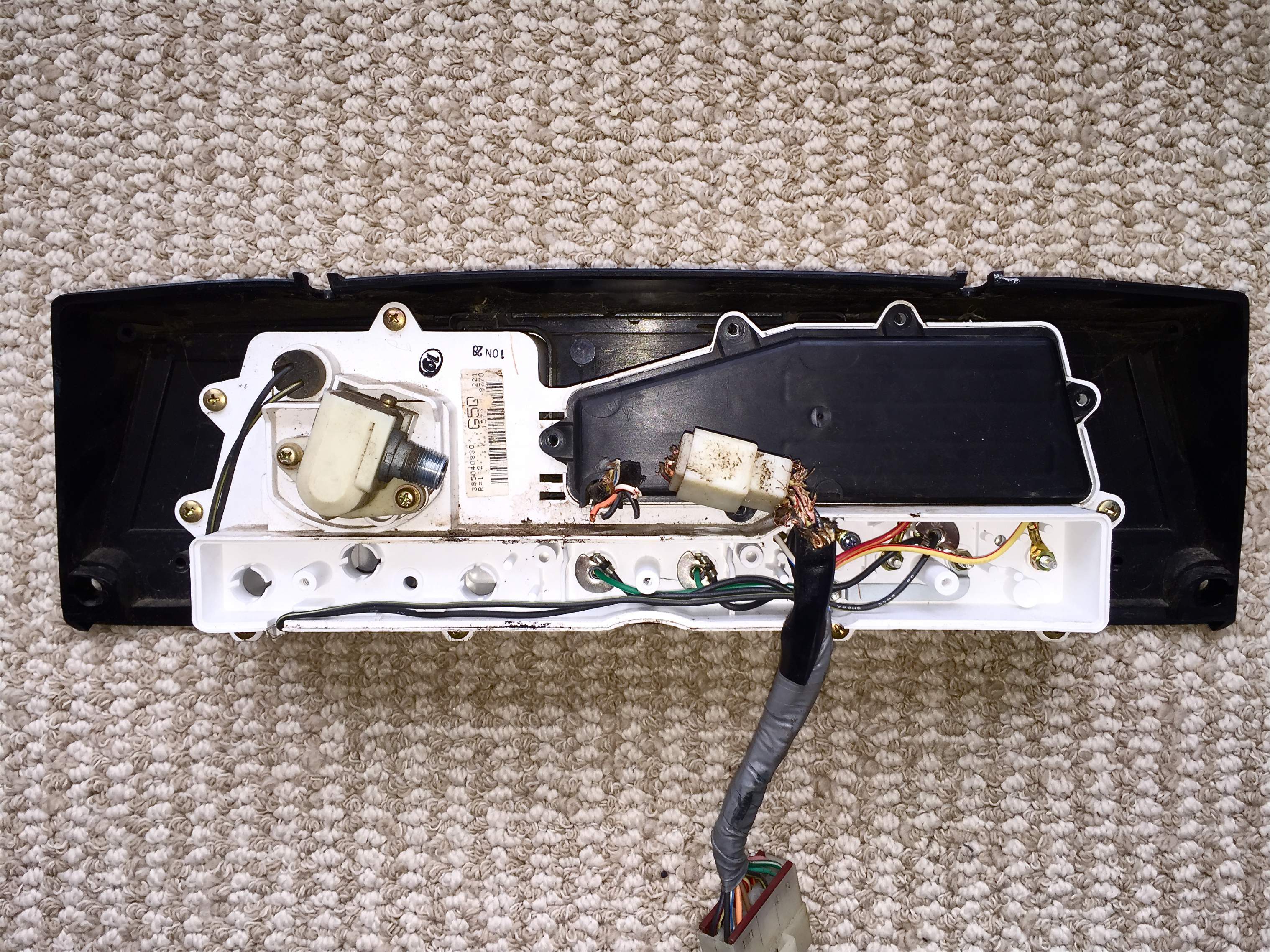

Took my 1993 Ford 1920 dash apart to troubleshoot some display issues. Found major mouse damage to the wiring. Anyone been through this before and came up with a good fix? Can I buy the wiring from the dealer or are there companies out there that can rewire the dash panel?

That was one hungry rodent! Two yeas ago, I also had a mouse build a nest on top of my NH 1920 gas tank and chewed through most of my dash wiring but I discovered it before he had chewed all of the wires. My tractor repair guy took the dashboard and the wiring harness pigtail to the bench and matched the wire insulation colors to repair the harness with quick connectors. Been working fine since. I attached some dryer sheets inside the tractor dash area, near the nesting spot to hopefully keep the rodents away. I don't remember the replacement price of the dashboard gauges and wiring but it must have been significantly higher than the repair.
   / Mouse Wiring Damage
Update: my New Holland dealer wanted $480 to replace the wiring harness and circuit board. I found a local small electronic repair shop that rewired everything (replaced a failed diode too) for $150 cash. I should be all set with the electronics...now on to the engine rebuild!
