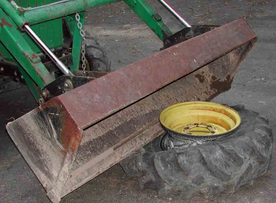

That being said, I have been meaning to get one of the HF changers to use at home; it doesn't cost me a dime to do them at the shop, but if I make the mistake of pulling in the lot, fifteen people with flat tires will swarm me and keep me there all night.:mad:
That's funny....doesn't anyone else work there?
As for changing rear tractor tires on the tractor....that's an interesting
approach and makes sense. I found the rear tractor tires were much
easier to change (but not lift!) as the larger diameter beads had more
stretch and flexibility. I could even break their beads with a FEL bkt (photo).
All my new ag tires (rear AND front) could be mounted using the mounting
rod (the red bar in the photos). This R4 tire was a 6-ply and I could not
get the leverage, so I resorted to the tire irons. I do use soap...a spray
bottle of detergent.
I have used FELs or car jacks to break beads on tractor tires, but it did
not work for any of the car/truck tires I tried. I needed more than the
3000-4000 lb of force for those beads. I need a heavier object to set the
jack under....if you have such, that is great.
Anyway, the HF changer was only $35, but not obvious how to use....unless
you have used changers before. I love those HF tire irons, too...only $6 ea.

Anyway, good post, BEAR. Do you have any pix of a proper tire hammer?
