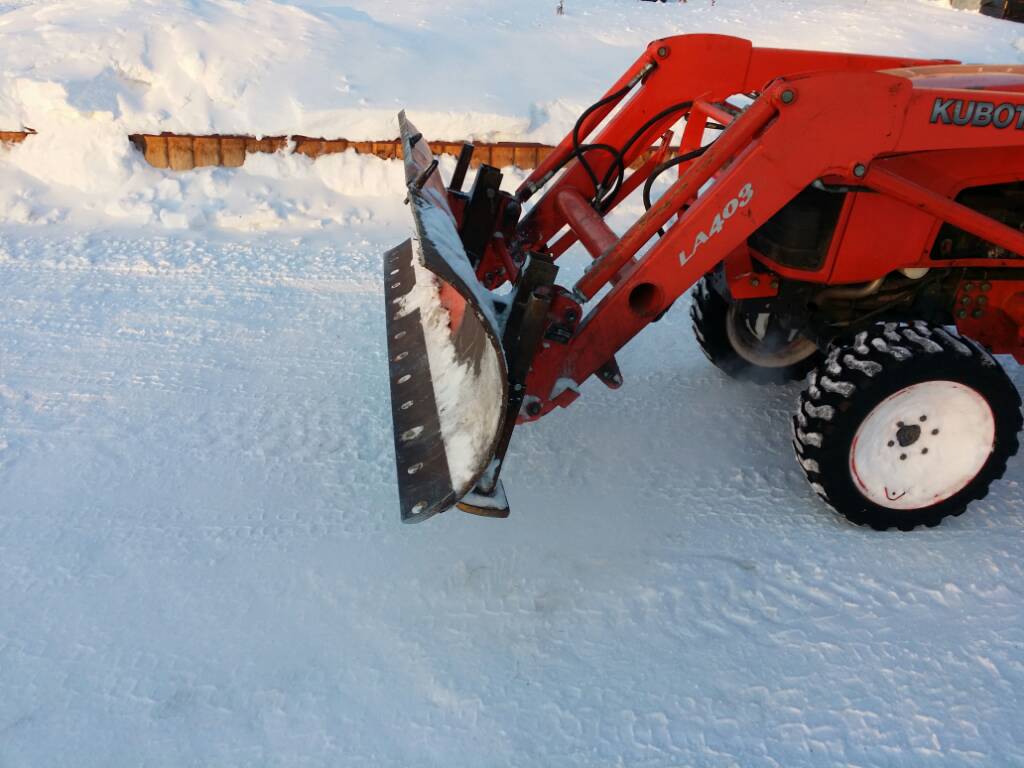

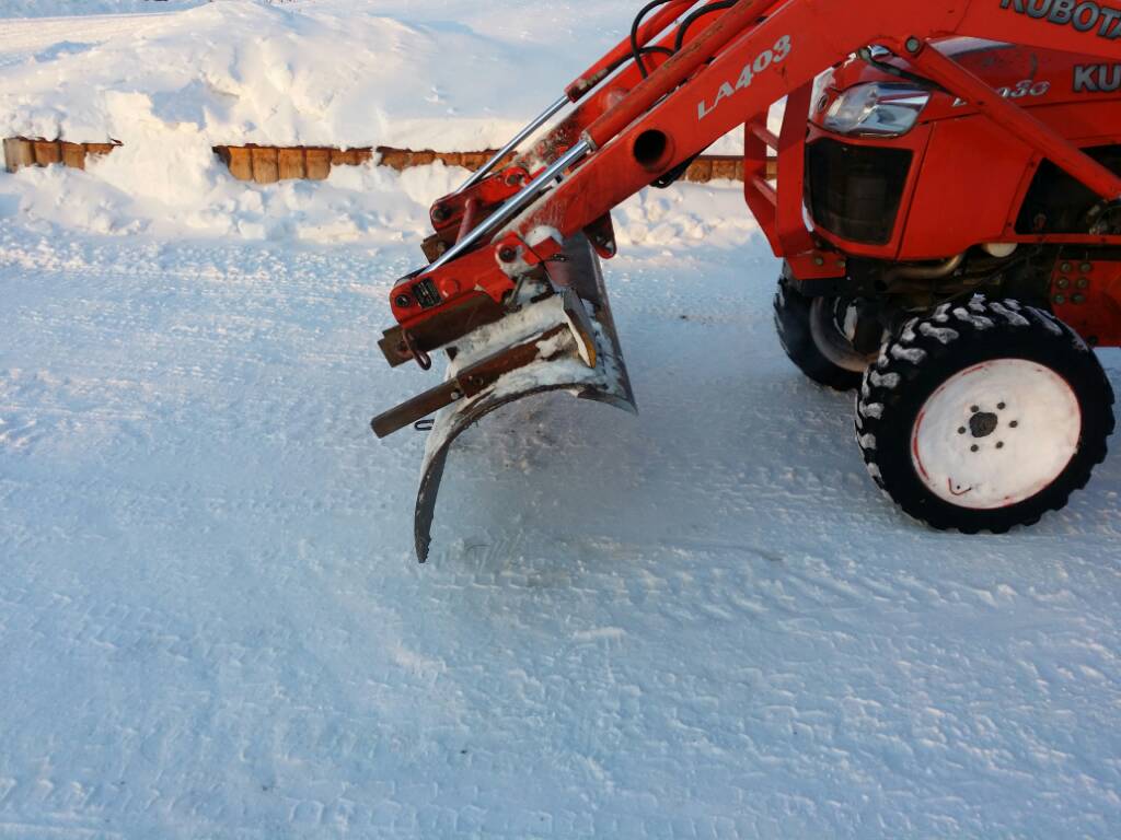

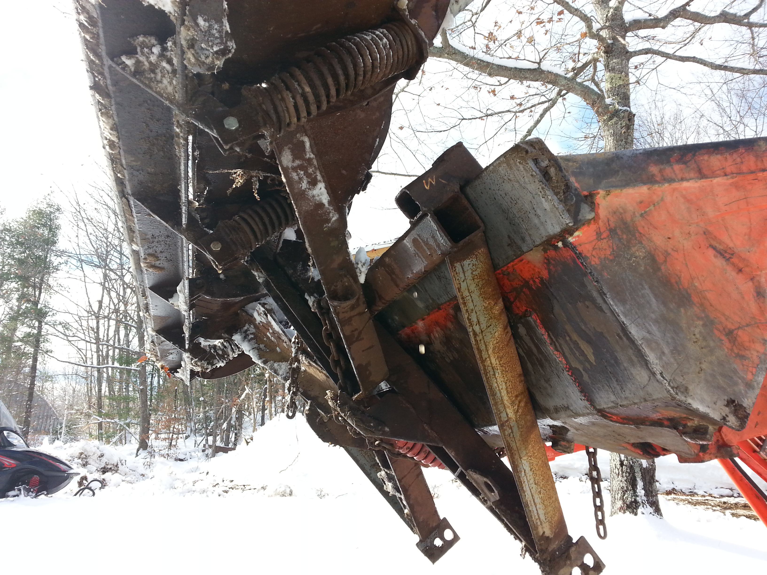

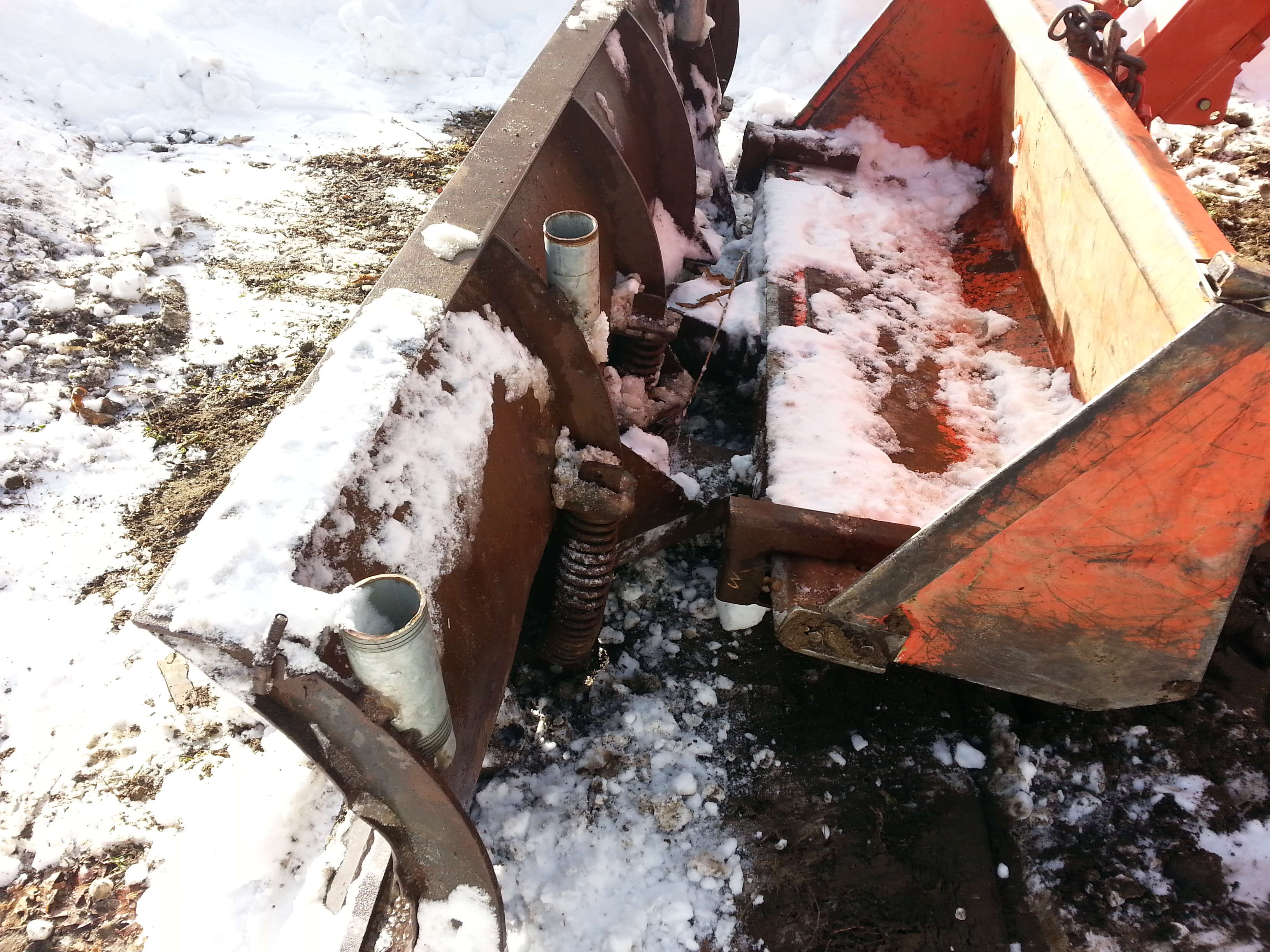

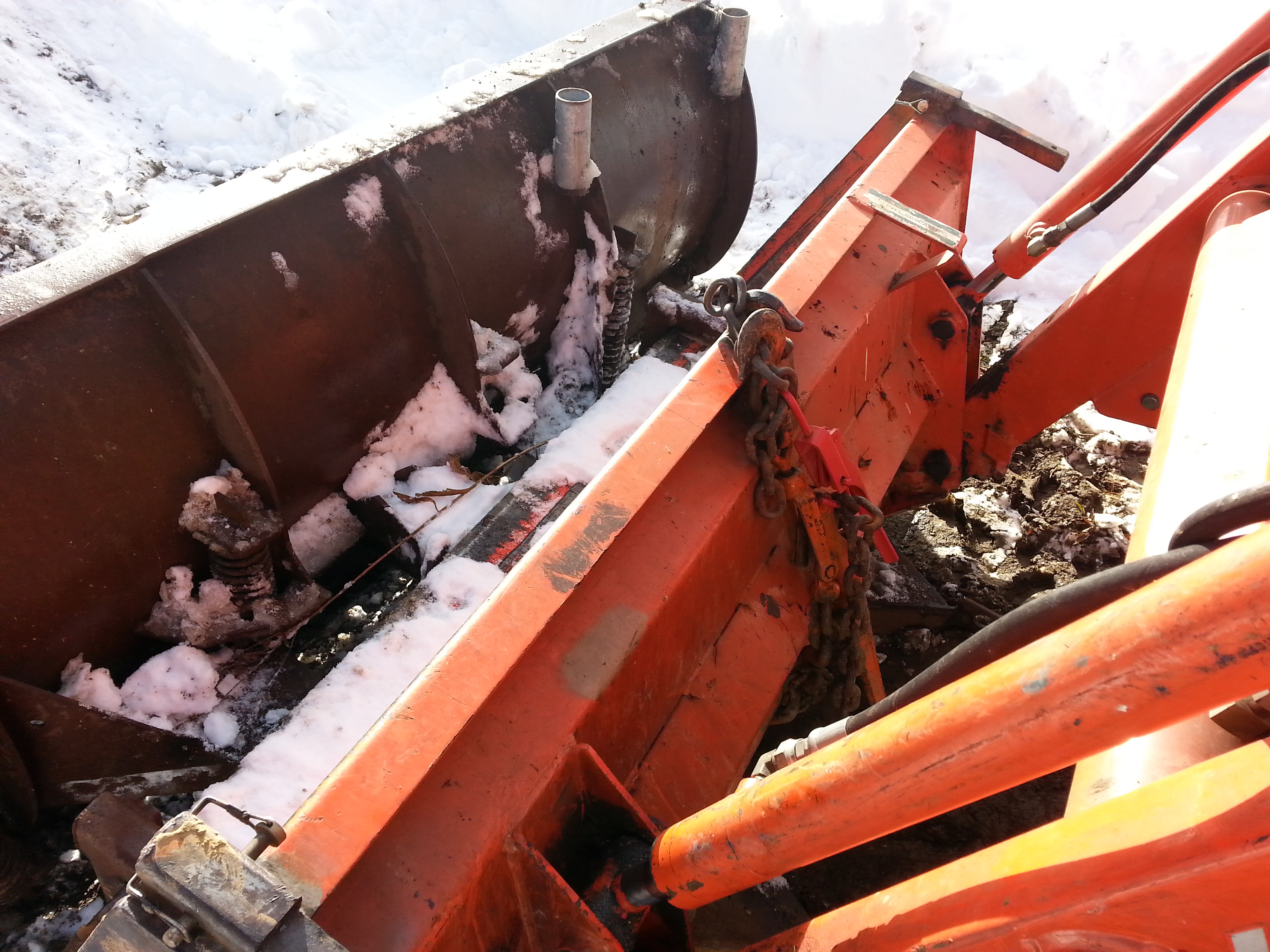

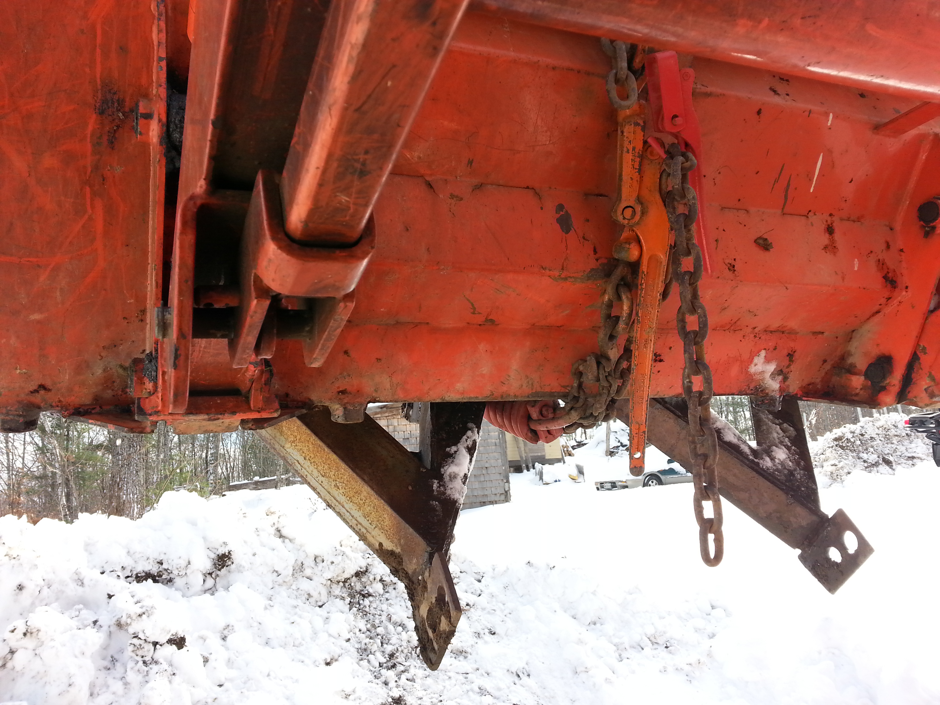

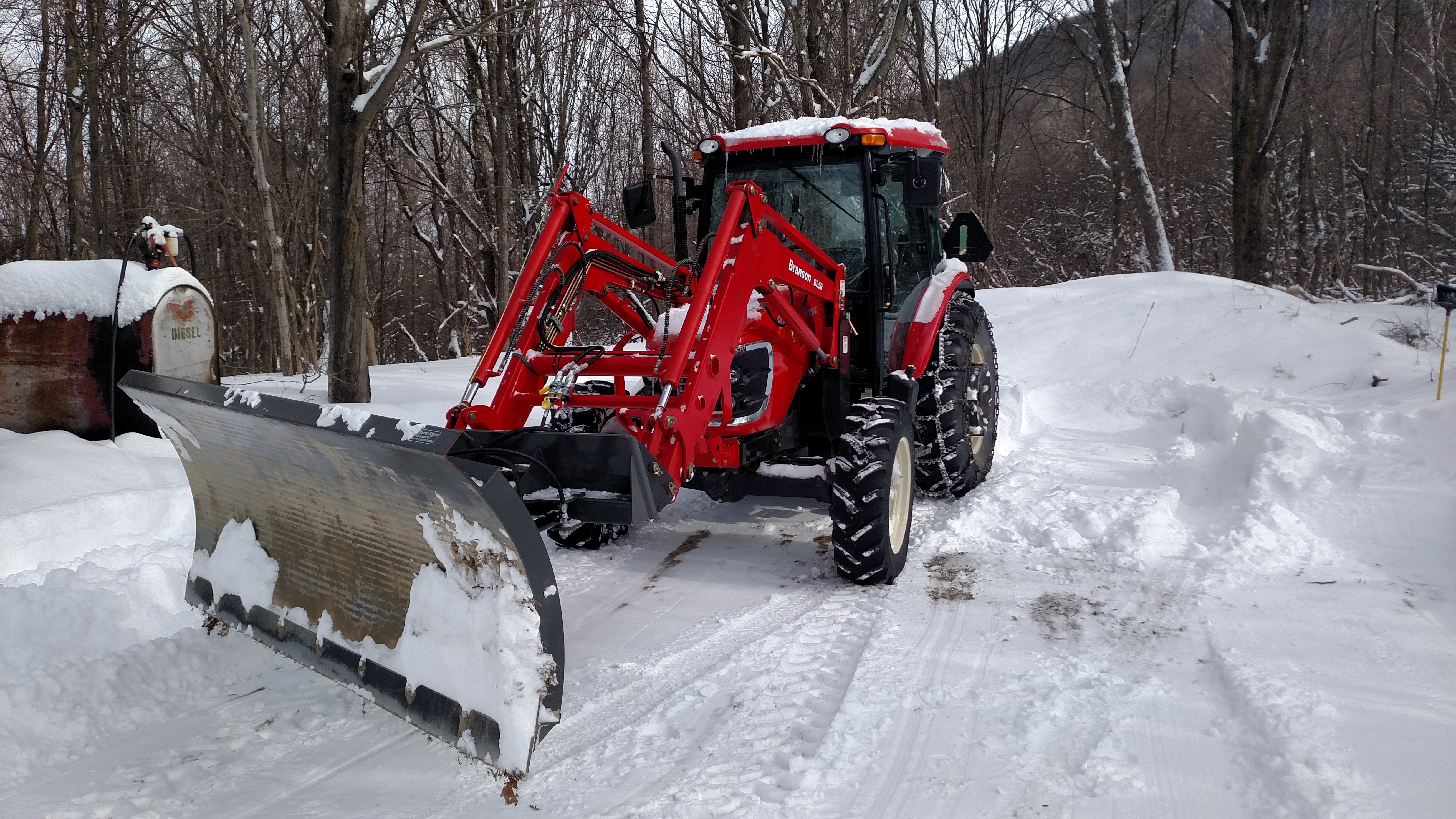

Here's how I have mine on, I tried it out further first, but it just stuck out way to far so I set the plow under the bucket and use the A frame as a running dept shoe to keep plow from digging in, tilting the bucket as needed. I do have a slight angle on the blade for each side held in place with a removable 1" pin, not as efficient as a plow on a pickup but I can plow the snow in a higher pile.

How do you run that OldPath ? Like a dozer with your hand on the lift valve all the time or do you put the FEL in float. That mount gets the blade back nicely.
I want to cob something like that up and wonder about the best way to float the blade.

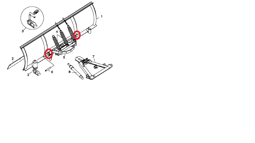

I have a Meyer EZ Mount plow with a 7.5' blade. The plow blade mounts to the A frame with two 1" thick pins, which also are the blade trip pivot points. The plow is about 20 years old, and the pins are original. I bought 2 new pins but may have to use a torch to get the old ones out. I sprayed them to death with WD40, and used a sledge hammer on them to no avail.
The pins are circled in red.
Have you removed your trip springs
I think many dealers and operators will be worried about the side loading being applied to the loader arms, when your blade gets angled and you are pushing snow sideways it's getting a good side load on the loader arms. I have an 8 foot blade on my loader and I watch for indications of side loading and I'm plowing slow. I purchased my blade last year and don't even see a manufactures name on it, it is an extremely tall blade for it's width, 3 ft tall., I'm going to have to add spacers to the shoes as my loader arms are to close to the ground when I'm using the shoes to carry the blade. I have considered widening the blade.
I find that float still likes to dig in ground to much so with a rocky driveway like mine it's one hand on the FEL lever which is not bad when the newer tractors now just have one lever for tilt and lift, but on you're new Hot-Top driveway you could use the float program. It only takes one good snow storm to get a smooth plowing driveway, then if the next storm is rain, I have to start all over again.
If one does mount a plow like this with logbinder, I recommend a heavy duty short coil spring so to get the final correct tightness of chain, not good to have blade flopping around on FEL bucket and furthermore it's better if one has a quick-disconnect bucket, then mount a plow just on the FEL arms, one of those options I didn't think about when a got my tractor. But either way I also recommend keeping the trip cutter blade on, got to have some give somewhere or something will break.
