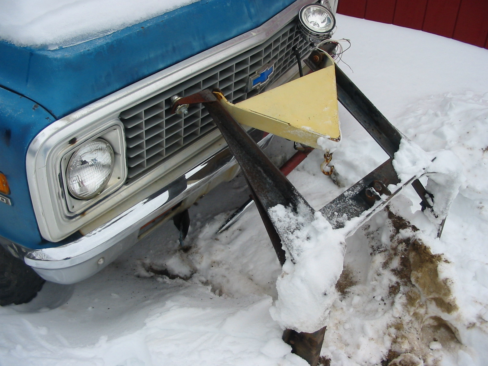

mounting a fisher plow on my bx24
   / mounting a fisher plow on my bx24 #11
Why not mount sub frame to the front of tractor and use a link to the bucket to raise and lower the plow. Pull two pins to remove plow to use the bucket. No strain on the bucket mounts that way.

the rest of the plow frame is junk I torched it off libby heating excursion 010.jpg

I mounted a 7ft. plow from a pickup to the loader bucket of my Kioti DK35. I cut 2 holes in the back of the bucket, slid the arms into the holes and pinned them.
Next I hooked up a chain from the plow to the middle hook I had welded on to the bucket. It works slicker than sh**. When I take it off, I have 4, 3" square plates with a 3/4" bolt through the middle that I sandwich over the hole and tighten.

I would just cut the receiver dog ears off the subframe and weld them to the inside of the bucket. this would allow you to pin the plow on when needed. I'm just waiting to find a cheap plow to put on mine. Is that donor plow truck a '68 I aways wanted one.
