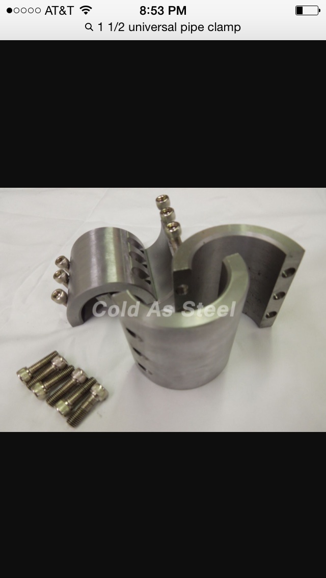

Trying to help a friend put his bale monitor in his new tractor. It's a Vermeer monitor and a LS 7040 cabbed tractor. He wants to put it on the right hand door rail. He came up with an idea of welding a custom bracket to some black pipe that's the same outside diameter as the hand rail. Then clamping it to the hand rail with hydraulic hose frame clamps. But we are having trouble finding the clamps. OD of pipe is 1.25 inches. Does anybody know where to get them? Does anybody have a better idea?

might try some u bolts
   / Mounting a bale monitor #3
These are roll cage brackets he could weld this on instead of that other pipe.

Double split shaft collars weld one half to the new bracket then you can clamp the bracket to the hand rail.

I've tried to get him to call the LS or the Vermeer dealer and see what they had to no avail. He's determined to build it himself. Cheaper. Found something similar to what foreman Texas posted. Actually used his search title. He likes the idea. I'll try to keep this posted.

Do a google search for 1.25" or 1 1/4" "tube clamp" you should find all types of ideas
