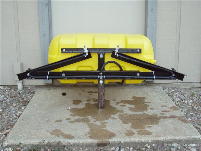

I have a 25 gallon sprayer tank that I use to spray all my fence lines. I used to have a front mount on my Kubota L175 to carry it while spot spraying. Well, I will be taking delivery of a new L3130 on Monday, so I need to figure out how to mount this thing temporarily (easy to take on and off) for use while spraying.
I may decide to just permanently mount it on my sprayer boom on the 3pt, but I would like the capability to mount just the tank for when I will be spraying with the nozzle (for fences and trees).
Any ideas on a nice looking front mount?? I don't want something ugly on my brand new tractor....haha :)

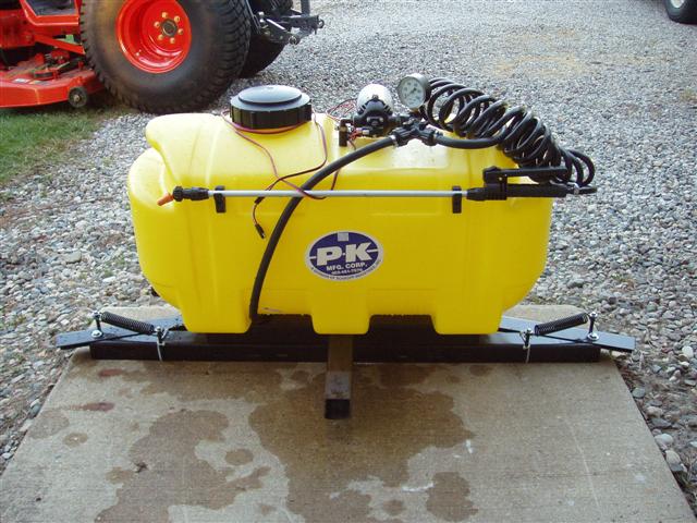

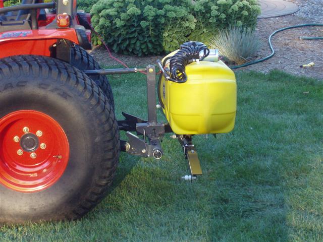

I have a 26 gallon sprayer that I use. I made a mounting bracket that fits the 2" receiver hitch on my 3PTH. I have the receiver hitch on the tractor most of the time so mounting the sprayer is very simple.
