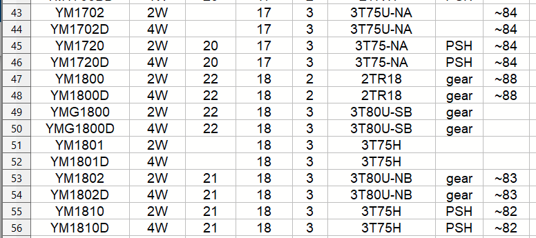

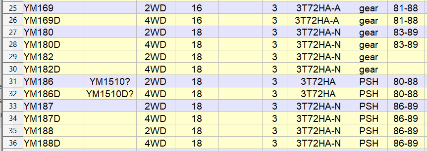

Dec 23, 2025 / Motors #1 D Dwkelly New member Joined Dec 23, 2025 Messages 1 Tractor Yanmar I have a Yanmar YM186 with a 3t72ha motor. What other motors will bolt up with minimal issues? I have found a 3t75ha.
Dec 23, 2025 / Motors #2 bmaverick Super Member Joined Sep 17, 2013 Messages 7,362 Location Beloit-WI Tractor Yanmar YM2610 ■YANMAR GURU■ EXTRAORDINAIRE I nearly missed you question as it's not posted in the Yanmar tractor section on the site. Here are the Yanmar YM 3-digit domestic engines in your model range. And the Yanmar YM 4-digit Gray Market engines, still plentiful as more were imported than the domestic now.
