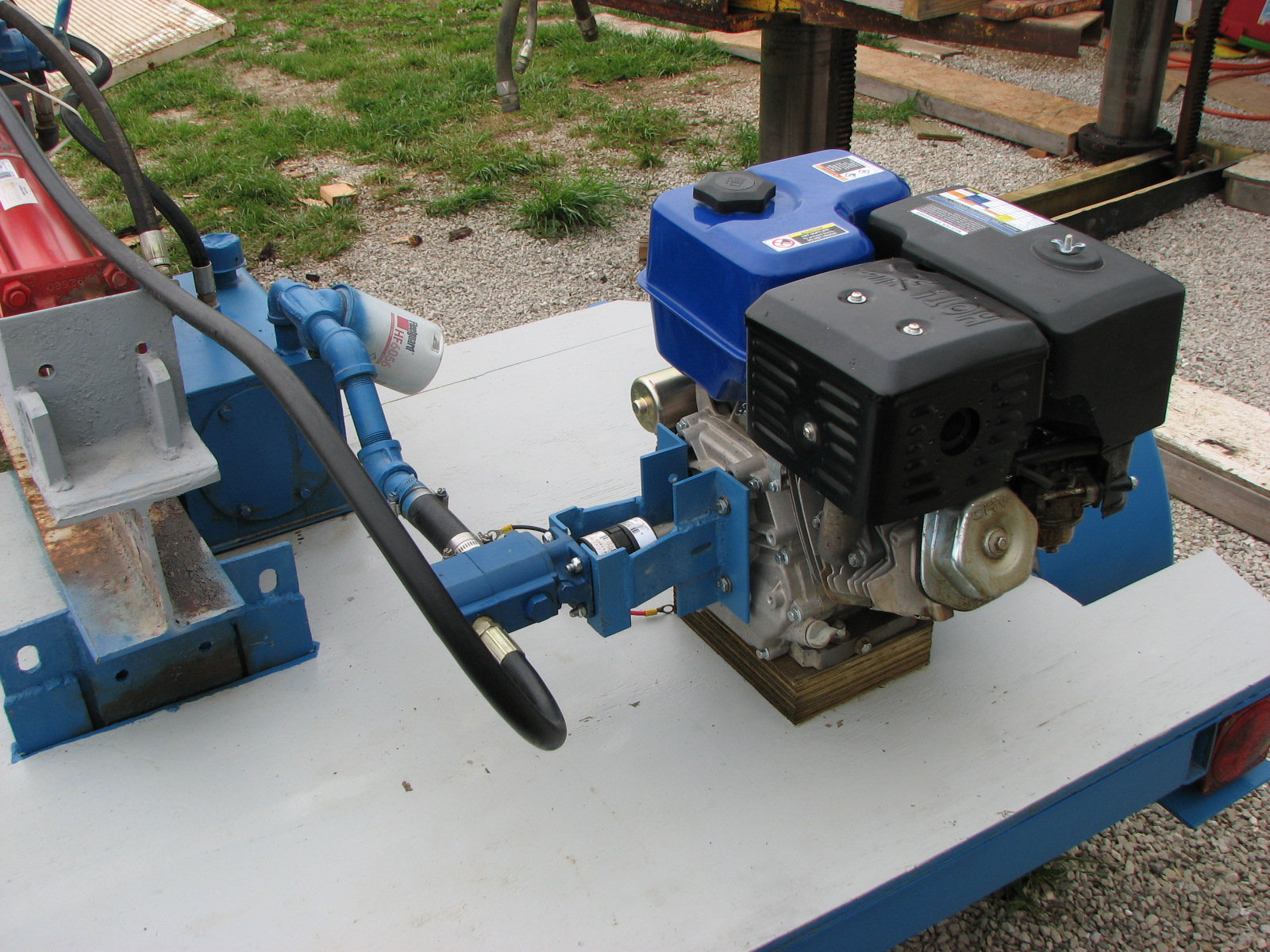

I am putting a hyd pump on a motor and was wondering if someone has a good way to aline it. I put the pump on the motor with a coupling and I was going to use a hose clamp to aline the 2 together or is there a better way. Thanks Ivan

A "Love Joy" connector is a common "spider" connector. They are commonly available to fit different sized shafts & have different sizes to accommodate different horse power ranges. There is a neoprene like material used as a cushion between the 2 halves & you leave a slight gap when mounting to decrease wear & prevent them from hitting together due to vibration movements of the motor & pump, (end play in the shafts). The 3 pieces you will need will cost around $25-30.
The pre-made pump mounts are around $80 & $30.
For my log splitter, I fabricated mine out of angle iron & flat bar stock. I several hundred hours on it without any problems.
   / Motor alinement
Thanks for the help. It is up and running. Iknew there were pump spacers and I used a love joy coupling with a home made pu spacer. It is nice to have a milling machine. I use to aline them on die cast machines but did not know if the smaller ones were different or not. Again thanks
