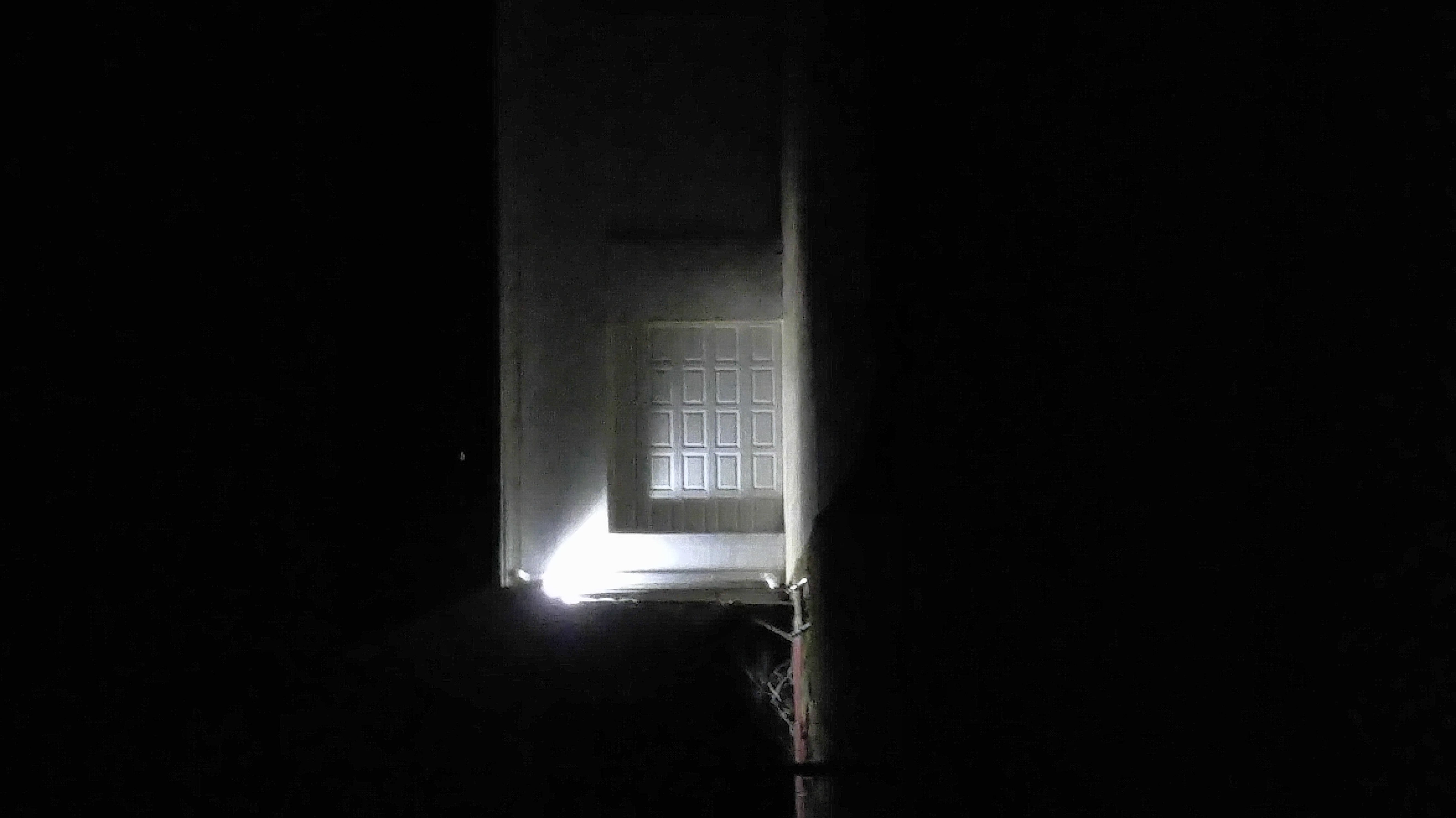

This is the Honeywell LED one, from 100 yds away.

Honeywell one? Is it the same as the Amazon link or similar? You have link to the Honeywell one? That looks bright.
   / Motion detector and dusk to dawn lights #8
Says do no use in enclosed space due to heat. But also says not water proof. Does so outdoor applications. Like to see what kind fixture they say to use.
Not as bright as very vapor, 35W. But ok to replace flood. Mercy vapor shown in other thread is 7700 lumens, this one 3000. Have to get 80W for $95. Depends on how much light you need.
Also depends how it shines $95 is to much for me to risk. Maybe try a little. I am not sure how mature this is in the bigger LEDs. I see more small ones, but I don't look either.
I got it from amazon. It is plenty bright.
