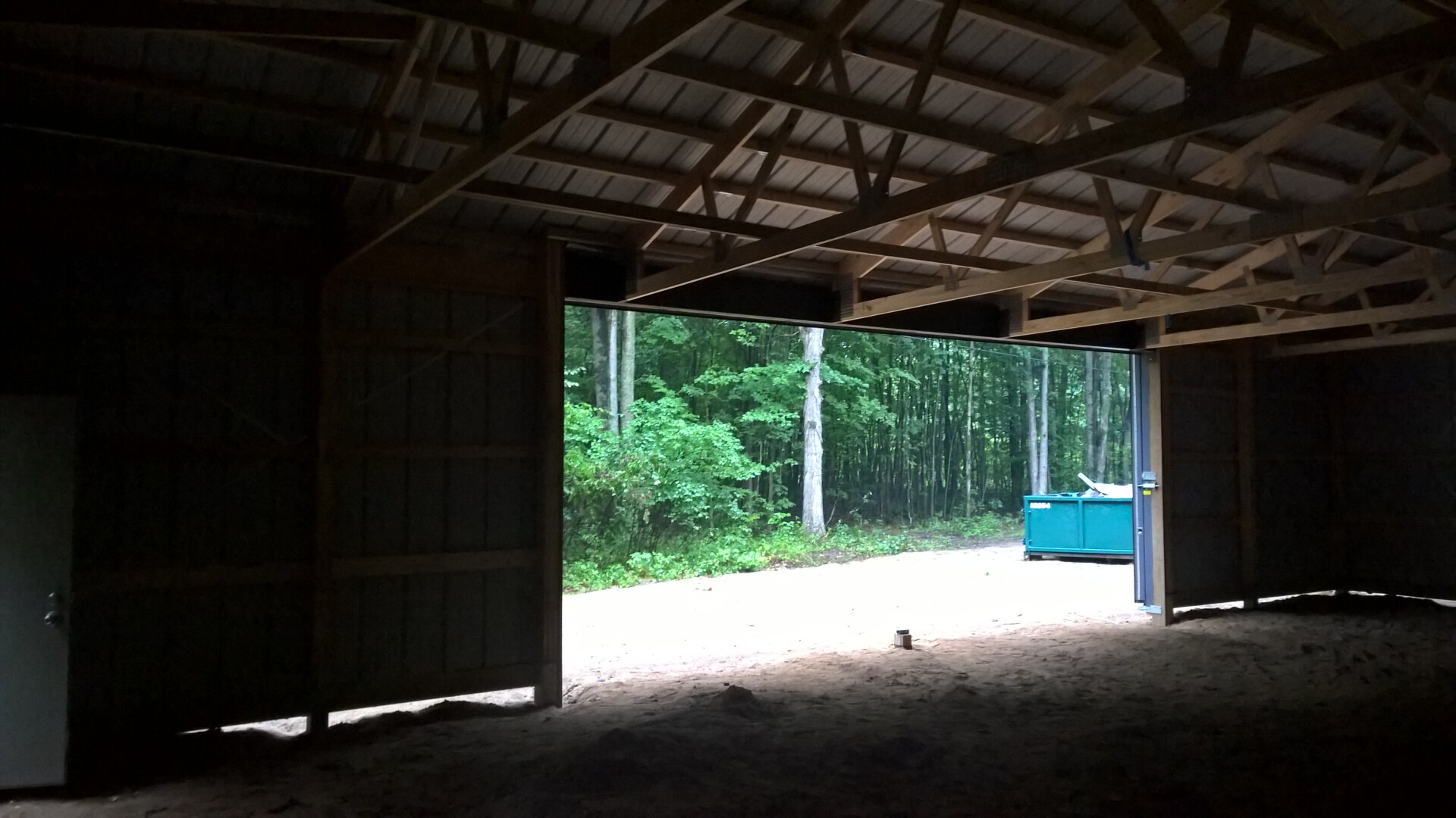

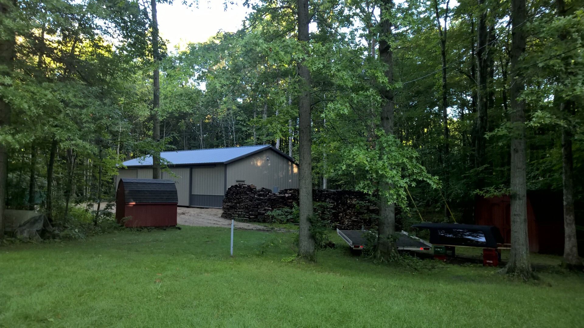

Morton just finished our building. Sales was from the Brown City office. I can say without a doubt, it is a very quality building. Mines a 30x53x10 with a 4/12 roof with a 26' double slider on one of the '53 walls. cold storage building. They used a mammoth steel header for the door opening, was not expecting that. I opted for all SS screws, concrete lower poles for just a few hundred bucks more. Just outstanding quality. Perfectly straight, super strong, doors work like butter, trim work is second to none. I actually visited the Morton factory in Kenton, OH where most of lower MI stuff comes from. I can say, as an engineer, I was extremely impressed. Everything that can be done ahead of time, is done, at the factory. Truss brackets are their own from raw steel, cut and shelved for when your trusses are put together. Many holes pre-drilled. Trim work matches steel contours, no gaps, once concrete floor is in ,it'll be a sealed deal. Poles are pressed and fastened, and chamfered at the lower to meet the concrete column bracket, at the factory. No problem with sales, crew was awesome, kept the site super clean. Yes, they had the radio on...can you blame them...I would too if I was building it. They cover the materials when they drop them off, nothing sitting in water or getting soak in rain for a mabey days to weeks it takes a crew to show up. I think a huge advantage is the building is engineered. If you want insulated, the whole design changes, more trusses, poles are closer..etc. But, just little things everywhere, roof panels have a sprayed on felt like material on them on the back-side. This prevents any flash condensation from dripping. Just, attention to details, everywhere.
That all said...what I started with was a workshop I could put my auto lift in, fully insulated, 12' walls and a 6/12 roof with 3/12 interior chord. But since the friggen township wanted bribes to build a 21' building, in the middle of nowhere mine you (there's no reason for a height restriction, I'm not within 500' from anyone, including a road)..but anyway, long story short, there is a height restriction and they wouldn't grant me a variance, so I had to change the building. Do I need this level of quality is what will be essentially a cold storage building? Probably not. FOr a fully insulated finished metal interior, I think they were fully worth the cost. But I think, for what I ended up with, essentially just barn I'm gonna park stuff in, like cars and a tractor I could have save several K with some effort into finding a local contractor who cares. But, you can't beat a Morton. That thing is solid as heck!

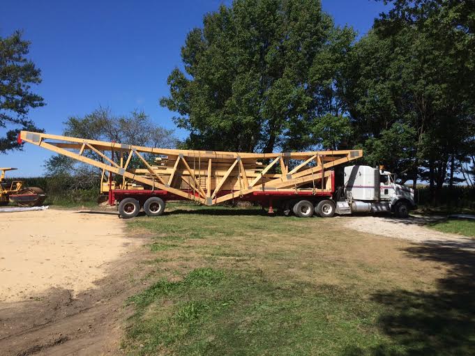

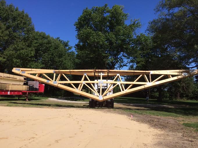

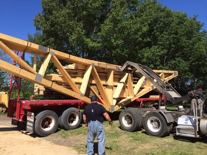

We're about to find out. 60x80x15 delivered Monday. In Illinois. Rep was great to work with.
