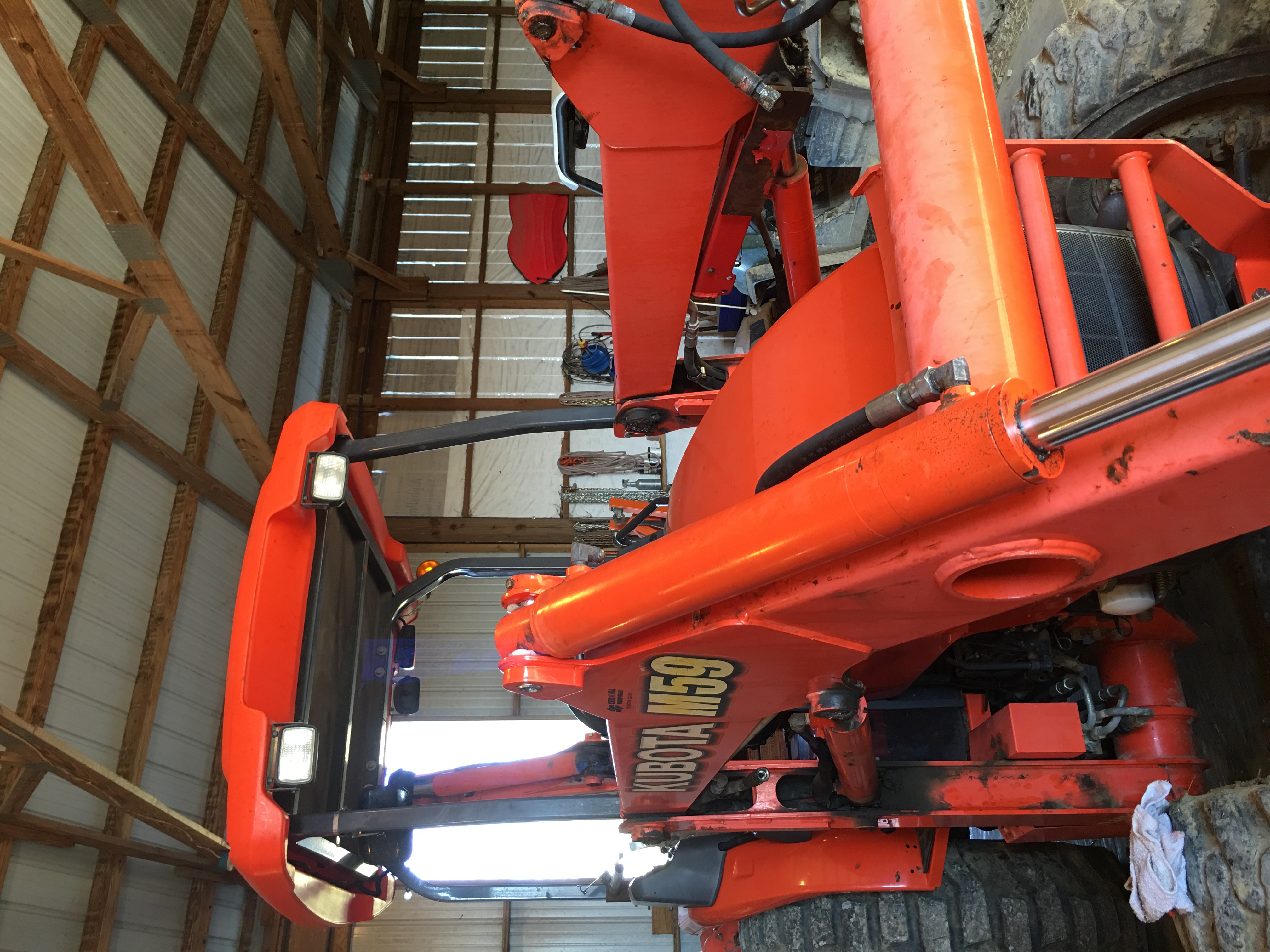

Not to happy with Kubota pricing right now, see Posts #15 & 16
http://www.tractorbynet.com/forums/...m59-front-drive-shaft-leak-2.html#post4420381
Kubota should spend a little less on advertising and take care of your problem
This is a design miscalculation of possible loads on the pin or a materials defect. The repair should be on Kubota's nickel. The engineer(s) who designed this disaster should hand carry the repair parts to you.
PS this is not Photo-Shopped
Not sure what you are trying to show with your picture? If it's the fact that you are lifting the tractor off the ground with your backhoe I hate to tell you but I can easily lift my 580k off the ground of I bet the bucket under a solid root or rock. I have to be careful because if it suddenly lets loose it will slam back down on the ground. I tried to fill the bucket with dirt but all I did was peal apart the backhoe bucket like a pull tab on an old beer can. $350 for a used replacement bucket was all I needed to learn to live within the limits of the machine.
I think you'll find that Kubota uses mild steel simply because they want the pin to wear since it's the easiest part to replace. I replacing the right pin when the left pin would probably been a good idea. I think I would remove all the loader pins and inspect each one closely.
I ignored that post and chalked that one up to 'stupid is as stupid does'.:D
