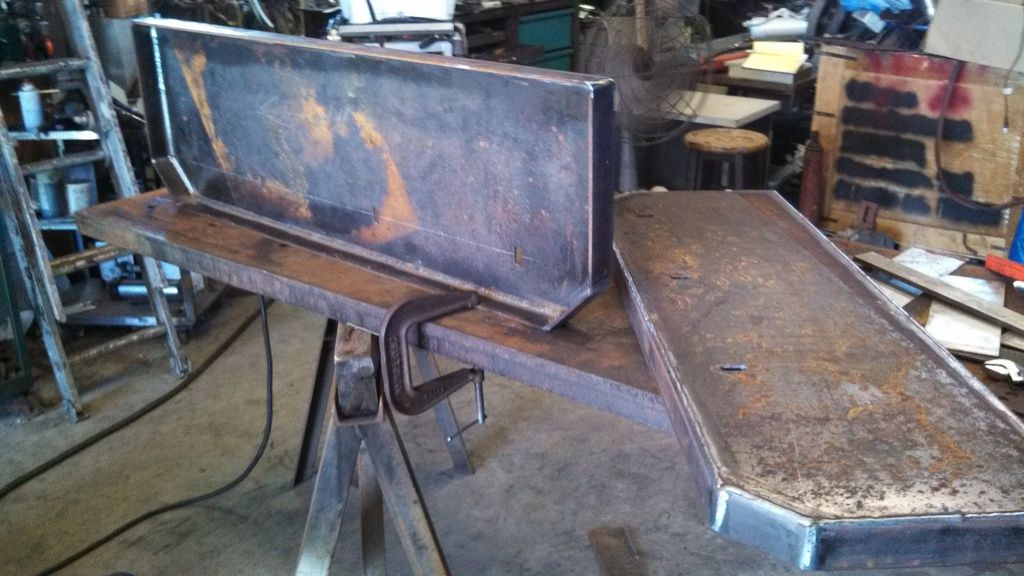

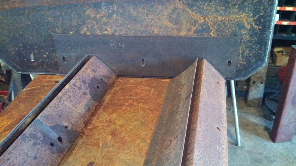

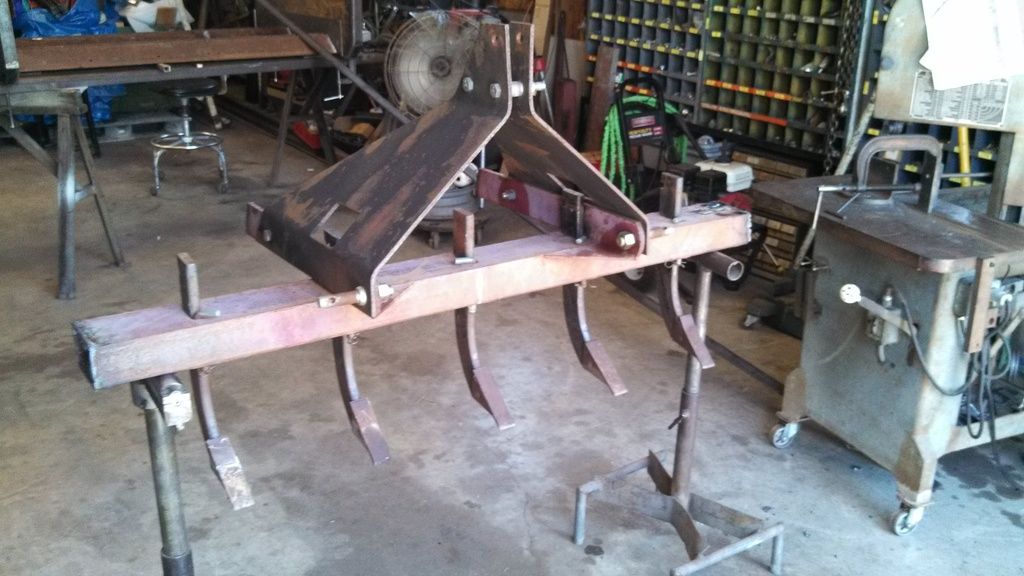

I had been wanting one for years and had saved a few parts to build it also keeping an eye out on Craigslist to see if I could get one cheap. I was just about to order the cutting edges when I ran across a lightly used box blade on CL for under $300 and used it for my donor.
I cut the box portion away leaving this.
Made two side plates out of 3/16 and welded 2"X1/4" flat strap around the edges. Note the 1/2"X1" punched hole for blade adjustment.
Welded angle iron that the blades mount to to two more 3/16" plates with corresponding slots so the blades can be adjusted from 1/2" above the skids to 1.5" below.
Before punching the last set of slots I did account for the 3/8" thick replaceable skids on the bottom that bolt on.
My original intent was to not build one with rippers but had I thought about how quick and easy the "conversion" was going to be I would have started out with the plan.
