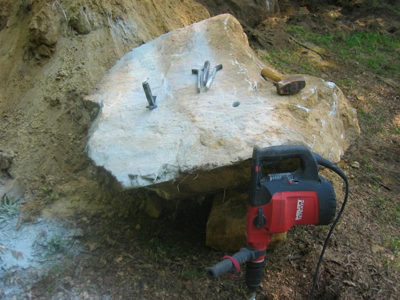

David, Here is the link to where I bought the plug & feathers
http://www.midcoast.com/~bicknell/WEDGESANDSHIMS.html

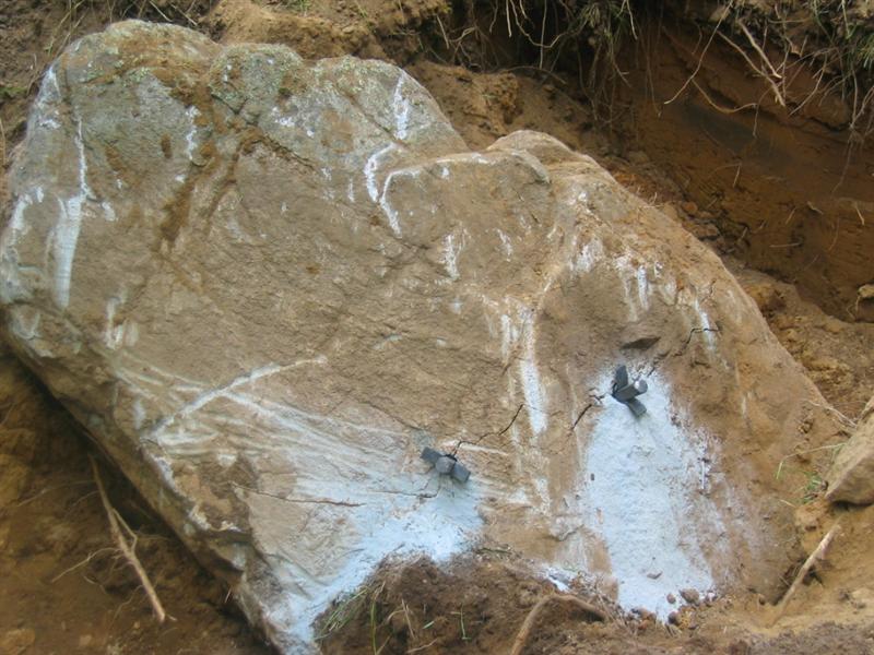

Here in Massachusetts I have alot of rocks. Most of the rocks are fractured ledge so the technique I use is to brush off the rock or hit it with the hose to clean it off. Then I can find cracks and I drill on the cracks and work the split along the naturally occuring cracks. I Drill one hole first then hit in the plug and see the crack spread. Sometimes I only need to drill one hole and the crack opens enough so I dont' nneed to drill to put in another wedge.
Shop around for pricing on the plug & feathers set but the cost of the tool won't kill you it will be the freight.

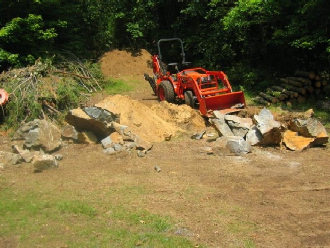

Ah, breaking rock in the hot sun. Well, I don't know how hot it is there.
Anyway, thanks for the photo sequence.
