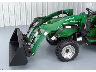

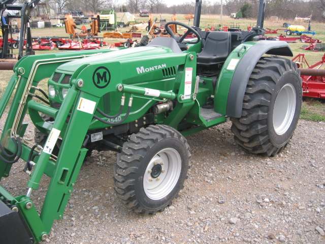

I thought it was high too... but on the Montana website the Model 100 was their lightest FEL and it seems it was used all the way up to the 45hp 4540, like mine. From various pics I have seen they used the Model 100 and 115 (made by Ameriquip IIRC) which has curved main loader arms but I've seen Montana branded loaders with angled arms also. Here are pics of a couple of 4540's to show you what I mean...
