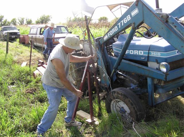

.... from her cell and said Dad was shredding and got his tractor stuck. He did not want her to call me but she did anyways because after 5 hours he still could not get it out.
Since I consider myself experience in this field I jumped in my truck to assist.:D

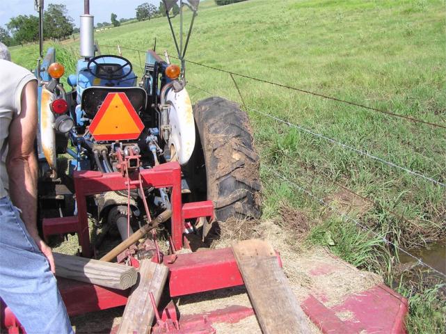

The picture shows how he is stuck, what it does not show is the cement culvert between the rear wheel and the shredder. It is a new culvert and has only been there 50 years. (OK, he is 79 and I will give him a break.)
After jacking up the stuck tire to disconnect the shredder, and then we cut the fence and removed a post, he then curled his bucket downward and pulled himself out. It was easy I have seen it many times on TBN. In an hour he was mowing again. He thought he could do it without cutting the fence or removing the shredder, no way.

I just make it a standard thing that if I am stuck with a 3PH implement of any kind, the implement has to come off before attempting to get the tractor unstuck. Nice job, Don.

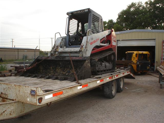

Heck, I even got this thing stuck last Saturday. (And I rented it because I kept burying a Case 580 Super L).
