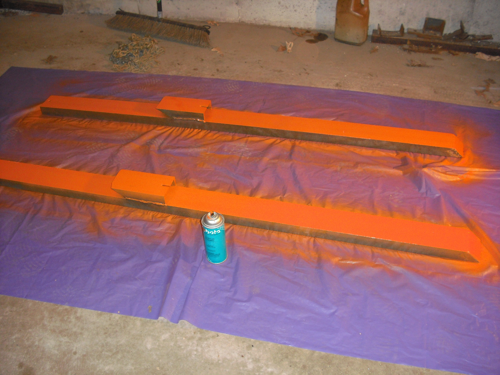

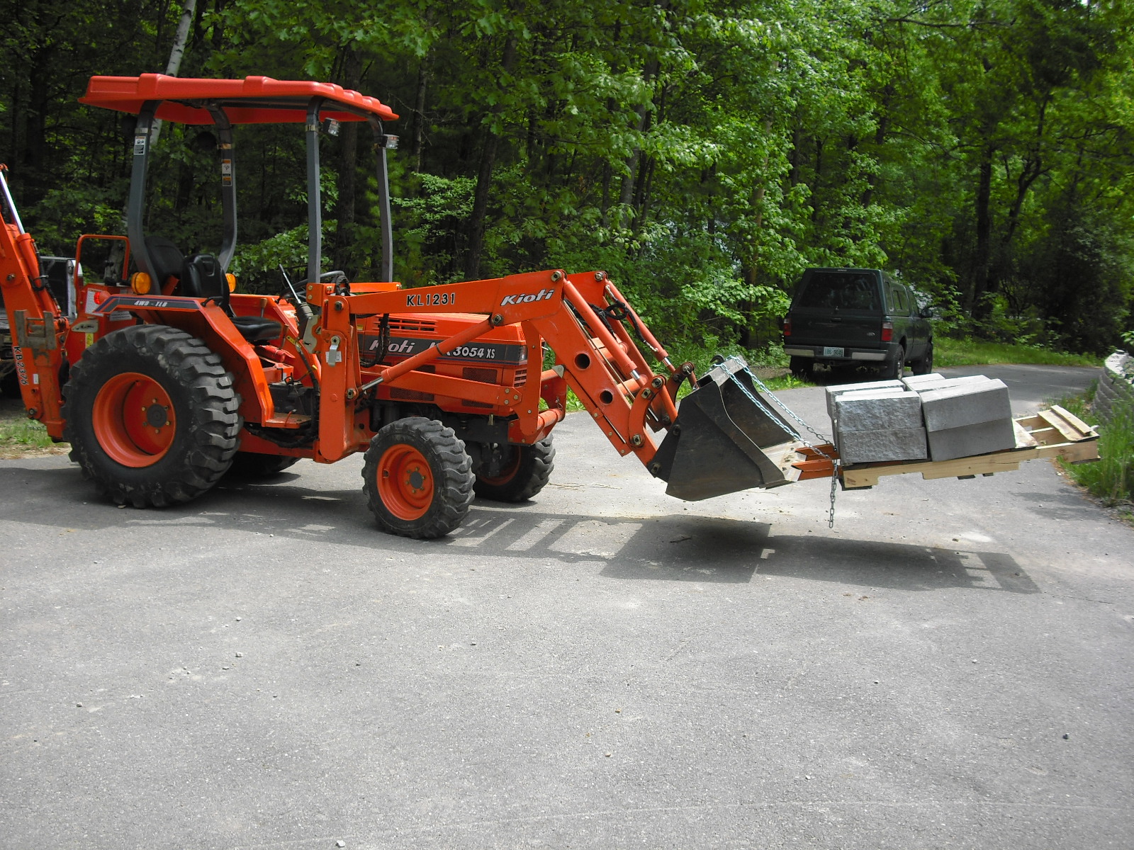

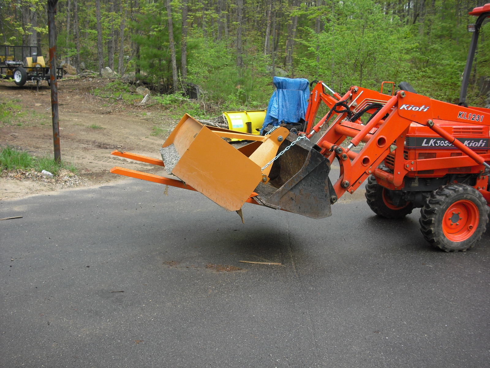

Here's some pictures of my homemade forks.
They work excellent for me.
I've got about $40 into the two of them.
I would not use bucket lip mount forks without a nice cutting edge on the bucket, otherwise I'd be affraid of bending the bucket edge which is something you don't ever want to do.
