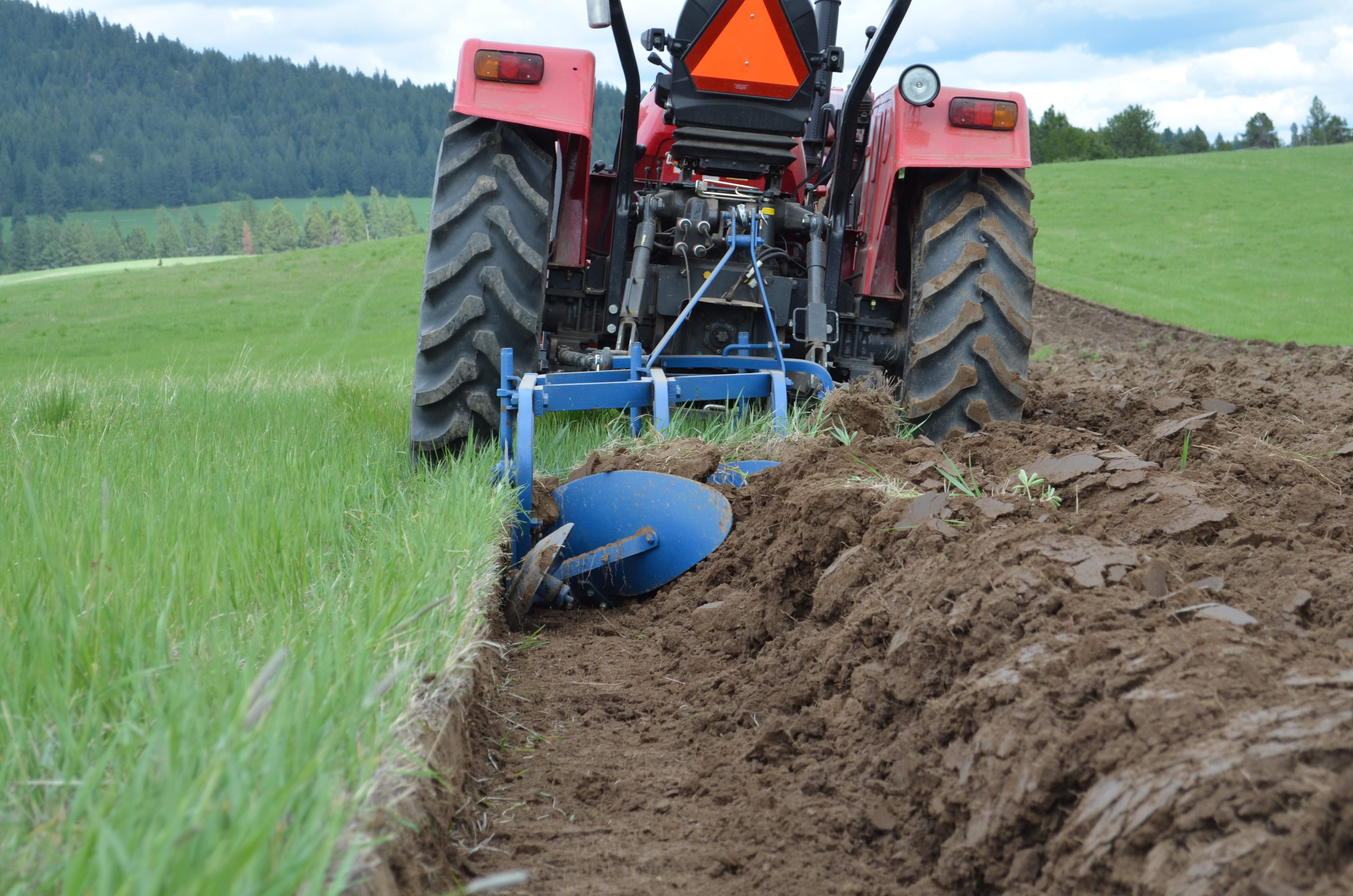

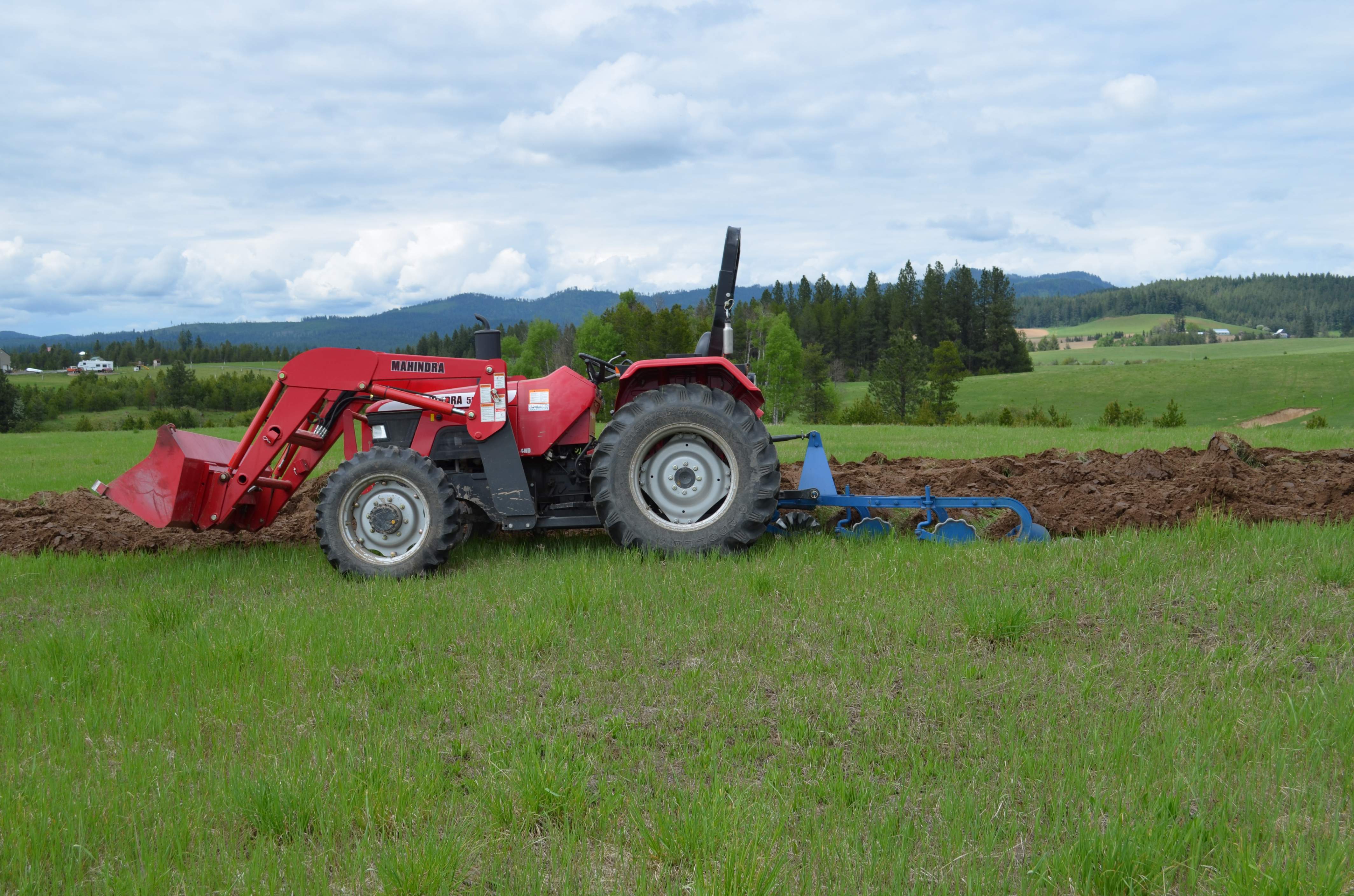

I have a 5530 Turbo 4wd and I pull 3x16's @ 8" deep. No weights except a 266ML loader with the bucket for plowing. My plow is Ford/Dearborn 10-209 with coulters. A 6530 should have no problems with 3 16's.

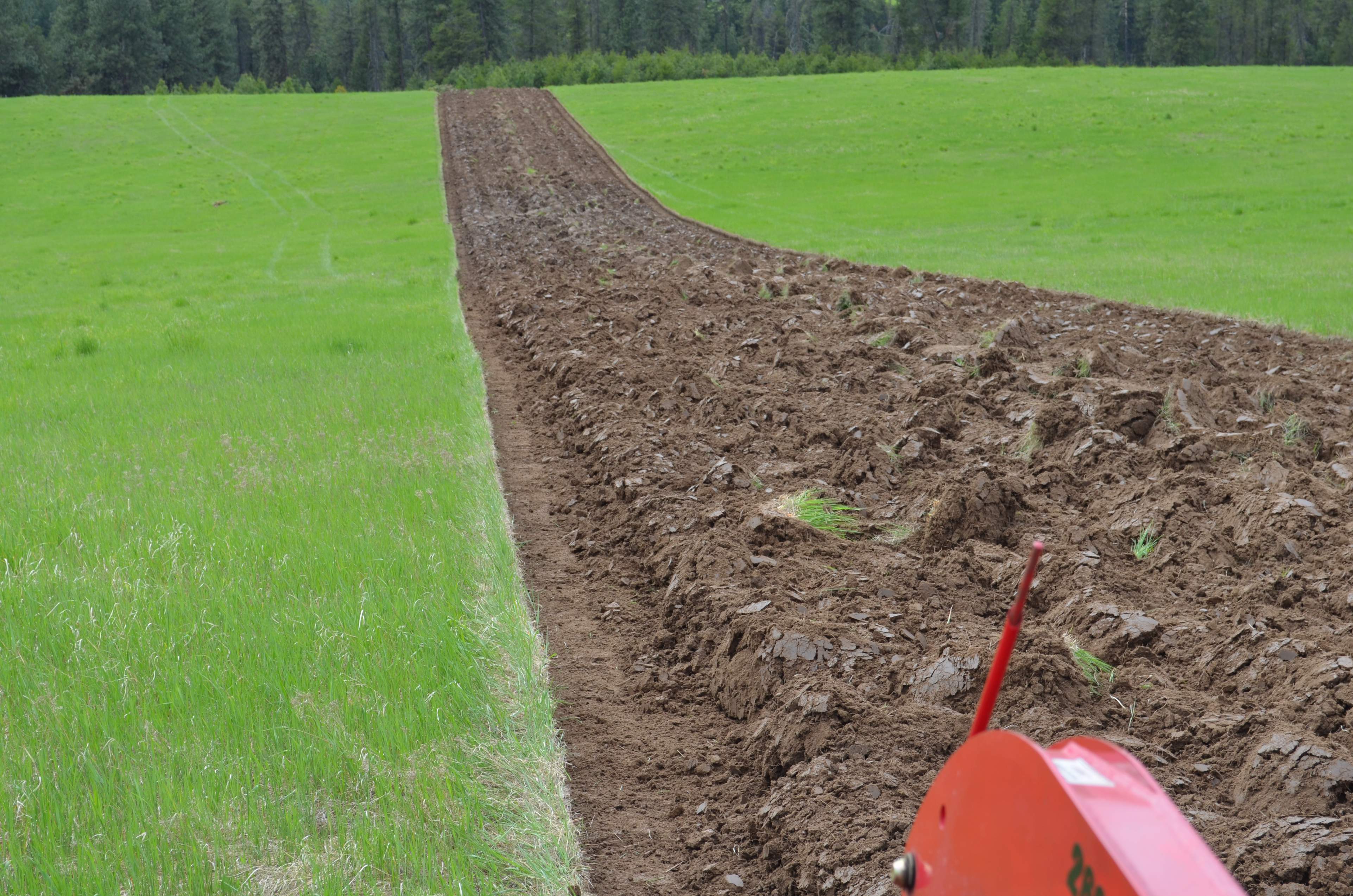

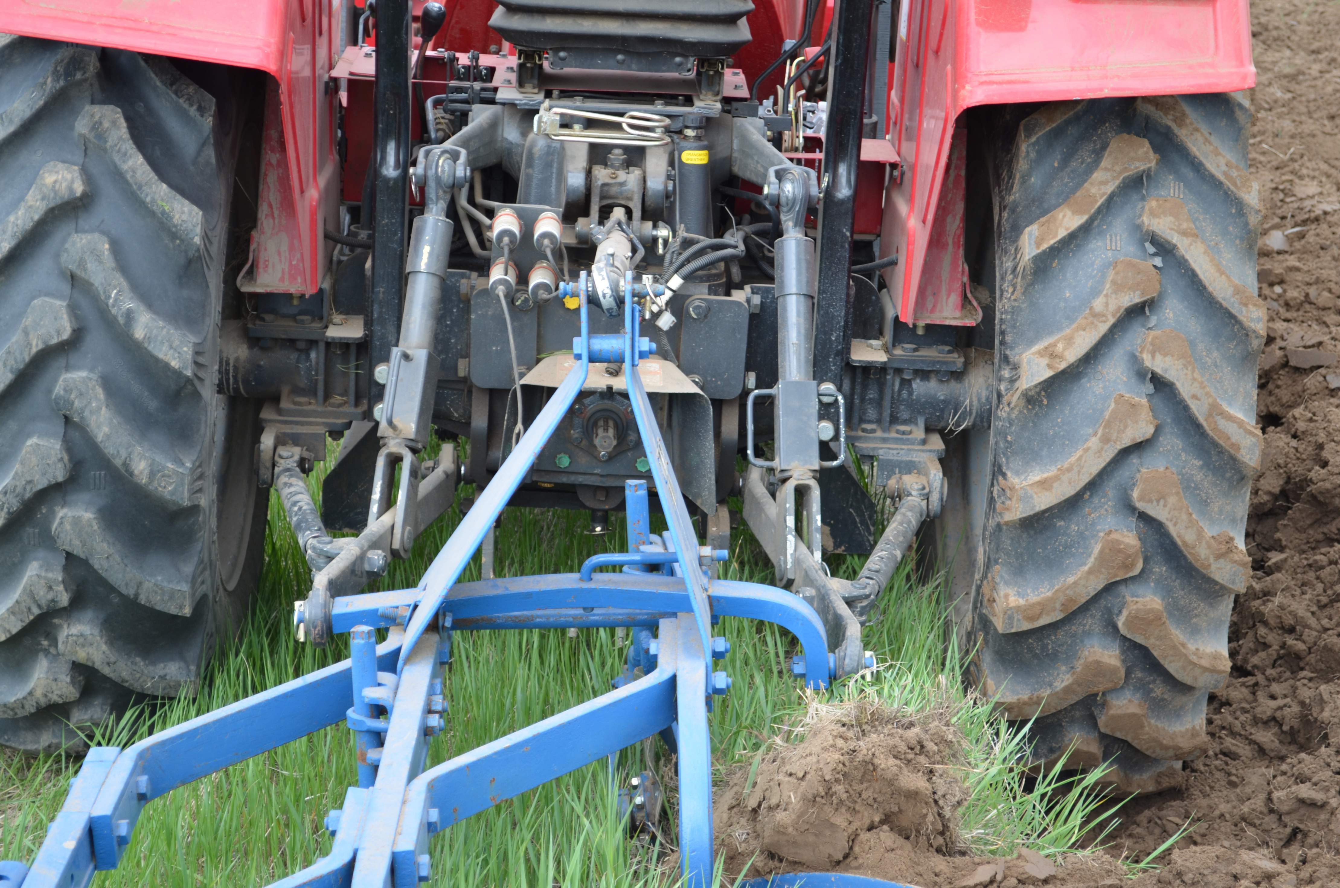

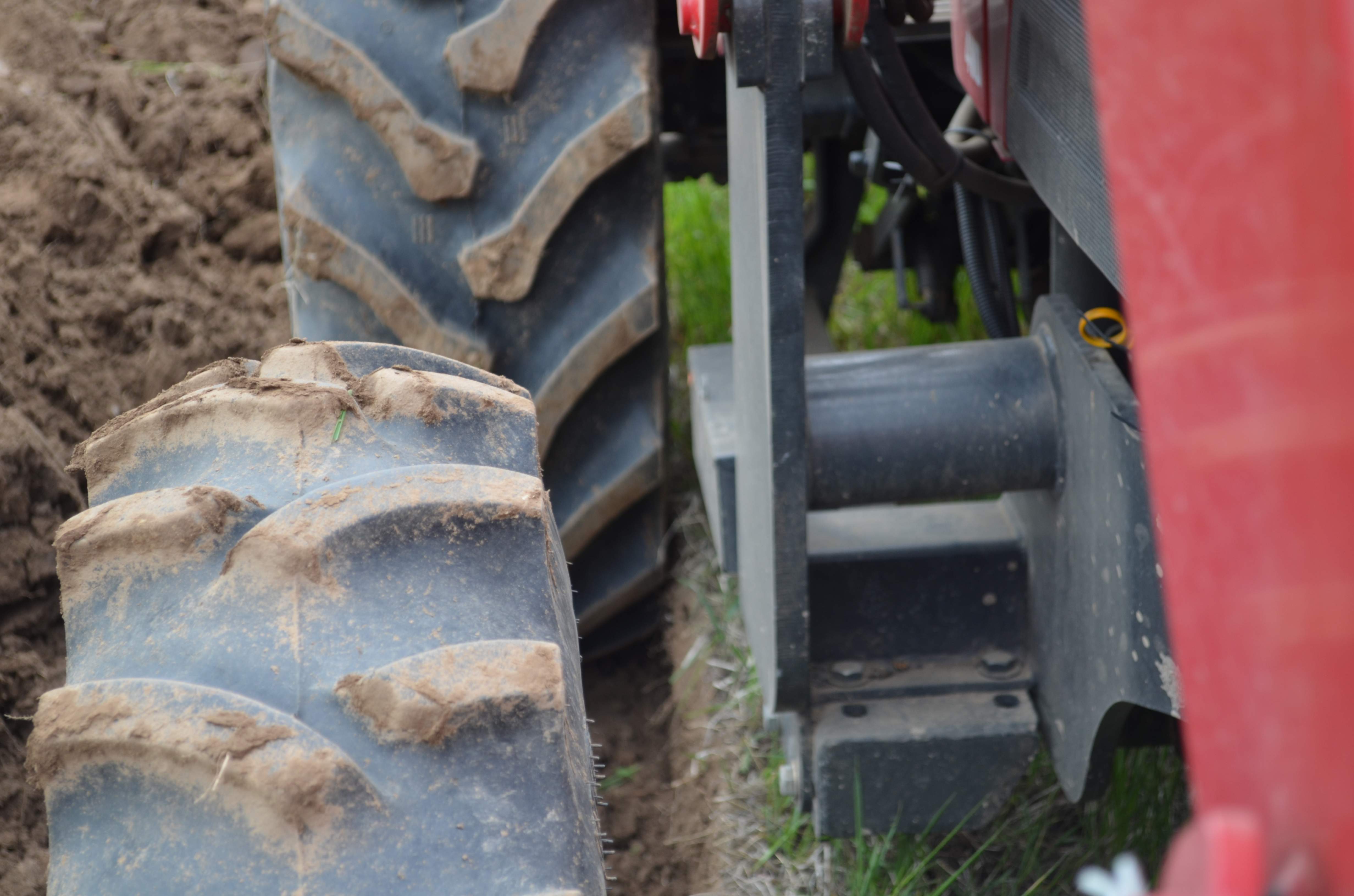

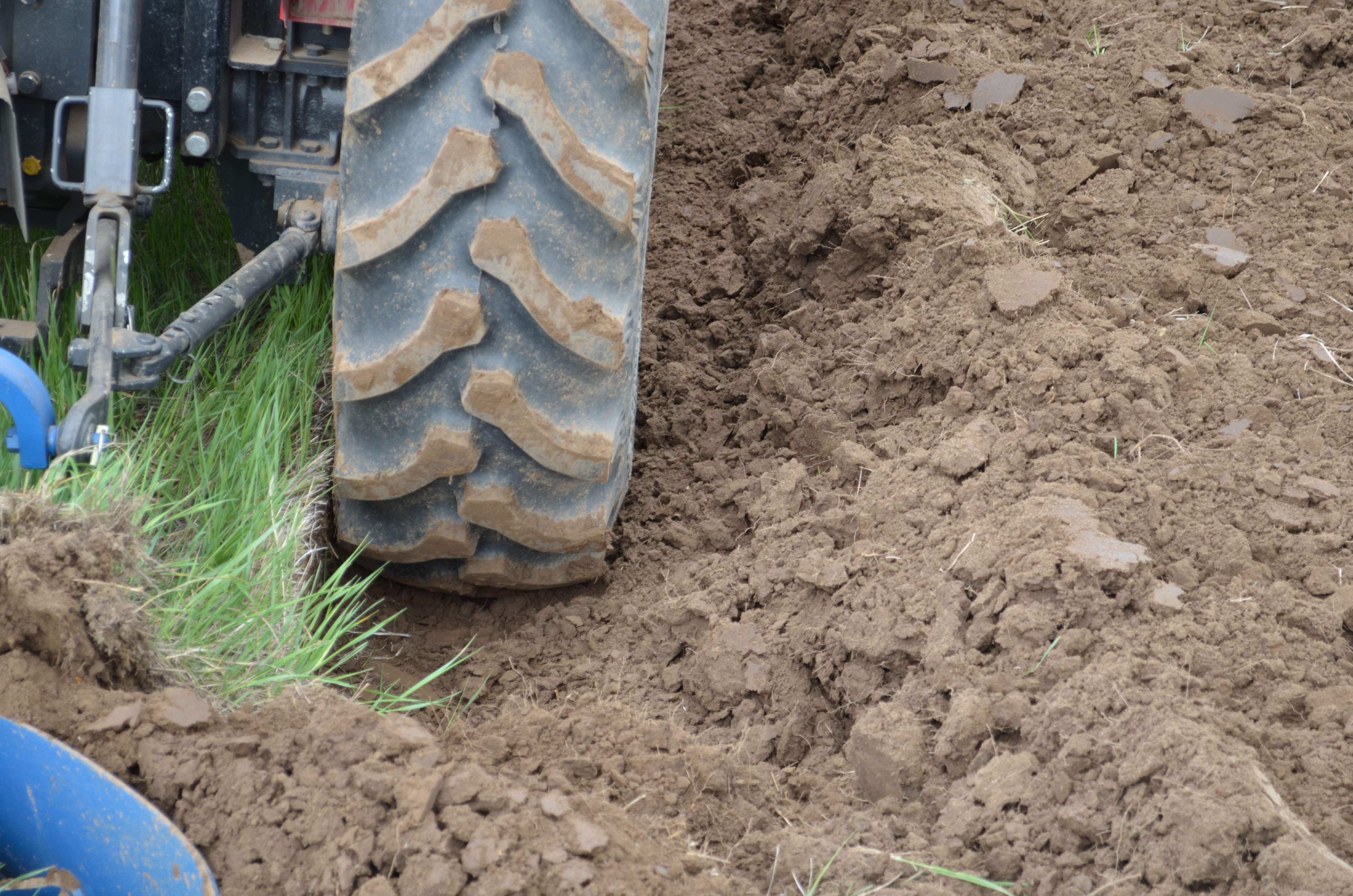

Idaho2, On the 6530 with the wheel stance my math showed that I would be over lapping a little and cutting 44" with each pass. It looks like this is no problem from your pictures. How good does the draft control work for you with the mounted plow?
   / moldboard plowing 6530 #10
RMOMN,
Draft control holds nicely at 8". Just be careful when lifting the 3pt that you do not accidentally move the draft control handle. Regarding your measurements on the rears, I get 48" plow width. Getting a 3pt plow setup takes time and if I plow this spring I will tweak it a little so that it follows the tractor straighter then what you see in the pics. I've attached a few photos of mine.
