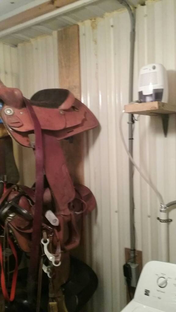

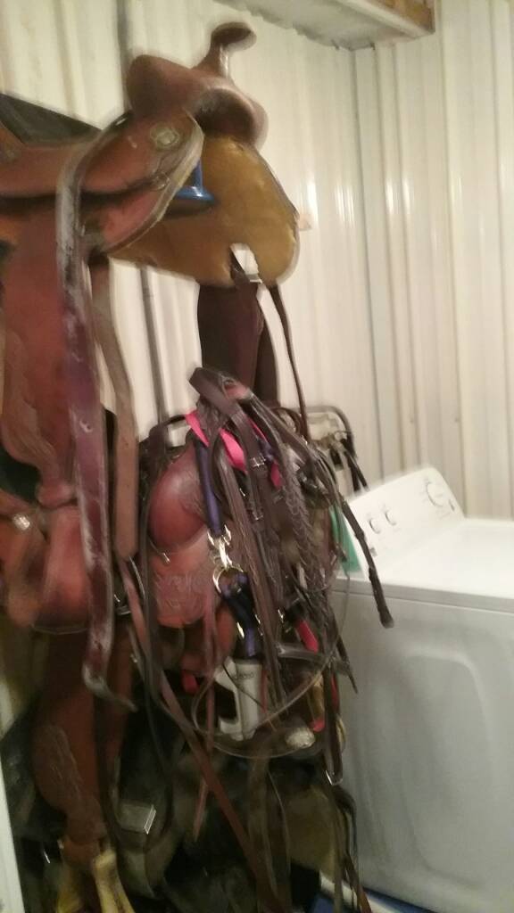

One is there are two adjacent rooms in garage, a bath/shower and laundry.

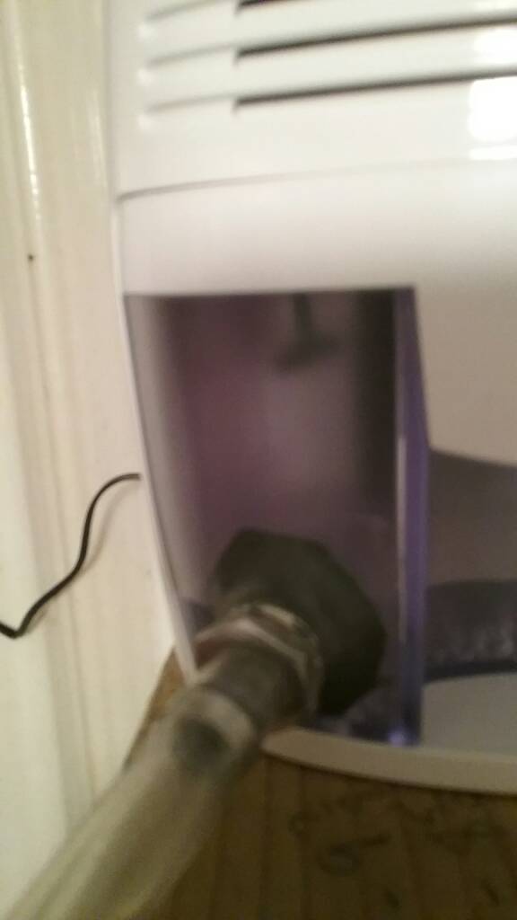

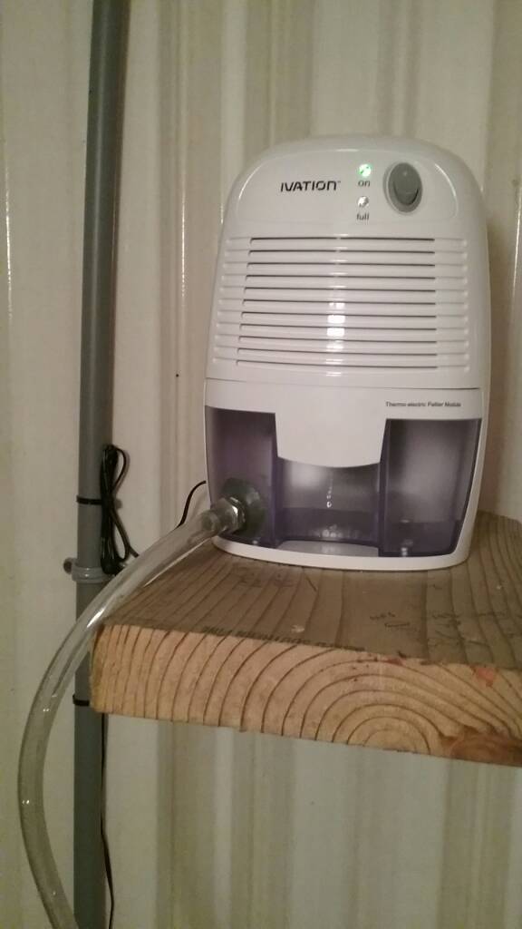

The laundry we were using to store tack and it was getting mildew, as well as garage. Garage I bought a large dehumidifier with pump, garden hose to outside. "Tack" room has a good door sealing off from bath but I got this $35 dehumidifier ordered through walmart.
It has a 2L container you empty, but I drilled and tapped a pipe fitting, JB welded in and clear 1/2" tubing goes into washer drain I taped off so no moisture.
Two weeks, so far so good.

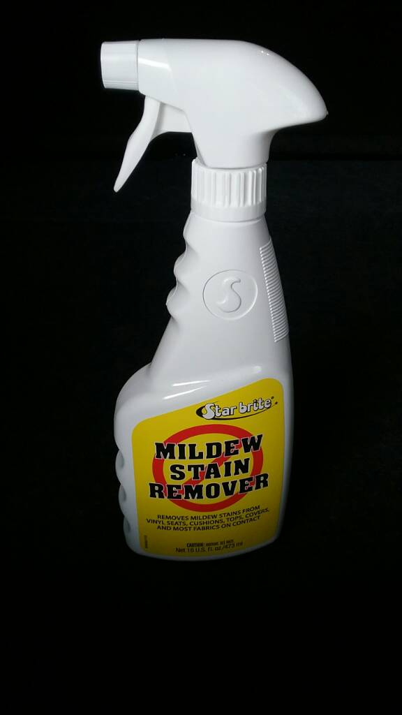

Other is neighbor's Cadillac white vinyl top he tried everything to remove mold spots, but this Starbrite spray worked.
