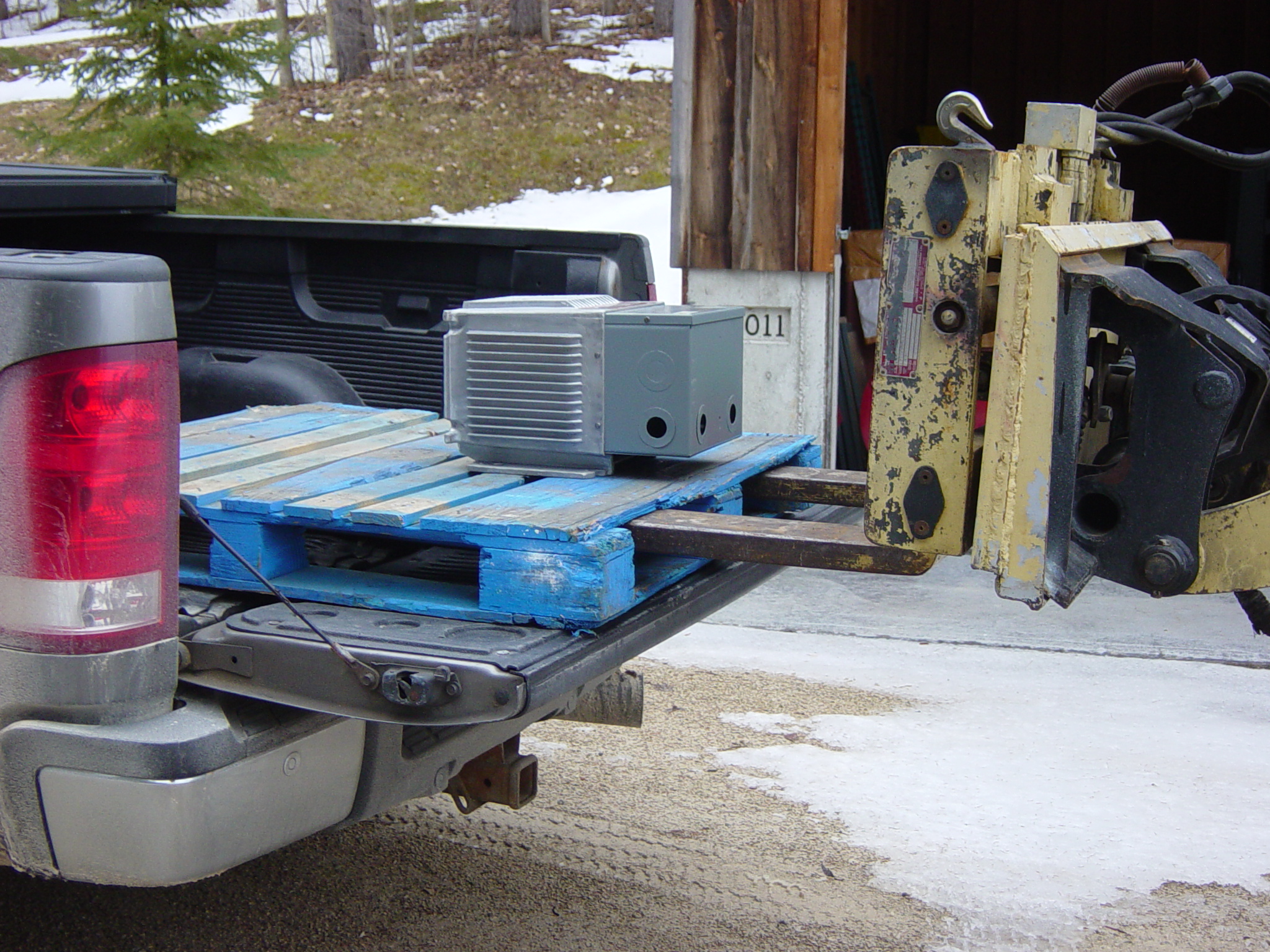

It SEEMS that the highest quality inverters STILL have output transfomers.
It's why I am working on a generator project. Cummins/Onan Quiet Diesel 7.5 Inverter style generator, that I am putting a two hundred pound 10 KVA, transformer on,
one to make 120/240 since it only makes 120, and two, to provide that buffer, which seems to be so important. Like I said, I am no fan of inverters. This is an experiment of sorts.
