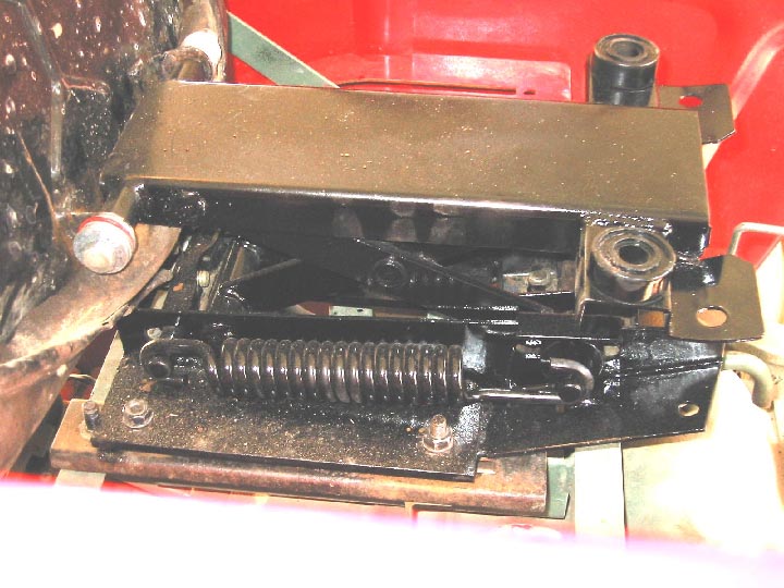

Scotty,
It is a pretty nice setup that Ford has. It added some badly needed leg room by moving the seat back and a bit more height. I was able to use the old Yanmar slide to reduce the amount of fabrication I had to do.
The bottom of the assembly required some trimming because it was designed for mounting on an angle. After it was trimmed I welded a flat plate on the bottom and bolted on the old Yanmar seat slides. It was finished with some gentle massaging with a hammer and anvil to get the seat hinges to fit and a quick coat of black paint.

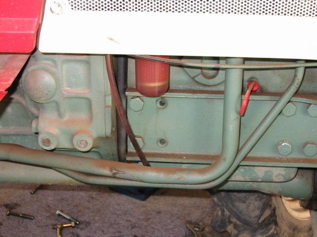

After finishing the seat, I started fabricating some of the loader mounts that will be used to mount the Ford loader to the Yanmar's frame. Here is where I plan on bolting the right-rear loader supports to the the tractor. The first thing I need to do is to shim out area on the rear of the frame rails flush with the clutch housing. This will provide eight threaded locations to mount the new plates. On the right side I will need to move the hydraulic lines to make room for the new plates.

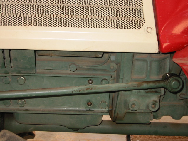

This is the other left side of the tractor where I need to shim the frame flush with the clutch housing. In this location I will need to modify the steering linkage to clear the area where the loader mounts are going to be. I am pretty sure that this will require that the linkage be fabricated to go over the loader mounts to provide for adequate clearance. Whatever I do it will be a tight fit!

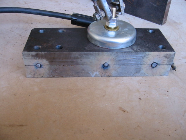

These are the shims that will fill the frame rails. They are two 1" X 3-1/2" X 10" plates that will be bolted to the frame. I have them tack welded together to aid in the alignment for drilling the mounting holes. This will be the finished thickness of the shims and the location of the mounting bolts.

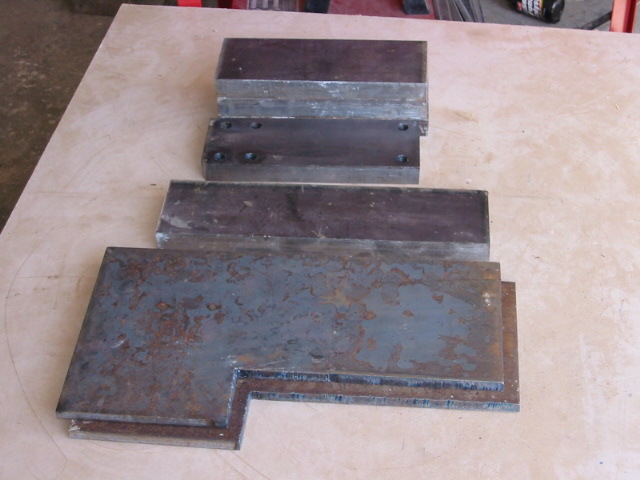

These are all of the pieces that I have cut so far. On the top are three of the frame shims. Just below is a shim with holes drilled that was used as a template for the other shims.
The next longer bar is a 1" X 3-1/2" X 14-1/4" that will be mounted under the transmission. This transmission mount will connect to the plates on the sides of the clutch housing and to the rear-end of the tractor.
The two "L" shaped 1/2" plates will span from the frame shims to the clutch housing and connect to the transmission mount. This will function as the new mounting surface for the Ford loader mounts. The width between the plates will be the same as the with of the Ford 1320. that it came from.
