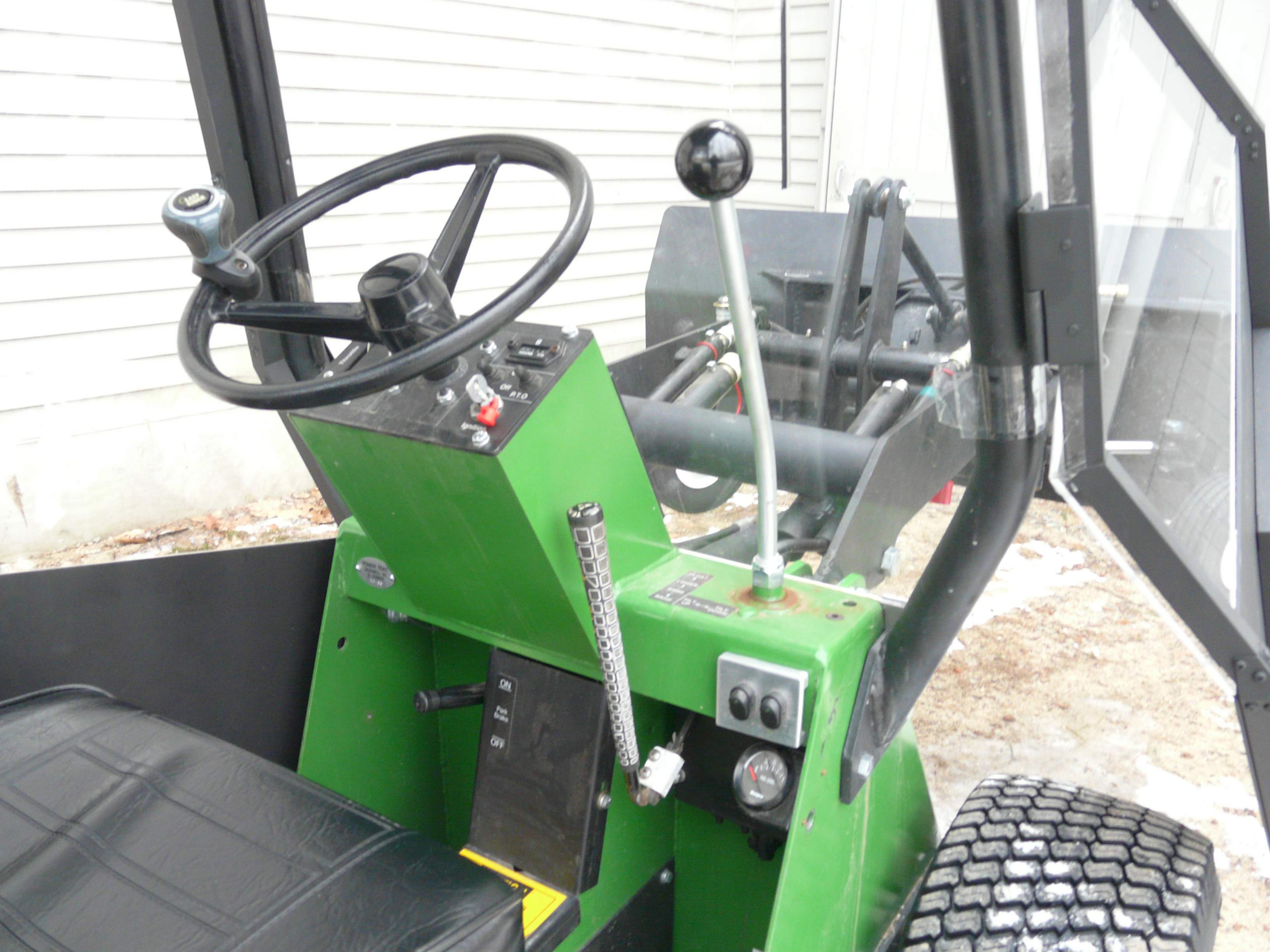

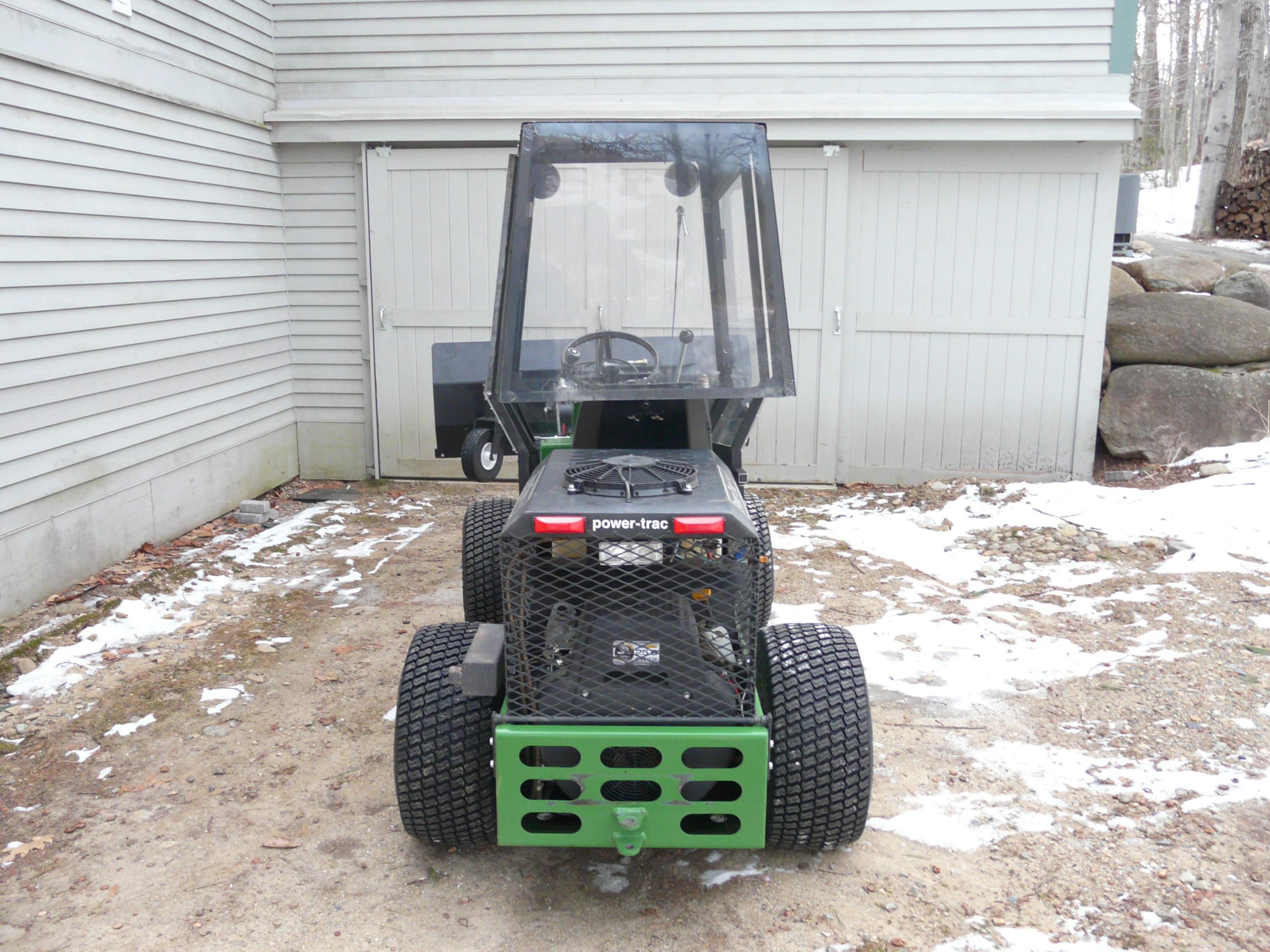

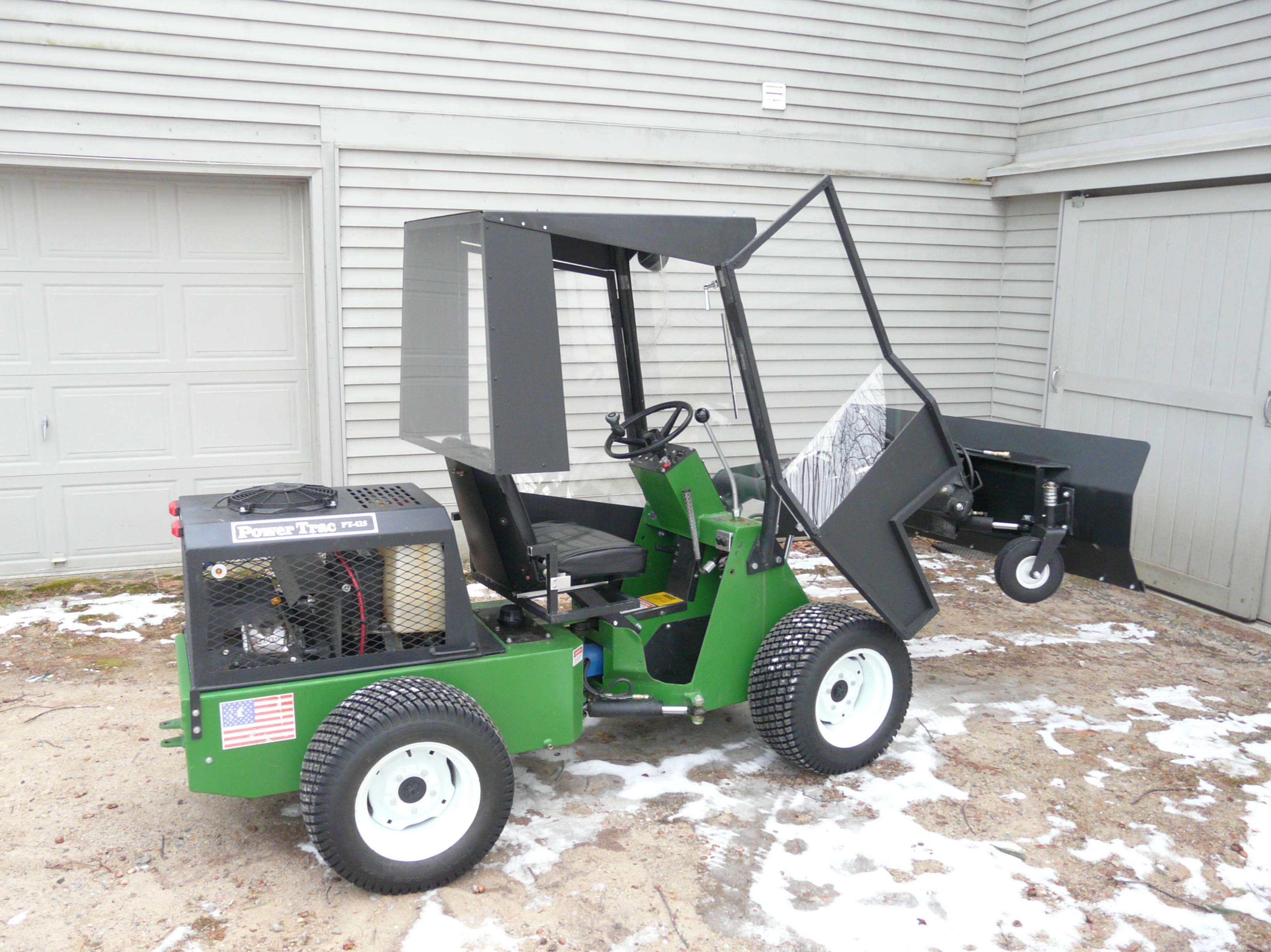

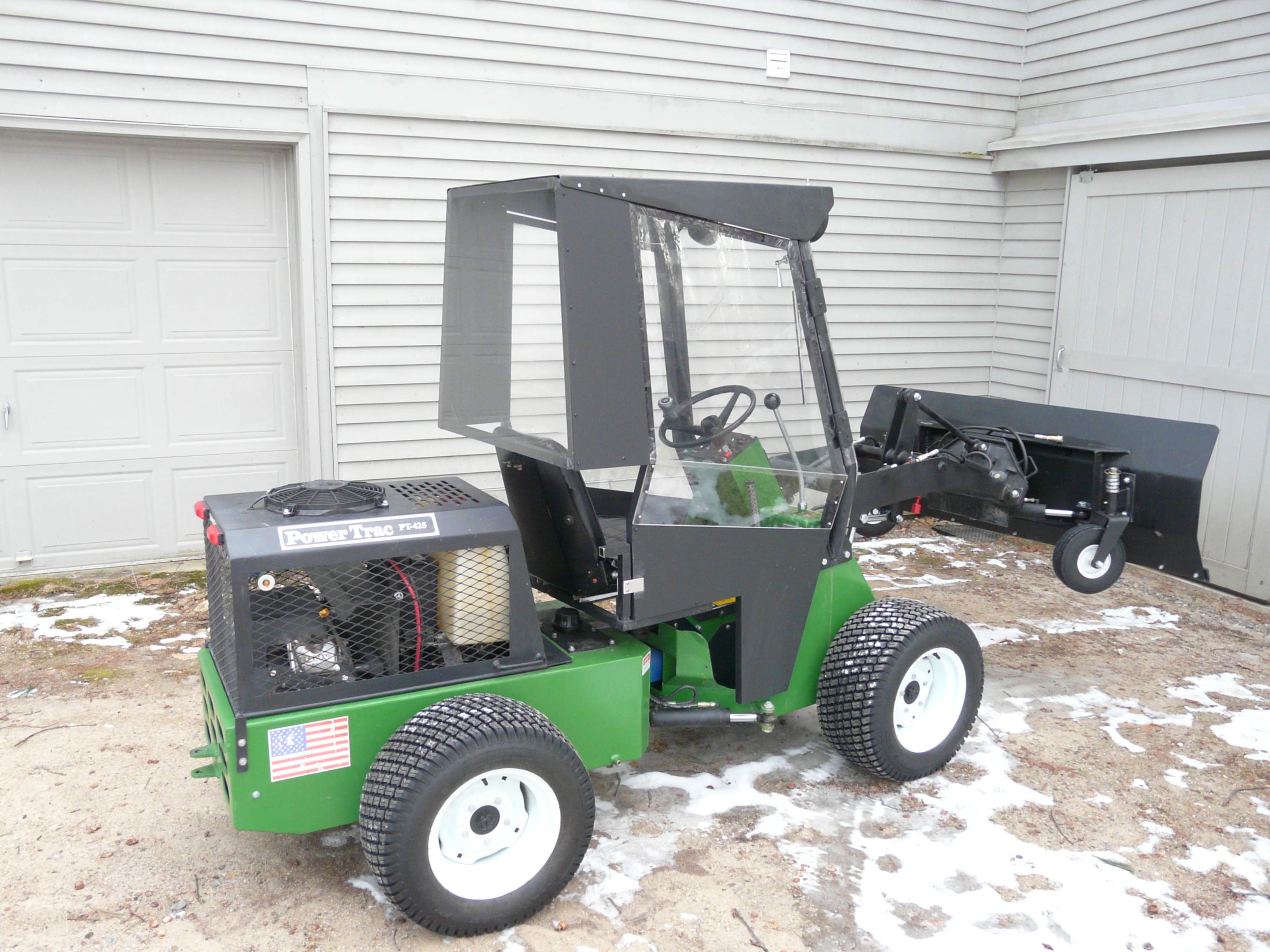

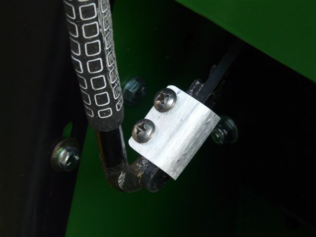

Attached are some pictures of the cab and other modifications I have made, a lot of which I learned from members at this site. Everyone here is great for all kinds of ideas and help.
My Modifications:
1. Moved head lights to top of ROPS - I did this mainly because I use my PT a lot in the dark during the winter for moving snow. When the lights were mounted low, they just shined at the back of the snow blower.
2. Added Suicide Knob - makes steering with one hand very easy. I would call this a necessity.
3. Added Rear lights - the red ones were just so people could see me at night and are wired into the headlight circuit, the white one is for backing up, on its own switch.
4. Added Gas Gauge - I wanted to know how much gas I had left without having to get off and check, this has been very useful.
5. Added Lighted switches on dash - current only one is used for the white backup light. I wasn't sure how to mount the panel but the switches fit so well in the holes, I just push them in and the panel stays in place, nice and tight. The panel is 1/8" aluminum, still to be painted.
6. Added Extension for the quick attach lever - I have the backhoe attachment and this modification is really a necessity. Bracket is made from aluminum and attaches a steel rod (bent and ground flat at the end) to the existing handle, no drilling or threading of the existing handle. Cover is a golf grip.
7. Cab - I need something to keep the blowing snow off me when using the snow blower, but I also wanted it to look good, like it belonged there from the factory. I debated whether to use the ROPS or not, not using it would have been much easier, but I decide for safety sake I should use it, so I came up with this design. I moved the ROPS up as far as possible to have room for the joystick and steering wheel and it gave me just enough room so I could mount the windshield (1/4" Plexiglass w/hand operated windshield wiper) on the ROPS without interfering with them. Door frames are made out of 1" square aluminum with a lower panel of 1/8" aluminum, middle panel of 1/4" plexiglass and the top section of heat shrink plastic. Doors are mounted to the ROPS with a removable hinge so the doors lift right off the hinge for easy removal. The pieces for the door are held together using a piece of 1/8" thick aluminum cut at the proper angle and width then inserted inside the tubing and held in place by drilling, taping and screwing together. The back panel is a combination of the 1" square tubing and the 1/8" alum sheet for the sides, back window is heat shrink plastic. It is held in place by 3 screws on each side into the ROPS top. I was very pleased with the result looks good, gives great visibility, doesn't feel cramped, keeps the snow out, is fairly rugged and is easy to remove for summer by removing 6 screws.

I guess you have the cab, but are there any lighted switches that can stand being exposed to the outdoors...

Dear Carl,
There are lots;
Toggle switches
Marine toggle switches
Rocker switches
Otto Rockers
The first two are drop in replacements, while the latter three are designed for marine (i.e. harsh) environments.
West Marine has a lots of other ones. I tend to prefer marine switches, since they are generally designed to withstand a little more abuse than other types. Look for marine, or direct spray or IP6 or IP7 rated switches and you should be good. Just don't plan on power washing your dash with your power washer.
That's a whole other level of water resistance.
All the best,
Peter

I did not know that on the power washer... Guess this stuff is splash resistant, not water resistant...

Carl,
You bring up some good points. The concept of water and dust proof is a little complicated and the ratings aren't linear, in the sense that IP-67 may not be better than IP-66 depending upon your use. IP-68 is tough to find.
People often leave off the first digit, if it is 6, since waterproofness implies dustproofness in general, so IP-67 is often referred to as IP-7. (That's clear as mud, right?)
Technically, the ratings are IP-(Number 1)(Number 2)(Number 3) . The first number specifies foreign body protection (e.g. dust) and the second number refers to water. The third number relates to impact resistance and is not commonly specified

There is a similar, but different code from the National Electric Manufacturers Association, NEMA. NEMA 4 is roughly IP67.
See Understanding IP Ratings for more information.
Note that under IP-67 that limited water ingress is permitted under high pressure washing. Two things result from that a) the switch can have water in it after being pressure washed and b) that a drain for the removal of water is not allowed. Do you really want water staying permanently in your switches?

Well I am impressed. That is the best looking cab that looks like it belongs and most importantly I could build. Do you have any plans for closing in the back section or is that part of your project for heat.
There have also been a few requests, myself included, who would like some pics of your snow blower. So don't hold back any longer. Video would be even better;)

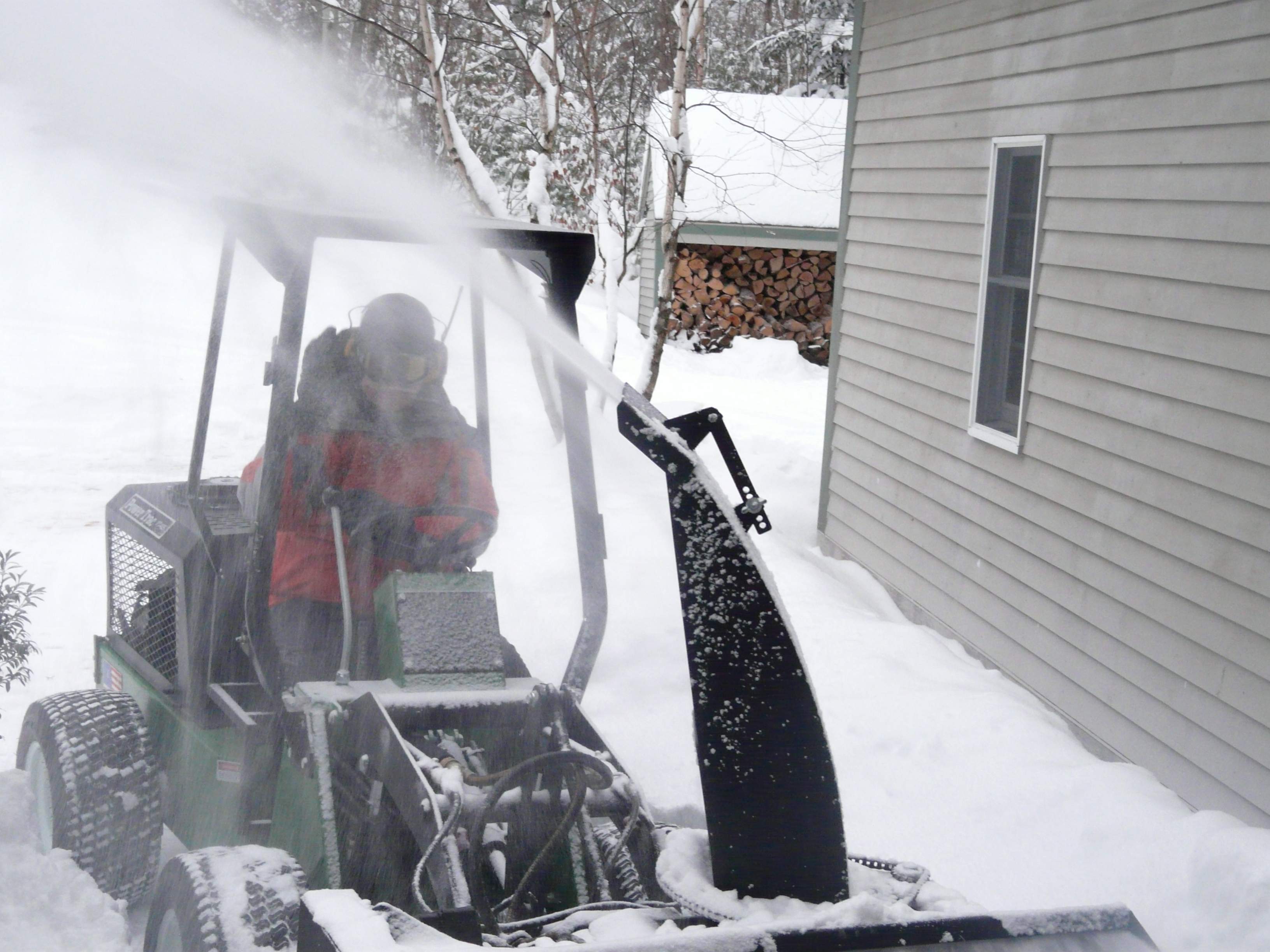

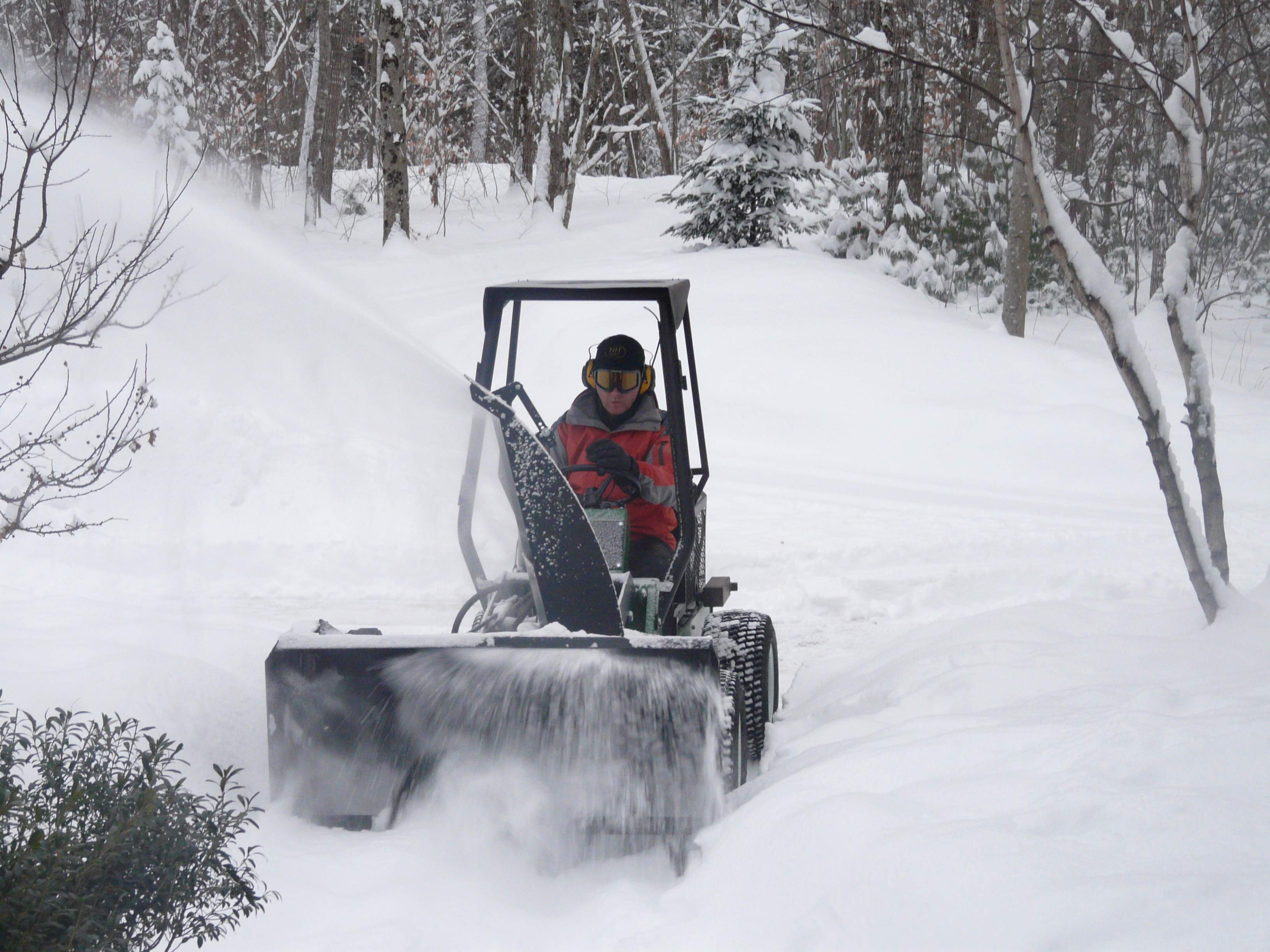

I have attached a couple of pictures of the snow blower in action, but I don't have video. These were taken with over 1' of snow while the cab was in process of construction last year. You can see from the last picture why I wanted the cab, the snow blows in you face quite a bit.
As far as finishing the enclosure, I am thinking of using some canvas attached with velcro. I think it has to be flexible given the various positions the rear of the tractor can be in because of the articulation. It is still a work in progress, but I'm getting close being finished.

Thanks for the pix. Do you find that you have enough horsepower. I tried to convert a single stage for use with the PT, but found the hydraulic PTO was not enough. Do you have good snow throw distance.

A question and an observation...
How does the chute on the snowblower get turned? I'm gonna take a guess and say the main PTO powers the blower and the AUX PTO knee lever powers the chute rotation direction, but just want to confirm.
I think your idea about using fabric to enclose the bottom is about the only way to go. There is a ton of flex in the unit when it articulates AND oscillates. I have the factory arm rests and they will rub the engine cover when I am in full articulation and oscillation.

Duane - there is plenty of power. Sometime when it is deep, over 12 inches, you have to go slow when you have to take a full pass, but that is the same with any snow blower. You have to match your speed with the amount of snow you are moving, but I find it more that adequate. I do use the engine wide open as suggested by Terry for max power.
You are correct MR, the AUX knee lever turns the chute. Since there are no stops on the chute, it does go around a complete 360, so you have to be careful or you can send it right back in your face. I have come close, but that is another good reason for the cab!

It has been a while since you posted on this thread and I wondered if you have done anymore with your cab, Like the heat project or finishing the back lower part

Unfortunately, no. Last year was so mild and snow-less up here in NH that I hardly used my PT at all. I hope to work on it some this winter, especially closing in the back. Taking the heat off the engine was not reliable enough. I don't think I need the heat anyway, I'm not in it long enough. I'll post some pictures when I get it done.
