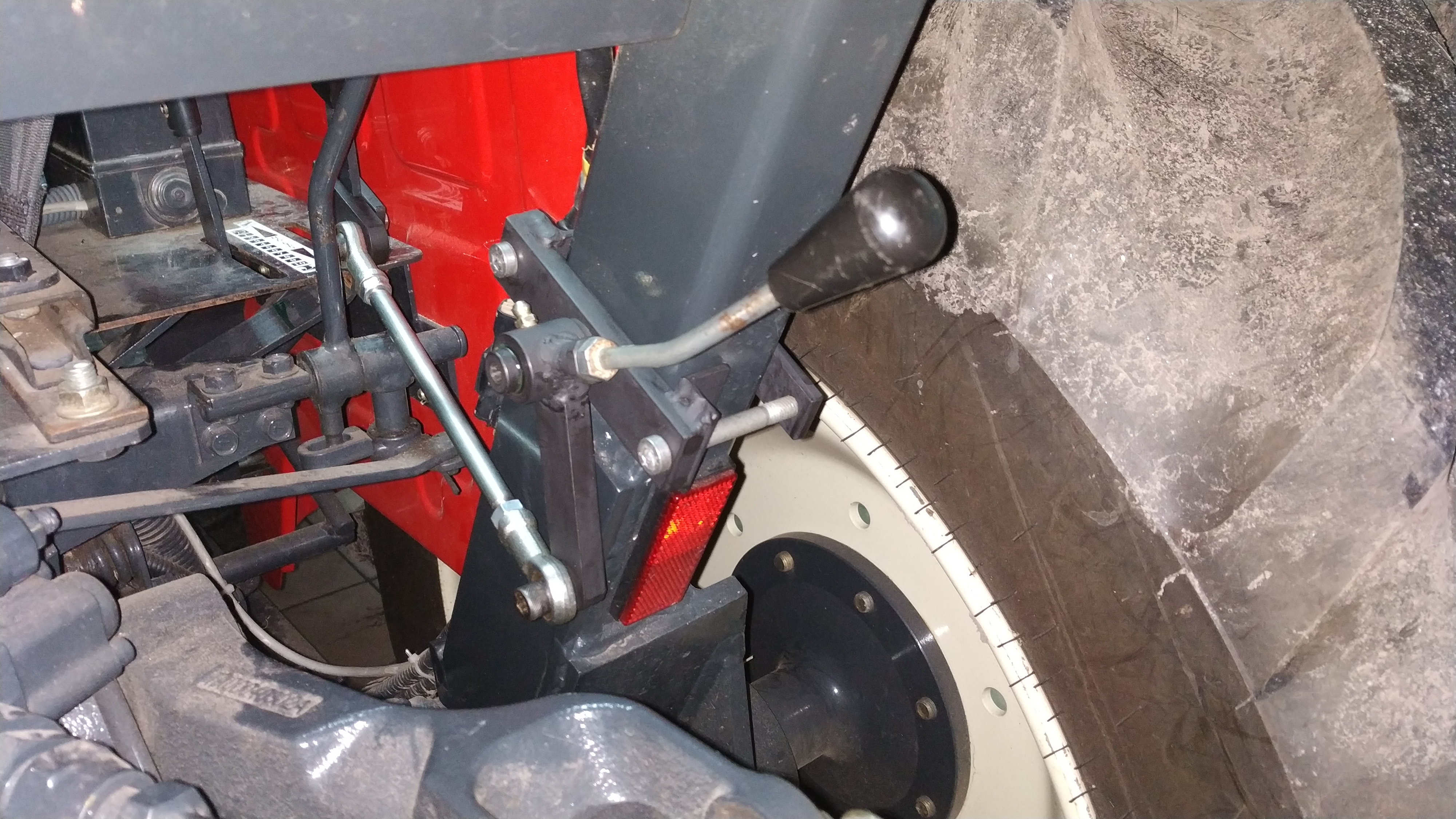

While I don't have a Kioti, I did add the rear 3 pt control lever on my Branson. I'll leave a picture just to give some ideas. All of this is reversible as there is no drilled holes anywhere. Just parts that clamp over the factory ones.
Mine is fairly easy to do as there is pretty much a straight shot to the back. Can't remember how Kioti is setup though.

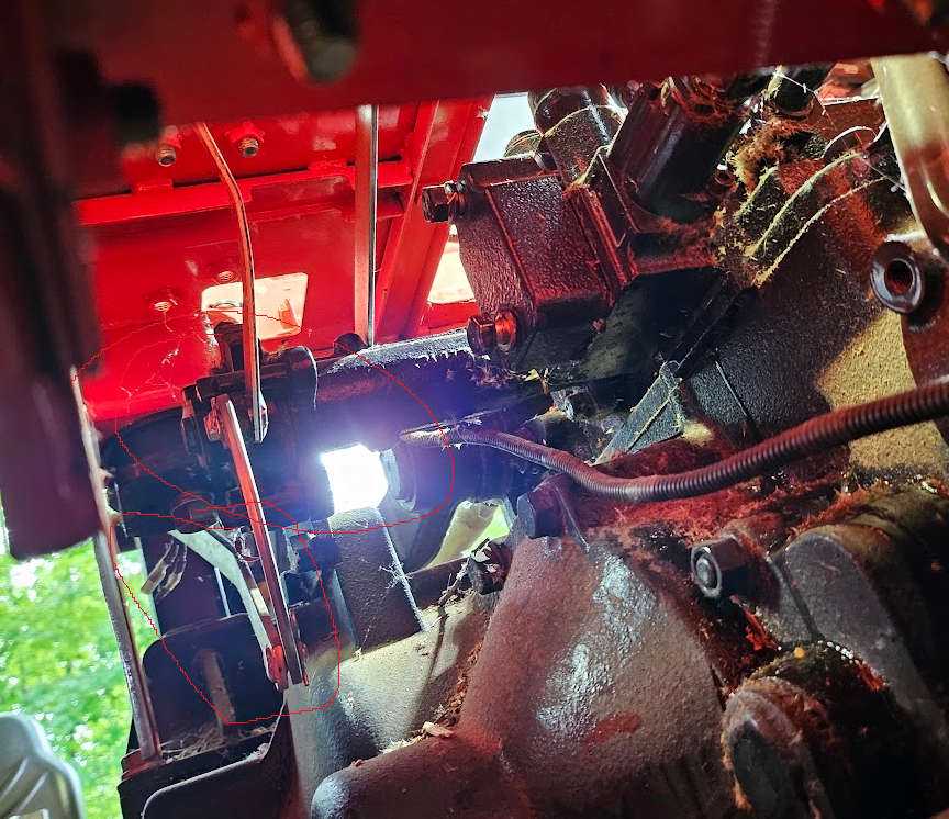

Here's where it connects on a Kioti DK4210.
You could look under yours and see where the lever from the seat area connects.
Some ideas here: anybody add a rear 3pt hitch lever?

Thanks. I’m going to have to think about this. There isn’t very much visible on Kioti with a cab compared to my Kubota without a cab.
