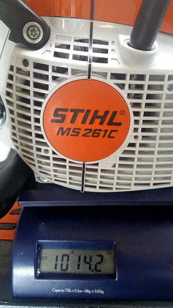

Sort of double posted, I posted the following in another chainsaw thread. But, I've decided that for the cost to upgrade, if an MS261 C-M is able to called an upgrade.... I'm going commit to keeping this nasty beast, the 026.
I was really twitching to go buy an MS261 C-M to replace my 28 year old 026, but my father smacked me around a bit and might have knocked some sense into me
Instead, since I have a perfect running 026, I decided to treat it with a Forester tune up kit, new 18" bar, chain and file combo and also 2 more chains.
I also ordered a bar/chain combo and spare chain for a guy at work with a smaller Stihl.
This will buy me another 2 years, maybe 3 instead of paying $535 + 6% Pa sales tax on the new MS261 C-M (I get 10% off).
I'm still twitching a bit, just because I'm addicted to shiny new things! IMG_20180328_153756602.jpg

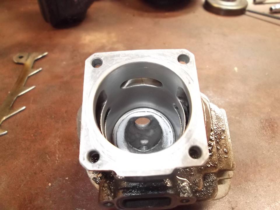

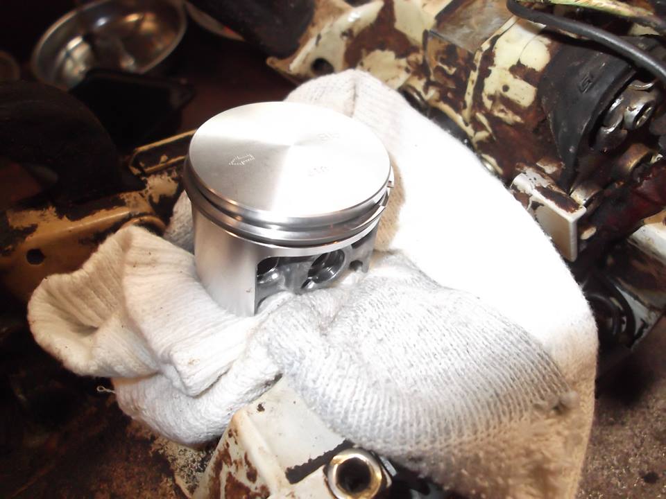

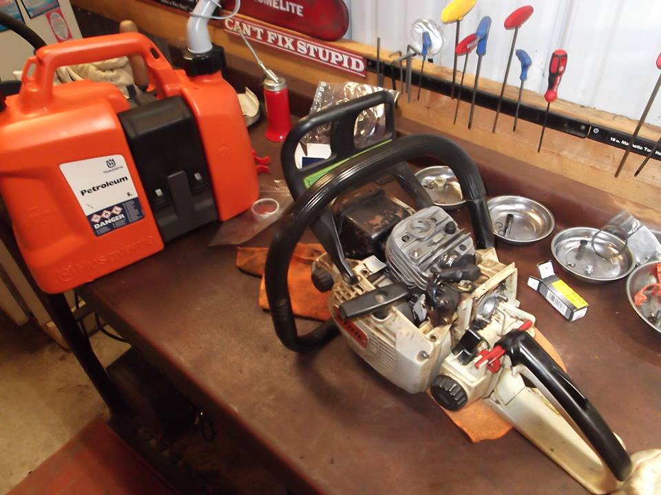

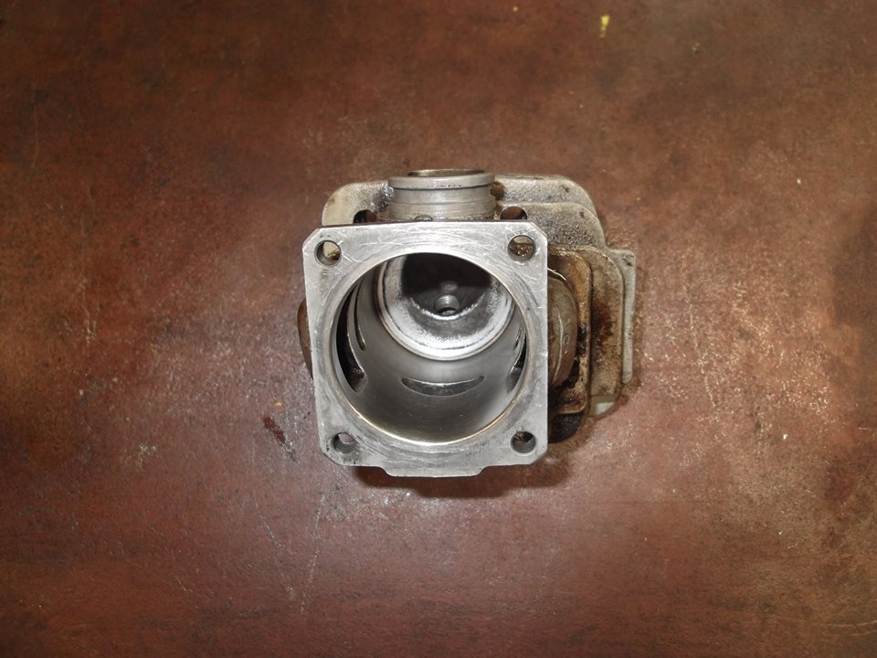

Just muffler modded this 026. Sounds pretty good to me for 44mm 49cc.
Gave it a new heart yesterday and cleaned up the scored cylinder and then put a fresh crosshatching in.
