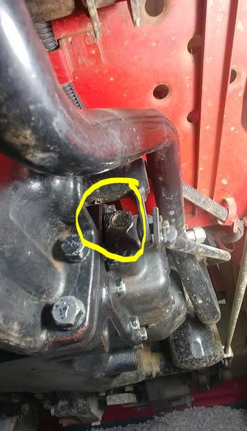

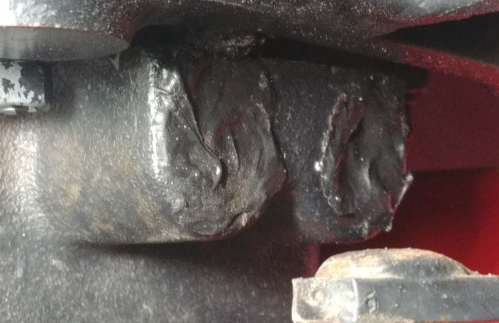

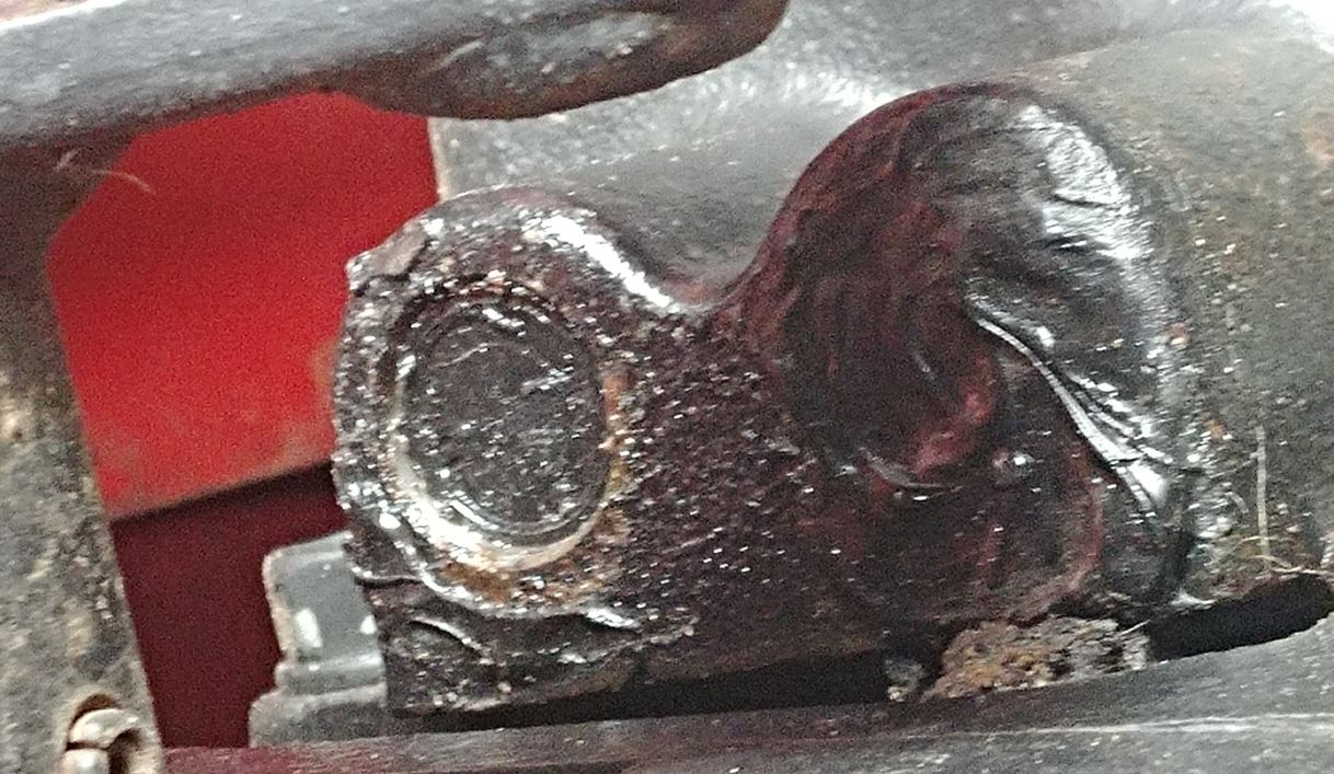

Model 2816: I bought a 2816 a few months ago with only 74 hours but weathered, runs great! Yesterday while moving some firewood, all of a sudden hydrolic fluid was draining from gear box. After Inspection, I found that a plastic screw in plug was covered with silicone and the silicone came loose and hydrolic fluid came out quite rapidly.
Does anybody know what is supposed to go in those holes? they are on the front left side of the gear box. One picture is where I took off the silicone.

Not sure but it obviously isn’t right. Can you tell if it’s threaded or just a press fit plug? If the tractor is weathered some of those press fit plugs are known to be made of pot metal and will rust out quite easily. You would be able to pop the old ones out and find a replacement at an auto parts store.

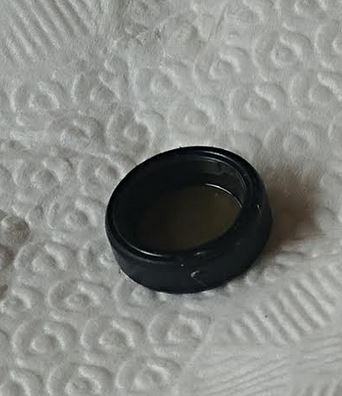

Yes it is a plastic plug with rubber side. It must have shrunk over the years, so someone covered it in silicone. What is the best way to handle this? Is it a safety release?
Should I put a new one in and hope I don't lose all my fluid again?

Ok, I think I fixed it with a Baitwell plug!

gear box. so it's gear drive, not hydro static trans?
just trying to clarify and get a better idea of where you're saying these two plugs are located exactly.
a zoomed out picture would also be helpful to get a better ideal of where you're working.
easiest way to help you.

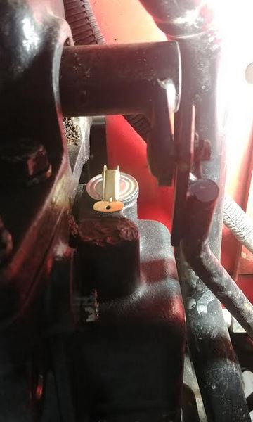

Ok, Problem Solved! Let this be a lesson for everyone! My breather tube, behind the seat, between the arms of the 3pt. hitch, was totally clogged. It was shaped like an n (weather head) so no water would go in. When I tried to unscrew it, it hit the bracket that held the seat. So I got my grinder and cut off the top. Took it off and it was full of oily dirt. So I air pressured it out and cleaned it good. Put it back in and hose clamped a flex hose up and down so water and dust won't go in. Then I took the original plug and pushed it back in the hole, put some silicone over it and waited til the next day to test. That was it!
It was building up pressure and it pushed out the safety plug.
