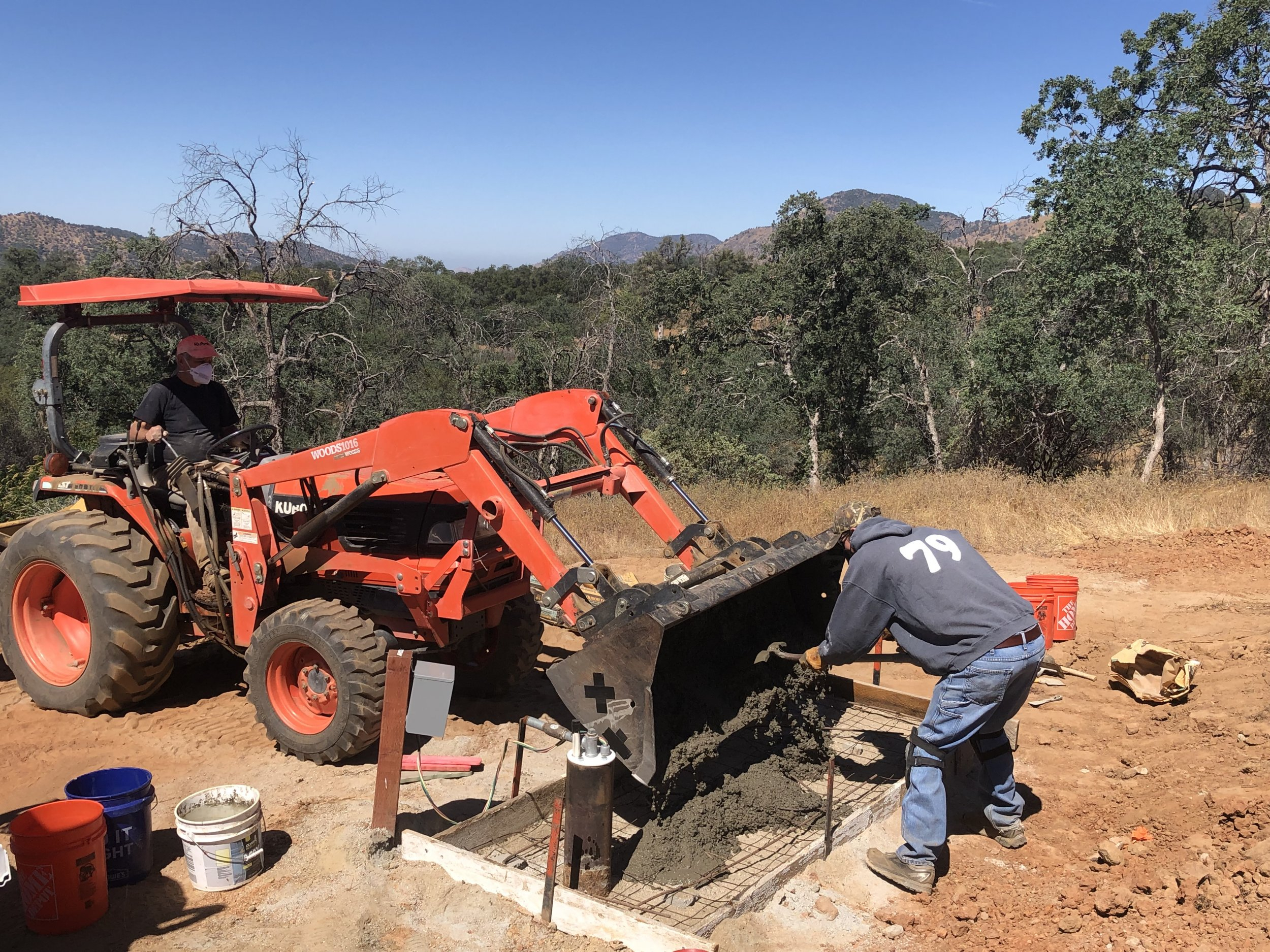

I need to pour a pad (3.5' x 8' x 4" deep) and have bought enough 60lb bags of concrete. The forms are built, with wire and rebar. It is on a hilltop where I don't have electricity but will bring up a generator and a HF mortar mixer - which I have used effectively before to mix concrete in 5-gallon buckets. The job is too small for contracting out and a bit too much to contemplate mixing concrete bag by bag in buckets - and that would seem to be a bit slow as the first buckets would be setting up while I was mixing the other bags. So - my idea - to speed up the process is to bring up a few trash cans full of water and mix the concrete in the FEL bucket. Raised up 2' and tilted back it seems it will hold quite a bit and another advantage is that I can then dump it - batch by batch - right into the form. Anything I need to consider?

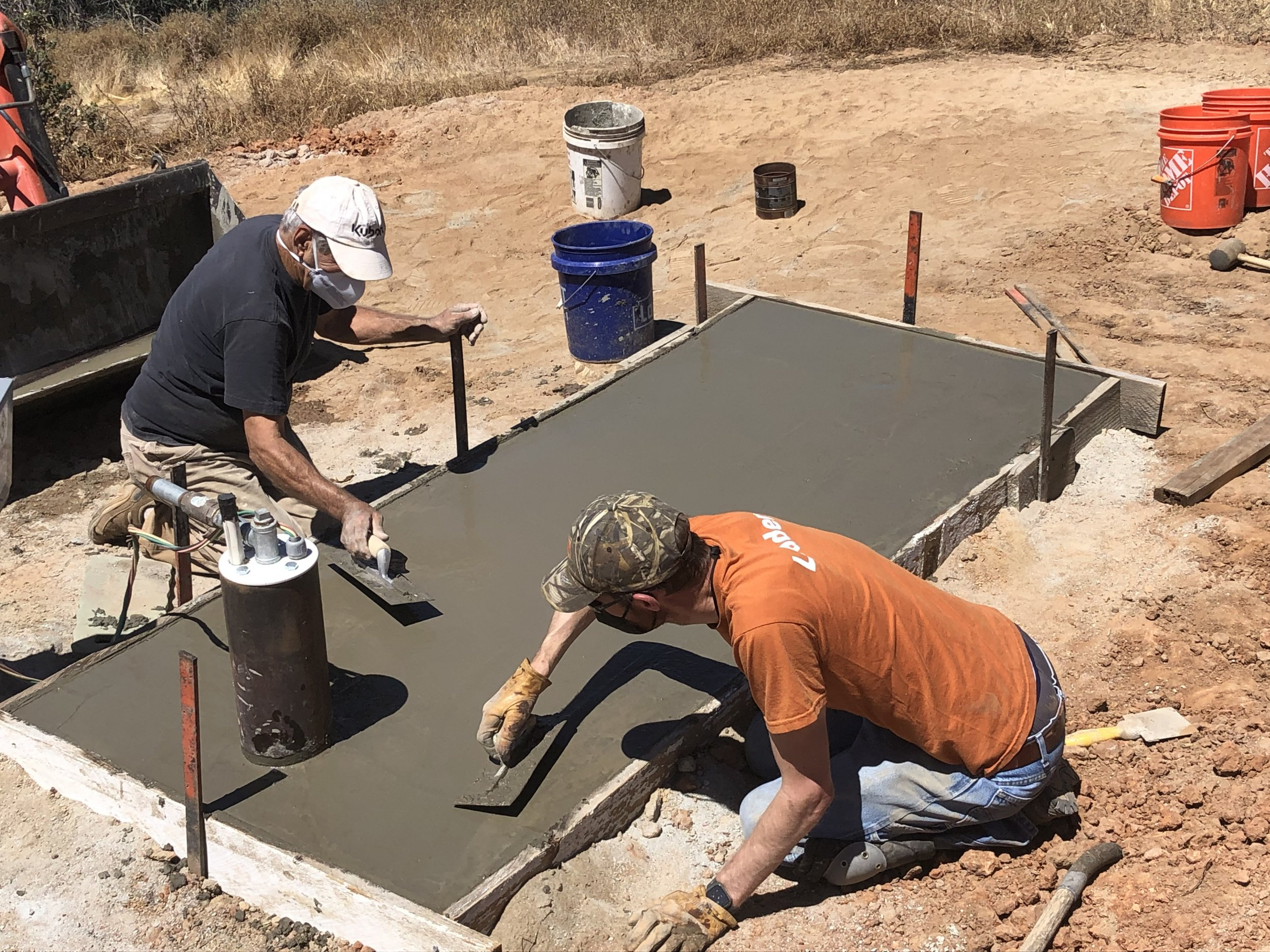

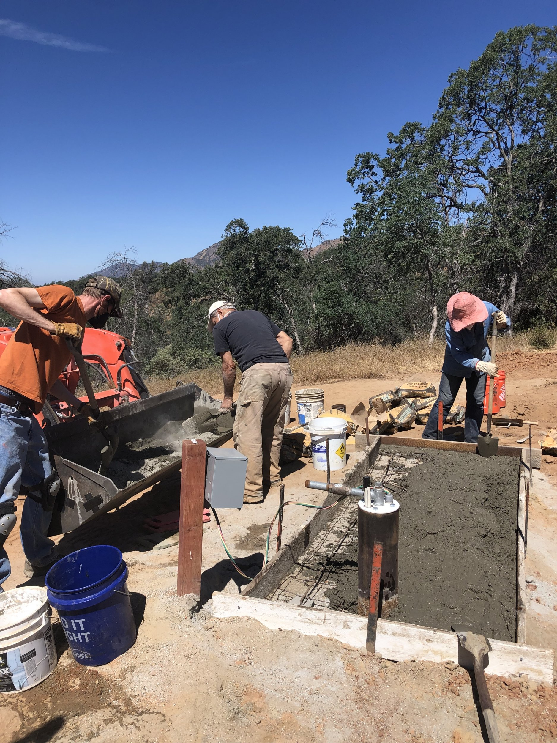

Okay, finished it, so my update:
Took the tooth bar off. Loaded up garbage cans with water- and smaller buckets to bail it with. The form already had rebar and wire. Coated the inside of the forms with cooking oil. Lined up the FEL along the form (3.5 x about 9' - and set to be about 5" thick). I put duct tape over the holes in the FEL - on the outside. We started with 5 bags in the FEL - added the water as needed and mixed it, and then when it was ready - dumped it into the form. Decided 4 bags at a time would be better so did that. Kept doing that until the form was full - screeded and banged the form sides a bit. Finished it off and then misted from time to time with spray bottles. It took under 2.5 hours from prep to clean up, and went really well. Cleaning out the FEL was not an issue. Just dumped the extra water in and scrapped and brushed it out.
So, the answer to the question about can you /should you mix concrete in a FEL is yes.
Helpers: SIL, wife and daughter. Pics attached.
