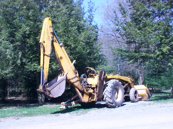

   / Mixed tire types #2
My backhoe has 14.9 x 24 R4s on the rear, but they are more like an Ag tread R1, with swept back 45 degree angle like an ag tire, but with a large rounded button in the middle to make for a much smoother ride. I'm posting a rear view picture for your viewing pleasure, and any comments. I bought these as blem tires. There was a very slight almost unnotiable area where the side walls are not perfectly smooth. They have been on the hoe since 1988, are 8 ply, and have neve given any trouble. Got em for $165 each, including mounting. I bought new tubes at $25 each, and their she sits, just fine.

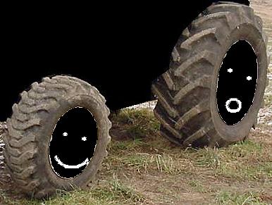

   / Mixed tire types
I've attached an image of the tires (I apologize for the smoke & mirrors guys - I'll be glad to give all the details after I get it home, if I decide to pull the trigger). /forums/images/graemlins/tongue.gif
Can you identify the rear tire type for me? Is it an Ag or some type of R4? -Bruce.

   / Mixed tire types #7
I would get the numbers & brand of each pair of tires, & run it past a tire guy. I would be suspicious of this setup being good for the tractor. It should have 0 - 2 % faster front than rear. If it was used a lot with a different ratio, you could have a lot of heat & wear on the $$$$ parts of the drivetrain.
It's rare that different tires will mount on the same rims, or match up properly with each other. You raise a good concern here, good question.
If you want to put it back to matching tires, you may need to buy a set of rims to get you there. Consider that in the price.
Then again, everything might be timed out properly. It's a guess from here. /forums/images/graemlins/smile.gif
