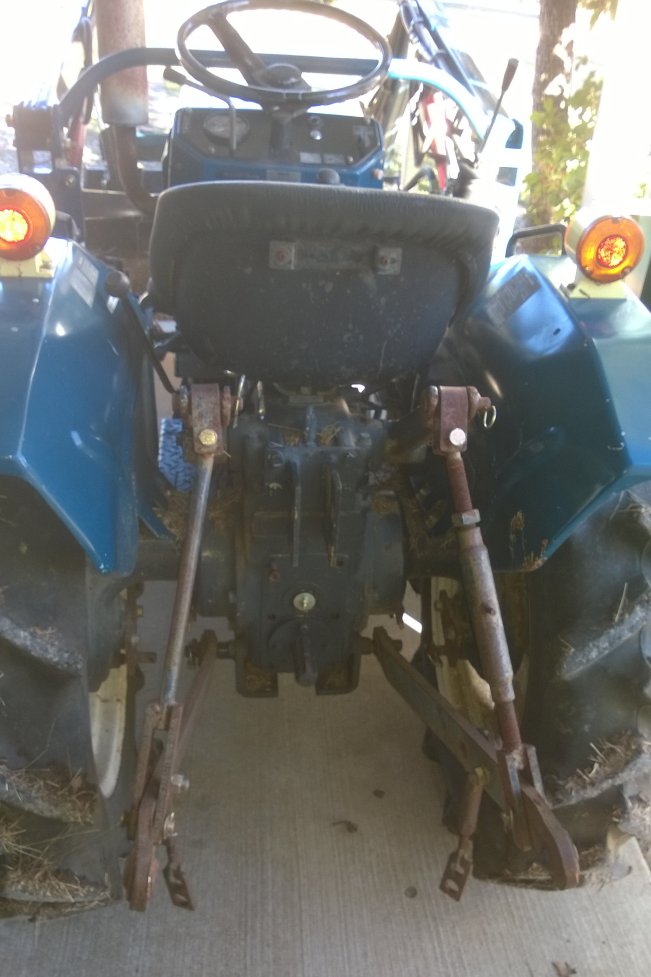

Need to get my lift arms to go wider (for some Cat1 implements that I cannot turn the pins to the inside). Found some longer arms with offset at Hoye tractor but I'm not sure if they would work. Anyone have experience with this issue?
Thanks, Mike

Hello mike, I have no experience with that tractor and don't know if it's possible, if they make wheel extenders you could move your wheels wider and give you more clearance between your wheels and maybe your three point arm will swing wider and also give you better stability.

Sometimes you can switch sides with the rear tires to take advantage of the dish on the rim? Ken Sweet

i used a quick hitch and put the pins facing inward to clear tire chains on my old kubota.
