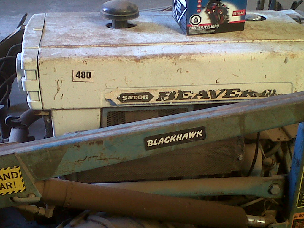

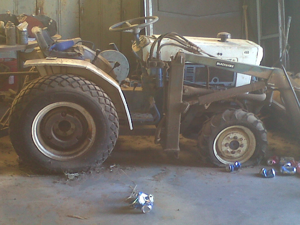

Mitsubishi Beaver III Satoh 480
Father n Law is giving me a Mistu tractor w/ front end loader. I only have pics to go on at this time and am trying to find more info on it and possibly a svc manual. I did a search in this forum for a Beaver III 480, but nothing comes up. Can anyone help me identify this machine and point me in a direction to find the manual and any info on this model?
Thanks!

A Beaver III would be a 373. A Buck would be a 470. Never heard of a 480. The 480 decal is not original. I bought a set of manuals for my 470 and they cover the 373 also. They are the same except for engine size. Got my manuals at www.satohparts.com

I'm inclined to say the "480" you're looking at is a unit number, possibly from a rental facility or something. The Beaver III is an S373 by Satoh, parts and manuals are available from Valley Power and some others. The tires are mismatched, obviously; you'll be wise to make sure they're the correct size for the drive ratio.

Not really sure about the weight, but based on evidence in your first pic, if your tractor would curb its drinking problem, its weight would surely go down...
