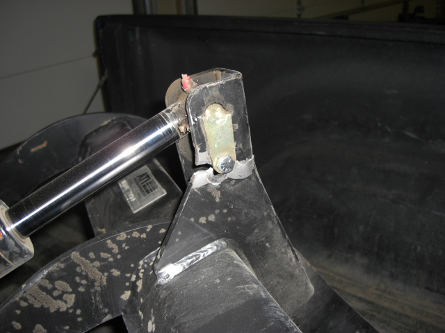

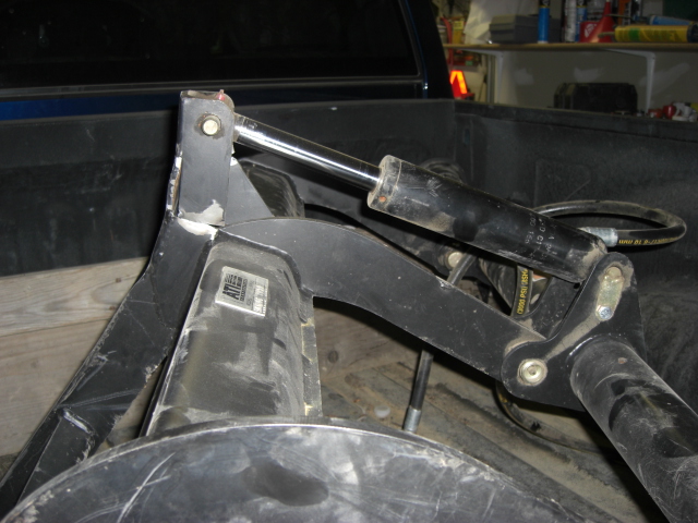

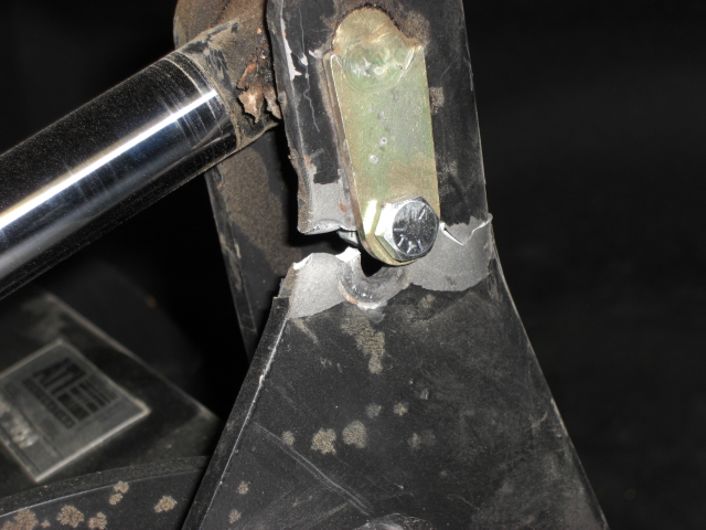

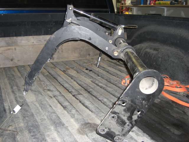

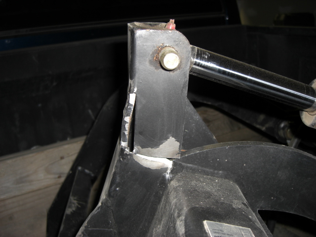

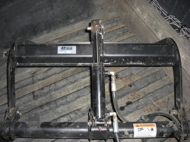

The darn thing broke on me today! The steel broke at the top mount for the cylinder. I was hardly using the grapple. I had cut some small young fur trees down (about 4-5" in diameter) and then back raked with the grapple. The root popped right up without any hesitation but the grapple broke. I can't believe how cheaply made it is.
I'm not sure if it was caused by the back raking or maybe the hydraulics were too strong for the unit when I closed it on the brush or small stumps.
My buddy said it looked like "pot steel," which he explained was a poor grade of cast steel.
I guess on Monday I'll take it back and see if they warranty it. I have about 2 hours on this grapple.
I took it off my loader bucket and it's in the back of my truck. I took some pictures for you to look at.

Hi Craig. I think I see a bow in the tube frame that stretches across the bucket as well. The whole thing is underbuilt for the forces that it can reasonably be expected to undergo in use. Its probably just adequate to withstand the force of the cylinder at relief pressure. When you backdrag tho, the relief valve is not in play since the valve is centered and isolates the cyl ports. Pressure just builds until something gives. This something should be the root, or if not, your traction.
If you get another like it you will have to get it reinforced promptly. That brace that cracked needs to be duplicated on the other side. The hole used to secure the pin is a weak point and will have to be addressed. Also the tube - if the one on yours has bowed, as it looks in the picture.
Good luck.
larry

Sorry about your grapple. Seems like definitely a problem with quality/construction. The dealer should either replace it or return your money.

I'm not sure why it looks like the cross tube is bent. It came out that way in the photograph for some reason. As far as I can tell, its not bent.
