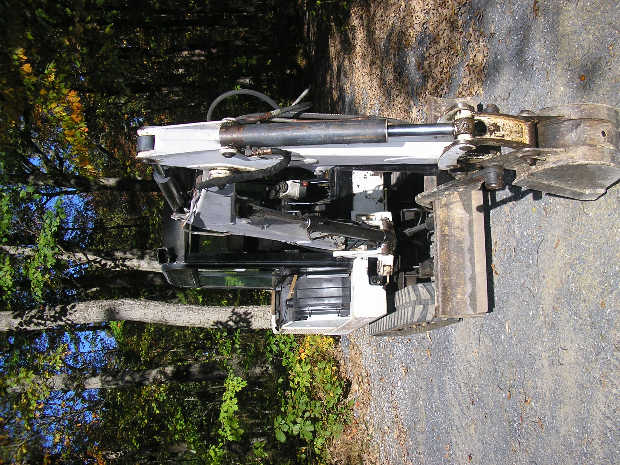

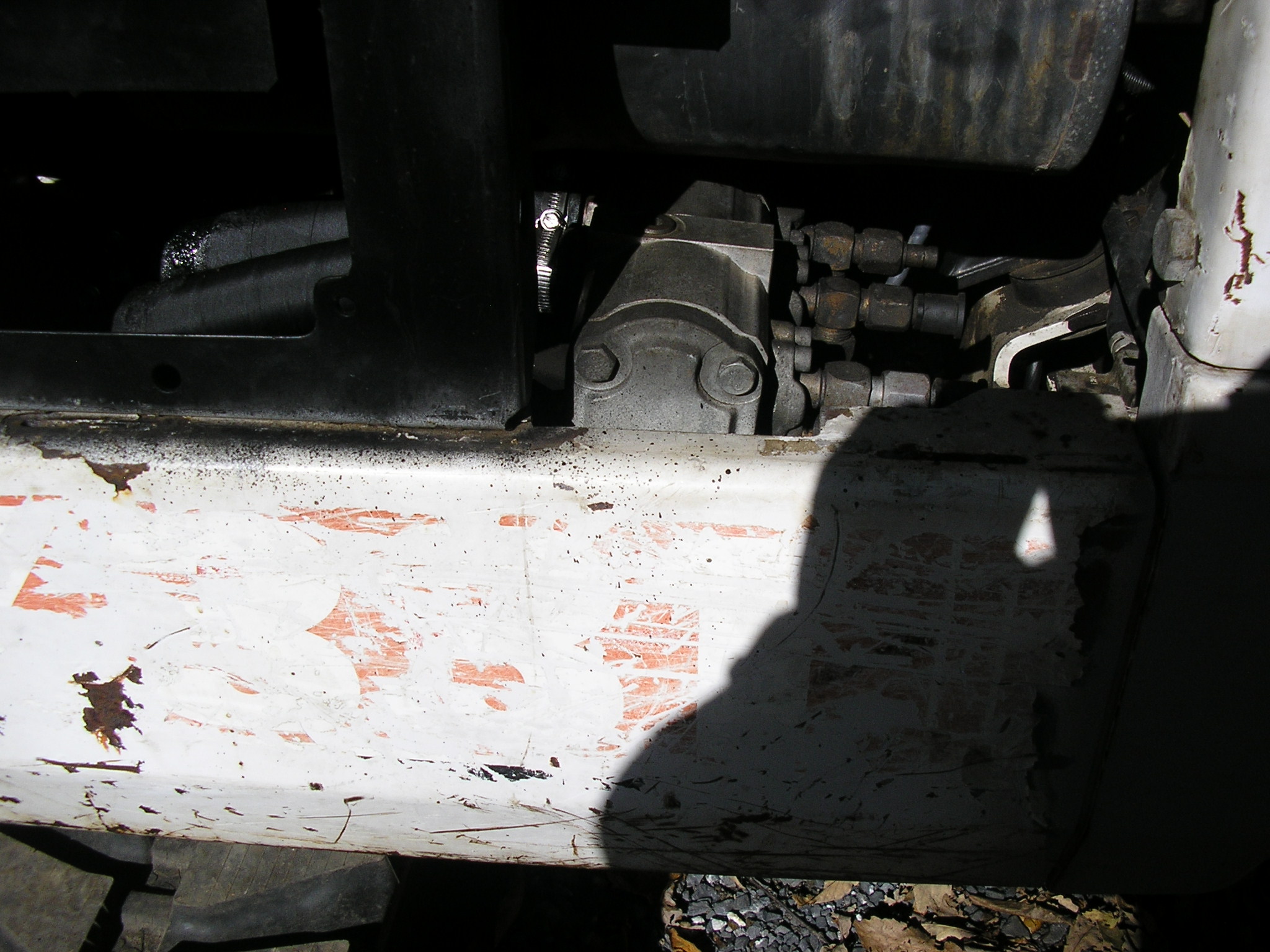

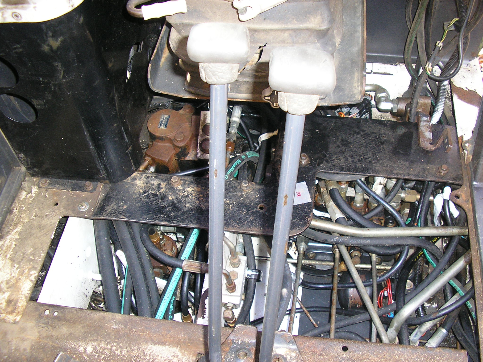

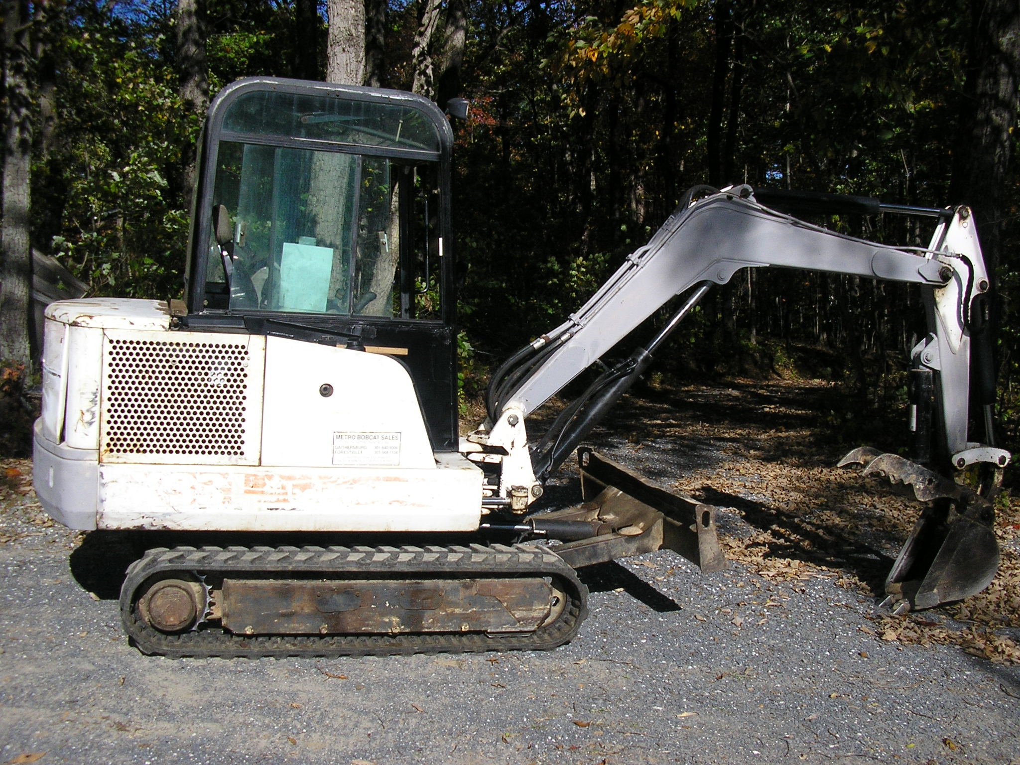

Mechanic is incorrect. All Bobcat mini-X models 320 through 337 were built in Bismark, ND. If you post some photos of the machine I may be able to narrow it down to a serial number range. Would need photos of front, rear, both left and right side views, photo of guage panel, and photos of engine and hydraulic pump. If you can read the engine model number all the better since a few of the seven 331 variations included and engine change.

The pictures are no problem, but I'm not sure how to upload them to TBN. If you can email me at Solar_OakatYahoodotcom, I'd be glad to send you any picture you need. I really need to find that number, so some repairs can be made. Thanks.

SSdoxie, I've got pictures. Now, if someone would tell me how to get them on TBN. Any chance you could send me the list of changes and the serial number breaks? Or, a website where I can find them. I might be able to figure it out for myself.
