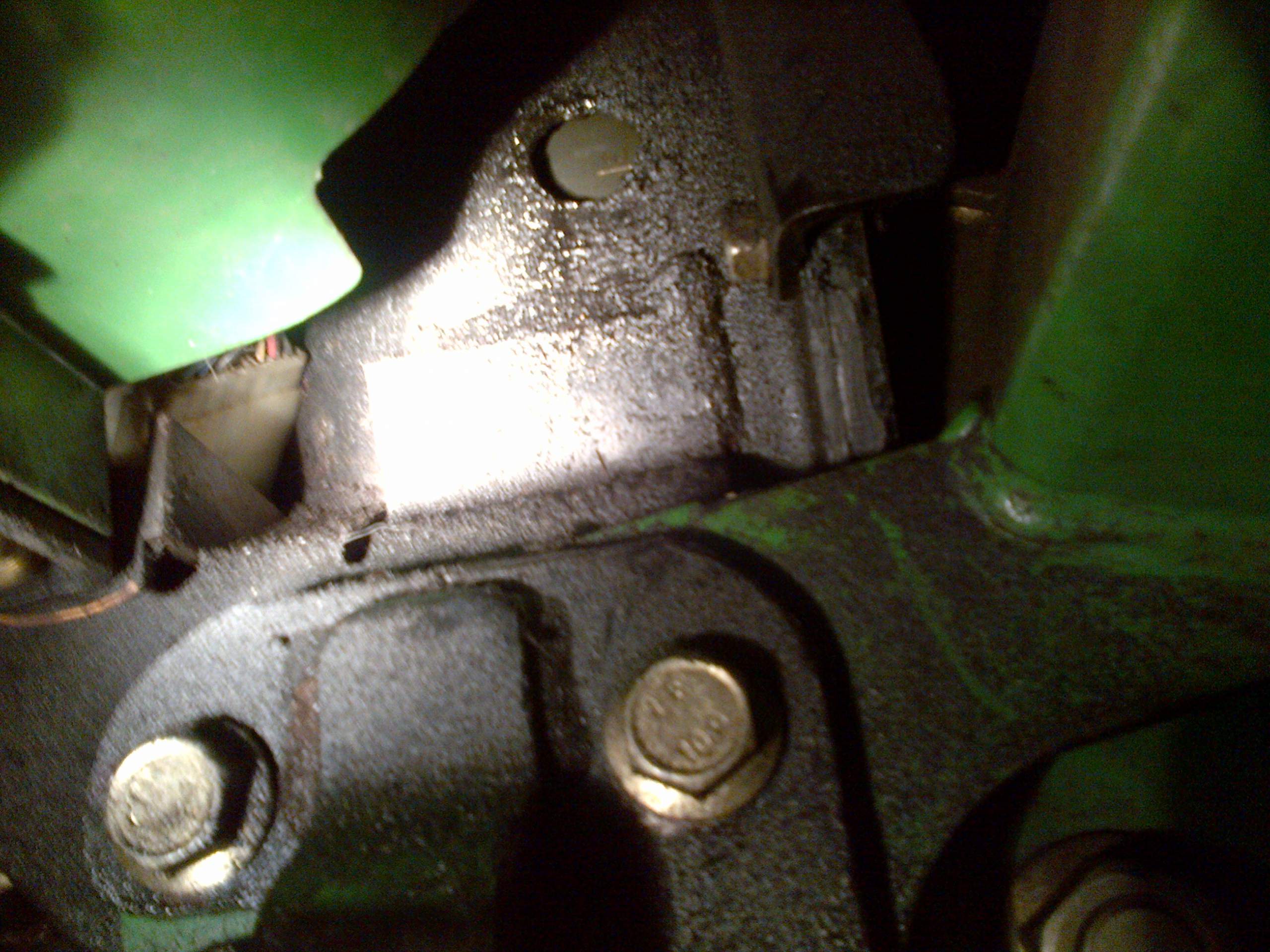

John Deere 410
Hey everyone...newbie owner of a 2000 Deere 410. As I was changing the oil, I notice I could see the inside of what I think is the transmission case. If the tractor is running, I can see it spinning. I'm thinking there should be a plug or something here and not open. Can anyone help? If you have a part #, that would be great.
Thanks in advance.

I can't get a real good perspective of what I am looking at but I bet it is a drain hole and is not meant to be plugged.

I don't think it's a drain hole due to it's location. I thought it was the clutch housing.

I'll take a better look tonight and snap some more pics. I can't imagine those internal components should in contact with dirt and grime.

Maybe it's the engine flywheel timing hole????????

I think you might be right....right next to the engine. But should it be exposed?

So it's definitely that part I linked to above. The inside part that spins when the tractor is running has the #3 on it. I'm thinking a cap similar to 15 on that parts list might be the one though I cannot see on the other side of the housing in that pic....hmmm

The hole I'm talking about is on the other side of the case and isn't even shown in the diagram. I took the plug out of 15 and it fits perfect so I may just order one of those. Plug #15 is for the flywheel. Anyone know what the hole on the other side is for?
