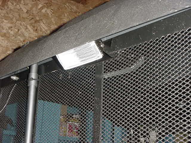

If so you may want to look at the Warn trail lights. They're sold as either a pair (for the front of an ATV or single (sold as a backup light). I've used these on my ATVs. They hold up nicely and are definitely bright enough.
I put a pair on my RTV (one pointing into the box, the other into the cab area) They fit nicely under the roof panel, mounted to the top center bolt where the cage mounts to the ROPS. (see attached pic).

That's exactly what I'm looking for. I need some light for backing up in the woods after dark and such. Where is the swith for the one that you have shining to the rear? Are they pretty bright? Thanks for the info. Glenn

Yea, I'd say they're pretty bright for a 35w bulb. The way I have it mounted (way up on top), you can't tilt up so it shines way out the back (it hits the roof). It really lights up the cargo area but I honestly don't recall if (or how far) it shines behind the RTV. If you don't use the existing hole in the cage (where it mounts to the ROPS), you could drill a new hole and mount it a little lower and then be able to tilt more horizontal.
If you got a pair, you could put one up high (where I have) and the other under the back of the box so you could see the hitch area and behind you better.
My switch is mounted to a panel that's under the roof. Here's a link.
http://www.tractorbynet.com/forumfiles/463654-Kubota%204.jpg
The switch that comes with these lights doesn't have a very long shaft to mount through thicker material.
Brian
