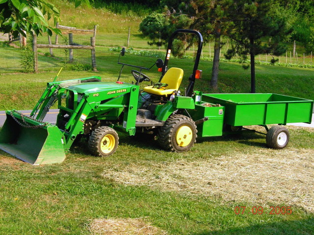

Hope this photo might help. On the 2210 & 2305 there are 4 bolts down below the dash. The upright attach to the 4 bolts 2 on each side and then he top bar is holding the mirrors.
This frame work goes to the Original Tractor Cab I use in the winter months.
So I just leave this part of the frame on yr around and mount my mirrors on , like someone was saying helps to see if someone is behind you when backing plus while going down the road mowing or pushing snow they do help.

Thanks! That's pretty neat! Do the mirrors vibrate much?
Barney
   / Mirrors for a tractor without a cab? #23
Very little vibration. The pipe (frame work) is out of 1/2 or 5/8" thick wall .
welded together and then the 4 tabs to bolt on to the lower part of your dash.
When winter is over I leave the part you see on the tractor Sometimes I use it instead of steering wheel to pull myself up on the tractor.
